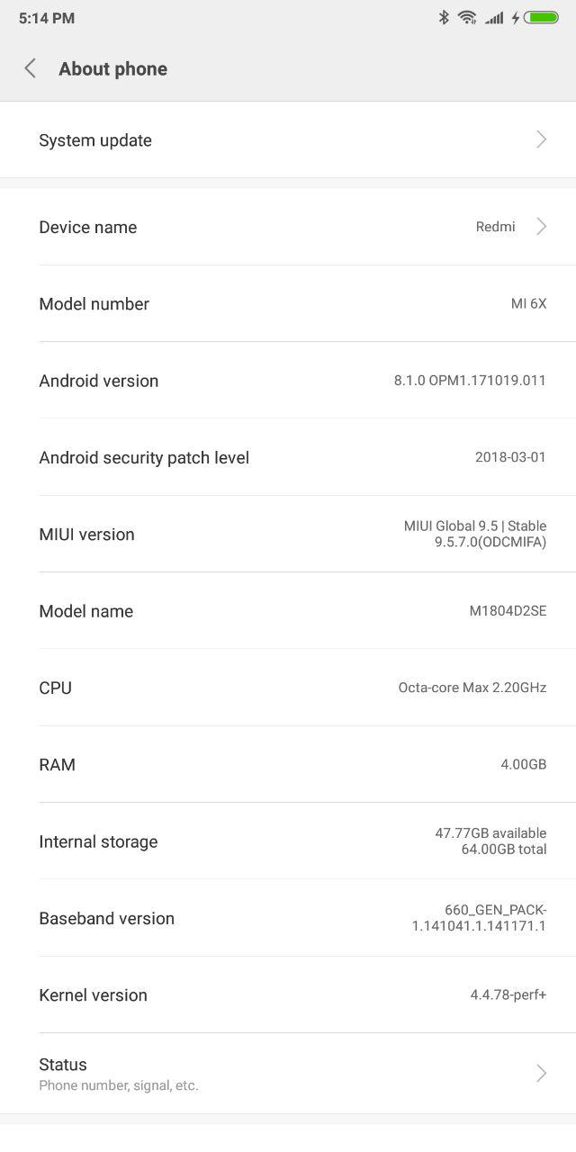

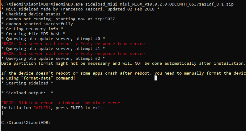

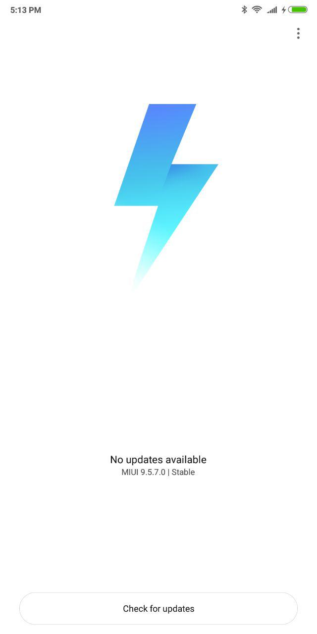

Hi, my xiaomi mi 6x came with a xiaomi version 9.5.7.0 stable, is around two months that i've been trying different ways to take it to stable china rom, to be able to unlock the boot loader with no luck.
I've been using xiaomiMiTool and Mi Pc Suite, also mi flash tool, but the only one that looks like is doing something is my suite pc that get the 50% only of the new rom.
I've no idea of how i can change the rom or is any other tool that i can use to change the rom to a stable.
Is anyone that knows how to fix it?
Thanks a lot!

Thanks for the tip, I did try that already with no luck.

The only difference when I did it is that I used a miui v9 rom. It was the latest at the time, v9. 5.17 I think
I'll try to again looking for other minor version than 10, maybe it'll work. Thanks.

he told you. Get a ROM from MIUI v9 for your device and repeat the procedure.
And I did, with the same results. No working. The bootloader is lock and I cant skip that to change the rom to an earlier version.
