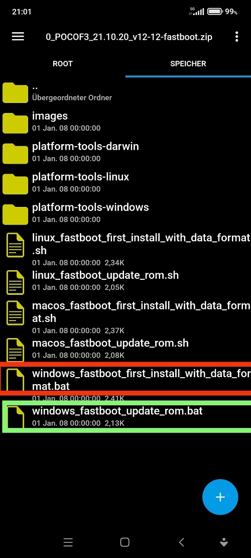

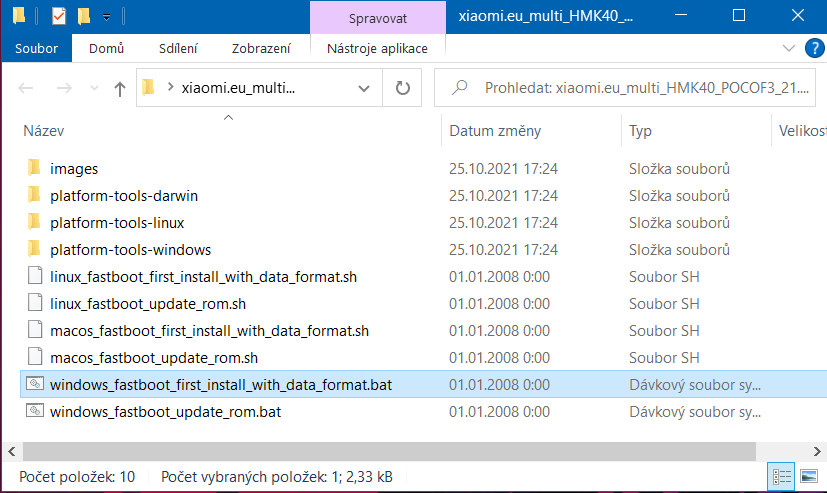

You need to do a clean install in fastboot
- unzip fastoot ROM
- connect the phone to the PC in fastboot mode
- in the expanded ROM click on windows_fastboot_first_install_with_data_format.bat if you are using win OS on PC.
- wait until the phone restarts into the system
- unzip fastoot ROM

If TWRP is not compatible by then, the procedure will be the same, just use the update script. windows_fastboot_update_rom.bat. The data will be retained.
Reactions: LikMaw and Poney70

„Because TWRP doesn't work with Android 12, the update needs to be flashed in Fastboot mode. Download the ZIP package, unpack it and run update script (without formatting data if you're moving from Android 11 xiaomi.eu ROM or with format data if you're flashing it first time)."
