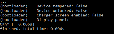

I'm facing a problem while trying to update to the latest weekly! Currently I'm running xiaomi.eu MIUI 7.3.30 on my Redmi 3 Pro (ido) and I wanted to update to 7.5.11.
Unfortnately, I can't access the recovery so I am not able to update! Everytime I try to boot into recovery the system reboots normally instead getting to TWRP.
I tried to re-flash TWRP via fastboot but it didn't work.

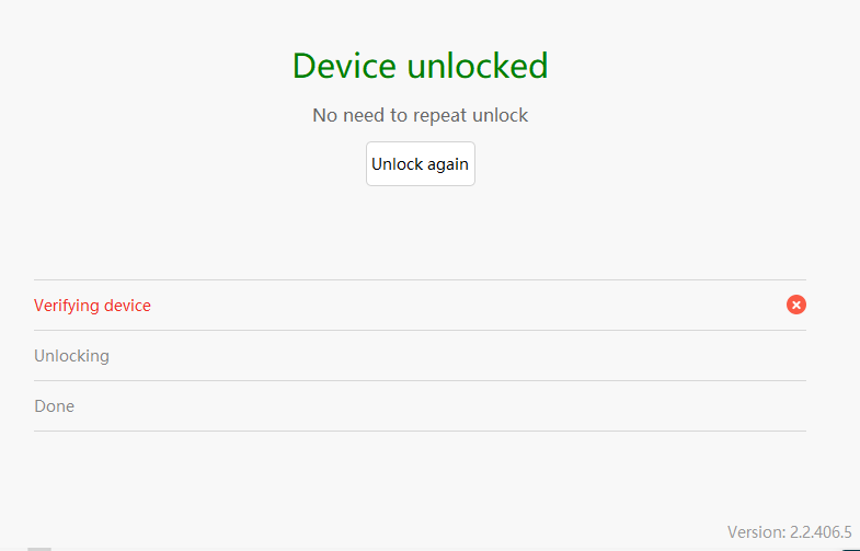

After a quick research I checked my device-status which says my phone's bootloader is locked. I, therefore, tried to unlock the device via Mi Unlock Tool but that didn't work either because for the tool my phone is already unlocked.
I've never faced such issues while updating my phone and I do not know how to get access to the recovery again.
Has anyone an idea how to regain access to the recovery again?
Thanks in advance!
If you get that error on the latest version of MI Unlocker, try reinstalling the drivers.
That worked for me at least :-/
