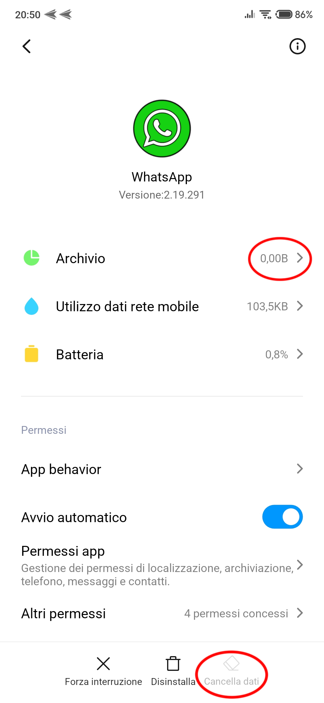

yesterday i installed the xiaomi.eu rom (20.3.12 beta) on my Mi9T Pro
I followed these instructions:
TWRP Recovery Zip DOWNLOAD or TWRP.ME
  • Reboot in twrp
  • Copy ROM to the internal storage
  • Install ROM
  • Wipe dalvik and cache
  • Reboot
  • done
The ROM boot well, but i can't "clear data" of any app, the clear data button is greyed out.
Today, i updated to 20.3.19 beta,
changed also twrp, Wipe dalvik cache, cache and reboot .... but i not solved problem.
Please help me !!!

At the end, i had to format data again :(
1) update recovery to the latest "twrp-3.3.1-32-raphael-raphaelin-mauronofrio.img"
2) format data
3) reboot to recovery
4) flash rom
5) flash "Disable_Dm-Verity_ForceEncrypt_01.15.2020.zip"
6) reboot to ROM
This rom has serious problems with encryption ⚠⚠⚠
