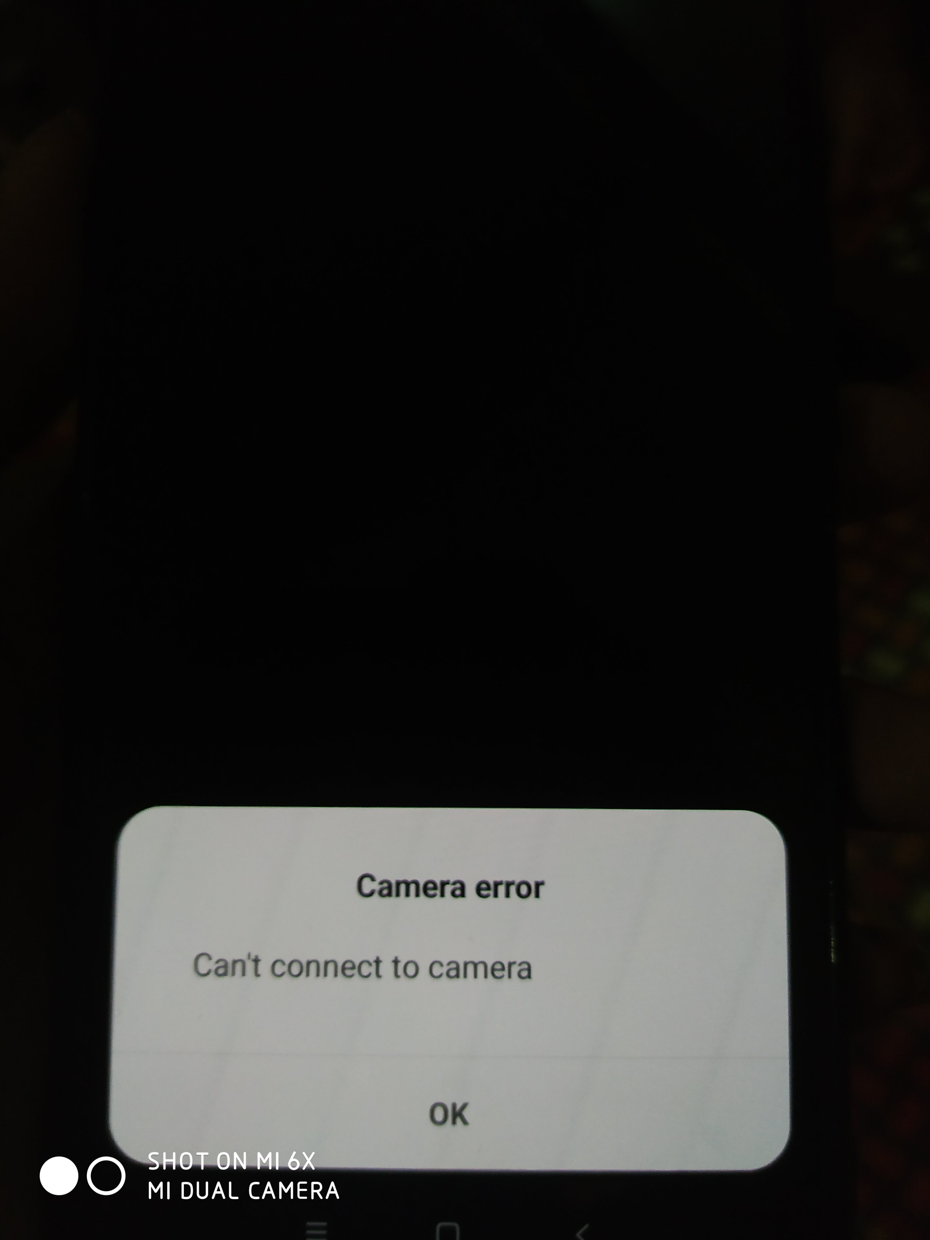

my problem is most of my sensor on mi 8 is dead,and im trying to flashing persist.img to make my sensor back normally even when twrp said succes flashing persist.img ,after i booting into system no sensor is back to normal. can u help me? sorry for my bad englishcan u explain your problem ?
is that work on any miui 8 rom or just for global stable?
im already read that threads,but its doesnt work for me. im also tried modified fastboot rom and tried flashing persist with fastboot,but xiaomi cant give me permission to flashing persist in edl modeand you can check this topic 2, i wish it will be back again
