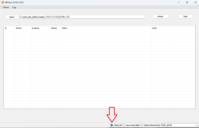

Indonesian ROM is a derivative of Global ROM for Indonesia.
It contains Google utilities and language selection like Goobal or EEA ROM. It uses MIUI Dialer with call recording.
The ideal installation is to use Miflash using the script: clean all - flash_all.bat
(It resets the entire phone, including the storage!)
If you are satisfied with the ROM, you can lock the bootloader fastboot with the command:
Code:
fastboot oem lock

I have a global version Poco F5 and want to flash the official EEA (EU) ROM. I get the process of unlocking the bootloader, then flashing the EEA ROM, but wanted to check if I select "clean and lock" in MiFlash, that will re-lock the phone but leave the EEA ROM on it, so I'll have the EEA ROM and banking apps/GPay and the like will still work?
Sorry to bring you back to an old thread, just wanted to clarify something.
yes
