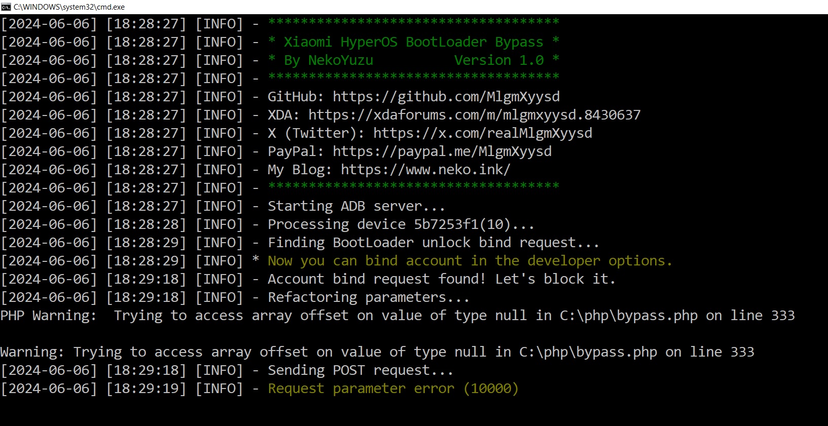

Only code 30001 cannot be bypassed.
You have a PHP configuration error, all folders must be in the same place.
Don't ask me for more help on PHP, I don't know enough.

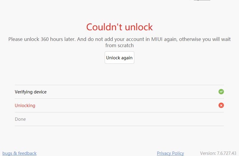

Hell, no !!!
Why did Xiaomi this ? I think will be my last phone from this company :(
Just wait for the time to display and then it's good.
It is the Chinese government which has restricted the unlocking of the bootloader for CN devices and not only for Xiaomi.
360 hours in a lifetime is nothing.;)

If you have the same error, you have the answer one post above and after that, you need to wait. In my case it is 360h.

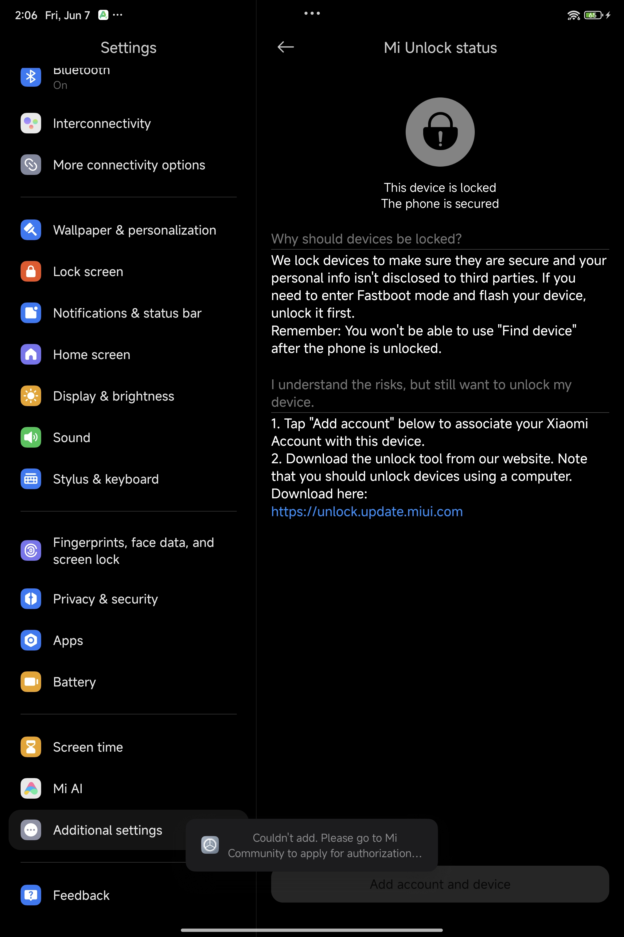

I'm trying to unlock the bootloader in Pad 6S Pro, but I can't...
i may found a solution here.
Download this
its the settings apk grabbed from the Xiaomi Pad 6.
Install and try again
Reactions: Grigori

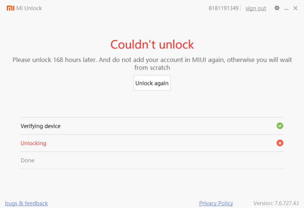

"This worked and I got a 168h timer for my Pad 6S Pro. Thank you!"
"its work on my redmi turbo 3, and checked by unlock tools, showing waiting 168 hours!"
Both devices that dont have MIUI from when they came out
The Redmi Turbo 3 is an exception.
And indeed you have the delay which is displayed but you will have an error when finalizing.
