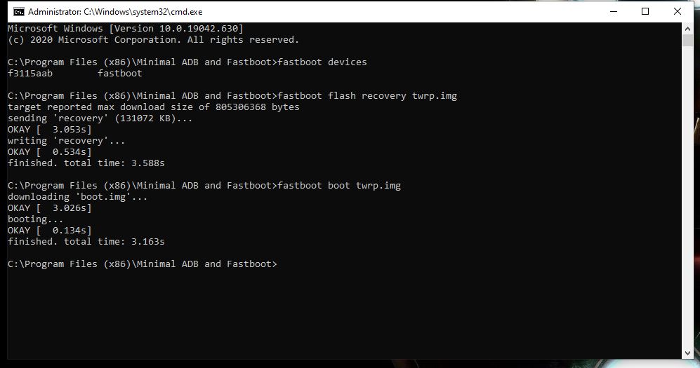

Hi I have tried this twrp but still the same. After installing it after reboot stuck on MIUI screen. Could it be because i'm using the latest MIUI and android 10?
No. That twrp works with android 10.
1st boot usually takes a while, how long did you wait?
Problem is not from your twrp, you installed twrp correctly. Did you format data before installing rom?
I couldn't even install any ROM as I cant go to TWRP recovery mode just stuck at MIUI screen. Also my mi 9 pro 5g is already unlocked and enabled USB debugging. I have tried booting holding volume up+ power button but goes to MU recovery.Thank you for your reply.

done the instructions but will go to MI-Recovery 3.0 :(

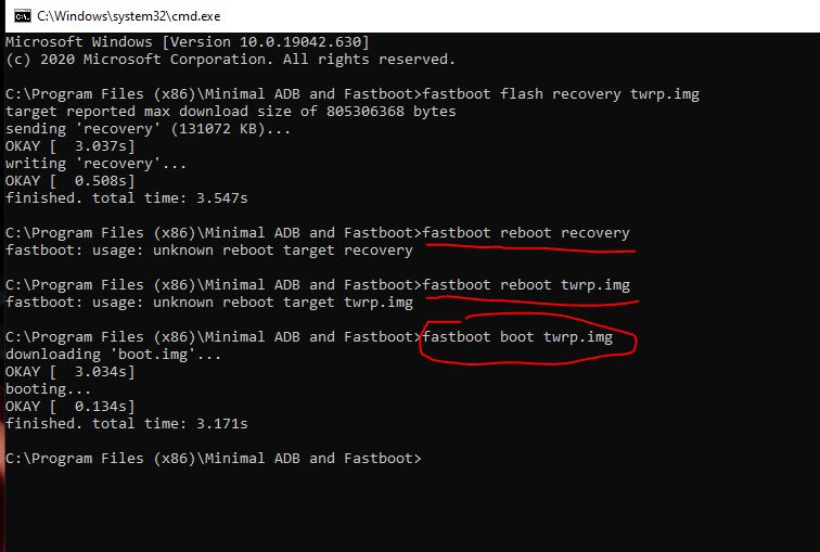

Thanks so much for taking time to make this guide. Unfortunately still stuck on MIUI screen after flashing twrp. after the command "fastboot boot twrp.img" i I'm still waiting now to pop up in recovery mode but at the moment still at MIUI screen logo. "fastboot reboot recovery" will not work as per attached photo.
Updated step 4 in section TWRP FLASHING & ROM INSTALLATION.
Since you are in MIUI screen, start from step 1 in section TWRP FLASHING & ROM INSTALLATION.
It should work now
Do not use "fastboot boot twrp.img"
It should work now
