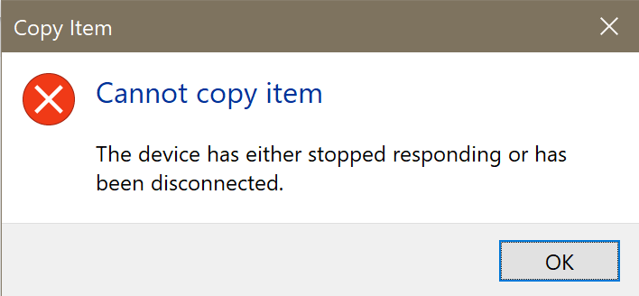

Help Error Twrp
when I try to copy the rom I get the message "cannot copy item"

Tried this, but keep getting the same error. Cannot copy item
I tried adding a folder, that worked.
But copying a file doesn't
Tried copying another file to another directory...that worked
seems that it is blocking copying .zip files
renamed into .txt
was able to copy
renamed into .zip
this worked
