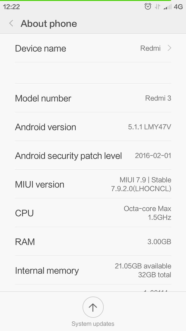

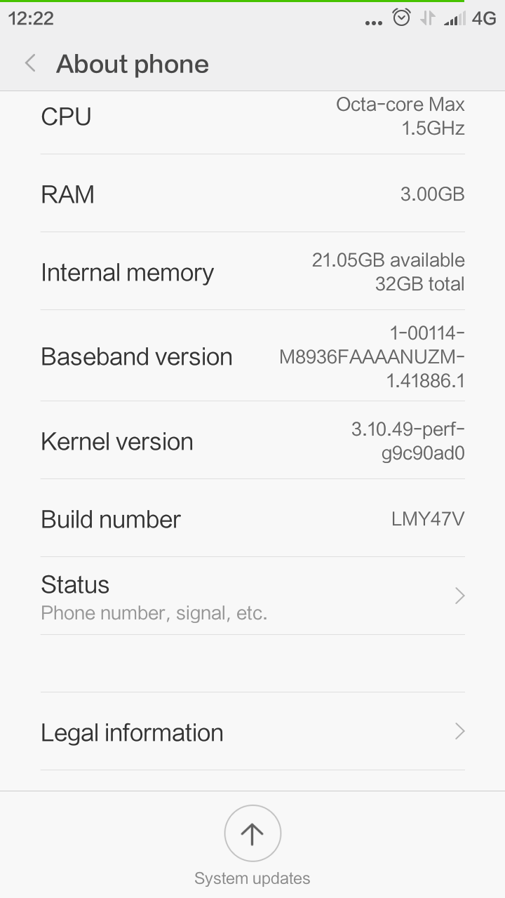

Well. You probably have installed a vendor rom. I suggest you find out first which ROM is installed (android settings --> about device) if your bootloader is locked (i didnt try this myself: http://xiaomitips.com/guide/how-to-check-if-redmi-note-3-bootloader-is-locked-or-unlocked/ (@mods: i hope outside links are allowed)

There is no way I could get in touch with last owner, because we had a big argue cause of this phone.
When I press the buttons you told me, it says fastboot mode.
I will try to see about the bootloader a little bit later.
