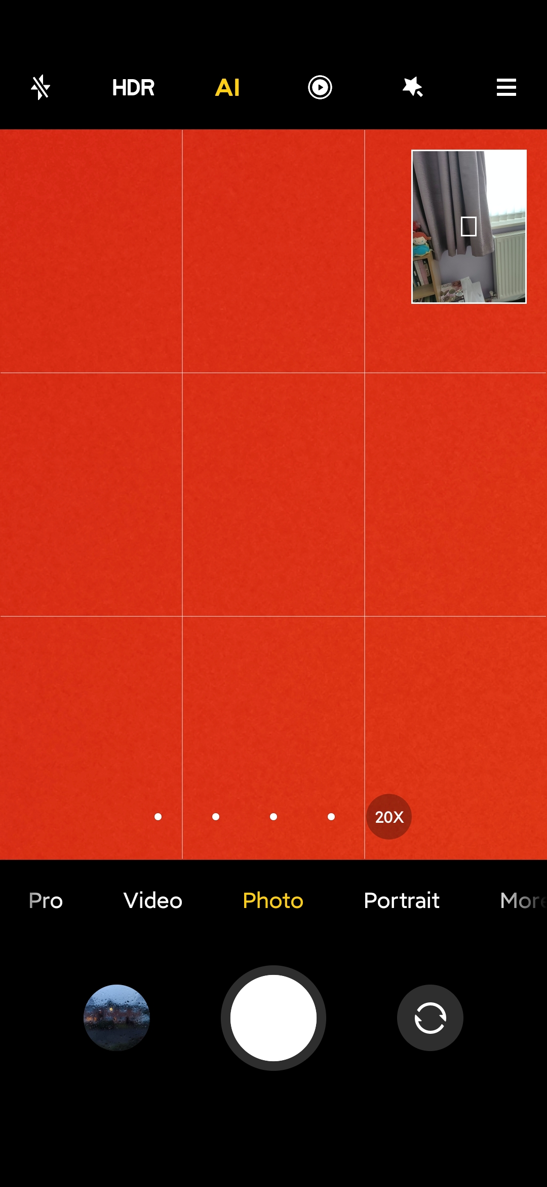

However, once it goes into 15x zoom and above, you see "picture within picture" and the viewfinder does seem to be powered by the periscope, and the main 3rd lens is then responsible for the mini image in the corner, please see my attached screenshot, where I have covered the periscope lens with my finger.

Hi the periscope lens is used when there is sufficient light because it use a lower aperture (f/4.0 if I remember correctly) instead of the main lens who use a f/1.8 aperture. The 0.8x toggle is the same as the macro toggle.
