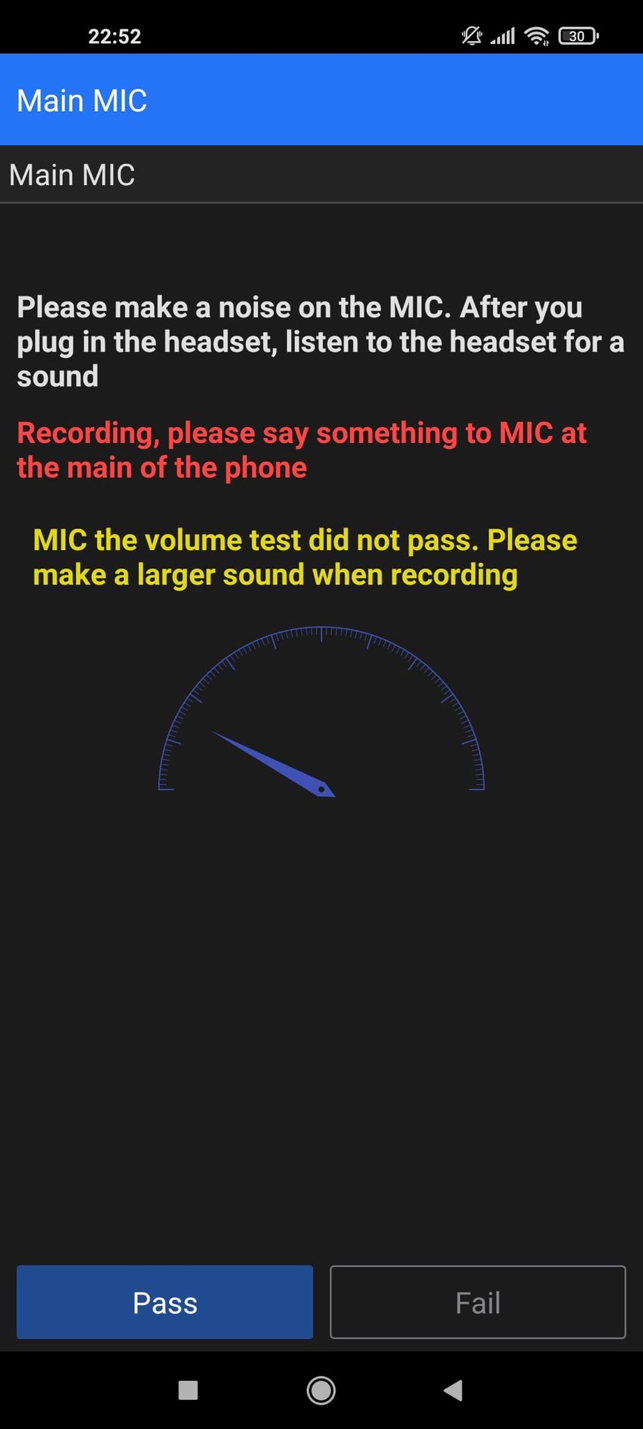

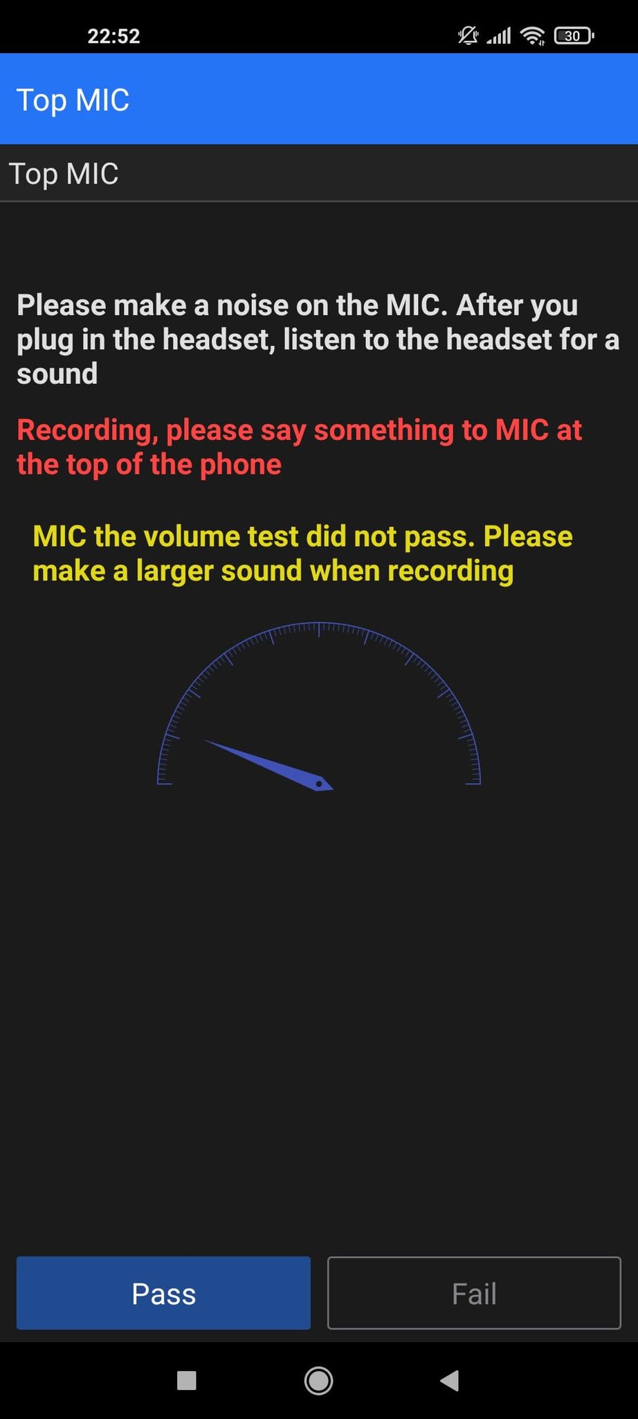

I entered CIT (in kernel) to check on the mic, and guess what. Both top and main mic failed test. Sensor barely moved while I was talking even my loud voice. If it wasn't for that voice recorder that proved it can work properly I would be sure its mic, and not software problem.
