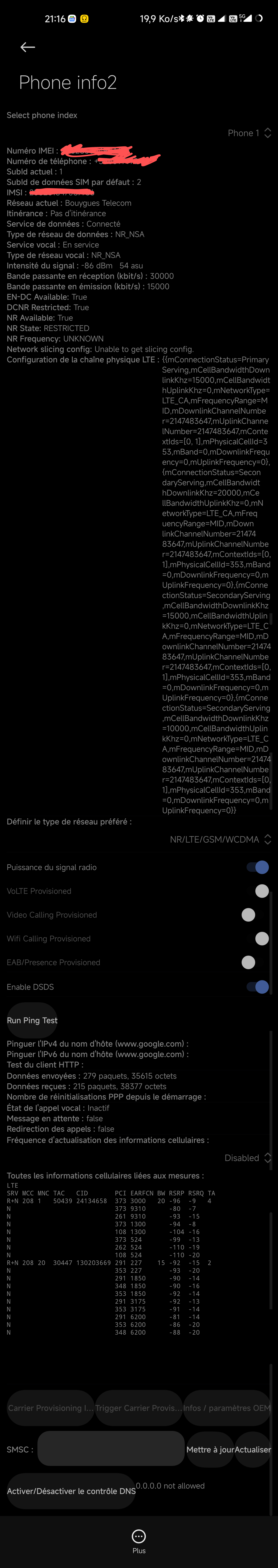

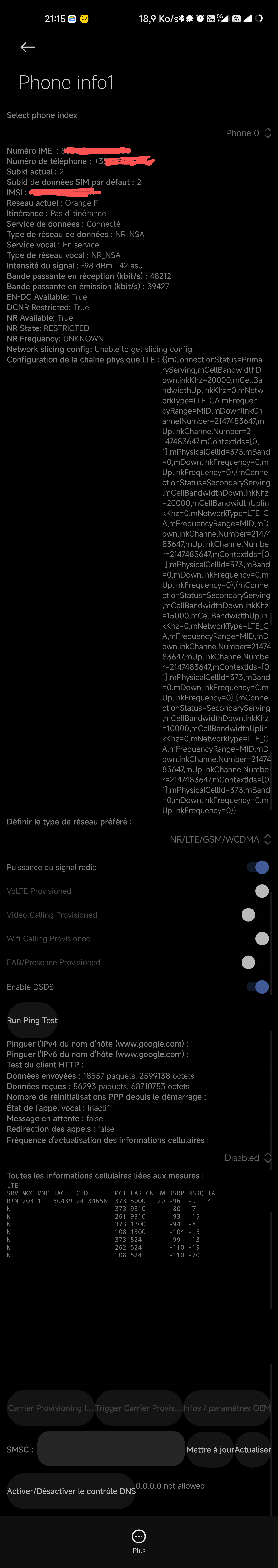

I have 5g icon on xiaomi.eu rombut I dont have 5g plan.
I have 2 sim card 2 french provider 3G, 4G 4G+ plan : Bouygues Telecom and orange
I think xiaomi.eu ROM not detect corectly 5g plan

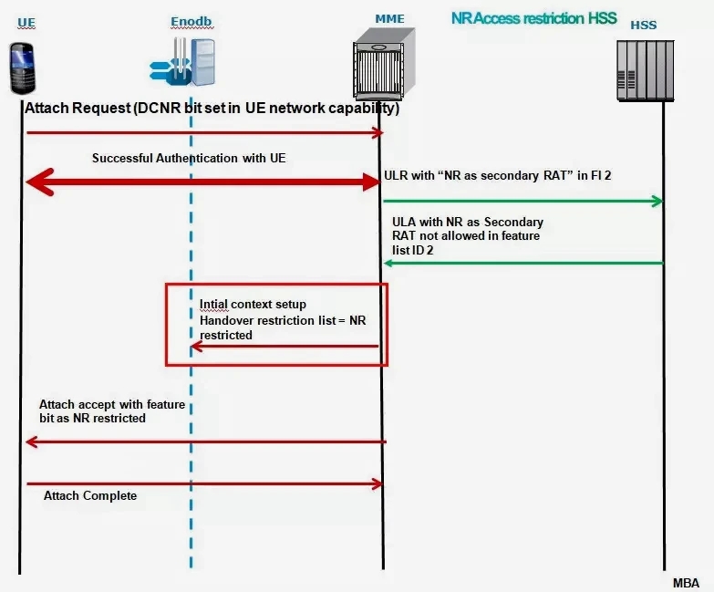

I'm connect to 5g network but "nr_state" is Retricted = no 5g plan (see screenshoot)

It happens because Cellular Providers can use existing 4G+ infrastructure and upgrade it a little bit so it's faster and therefore phone shows it as 5G. What you have is actually NR_NSA (Non-Standalone Architecture) - actually using the 4G+ infrastructure. If you did have true 5G you would see NR_SA there.
Explanation: NSA uses a 5G RAN, as well as a 4G LTE core, while SA is an end-to-end 5G network with both a 5G RAN and NR core.
Hope it helps!
