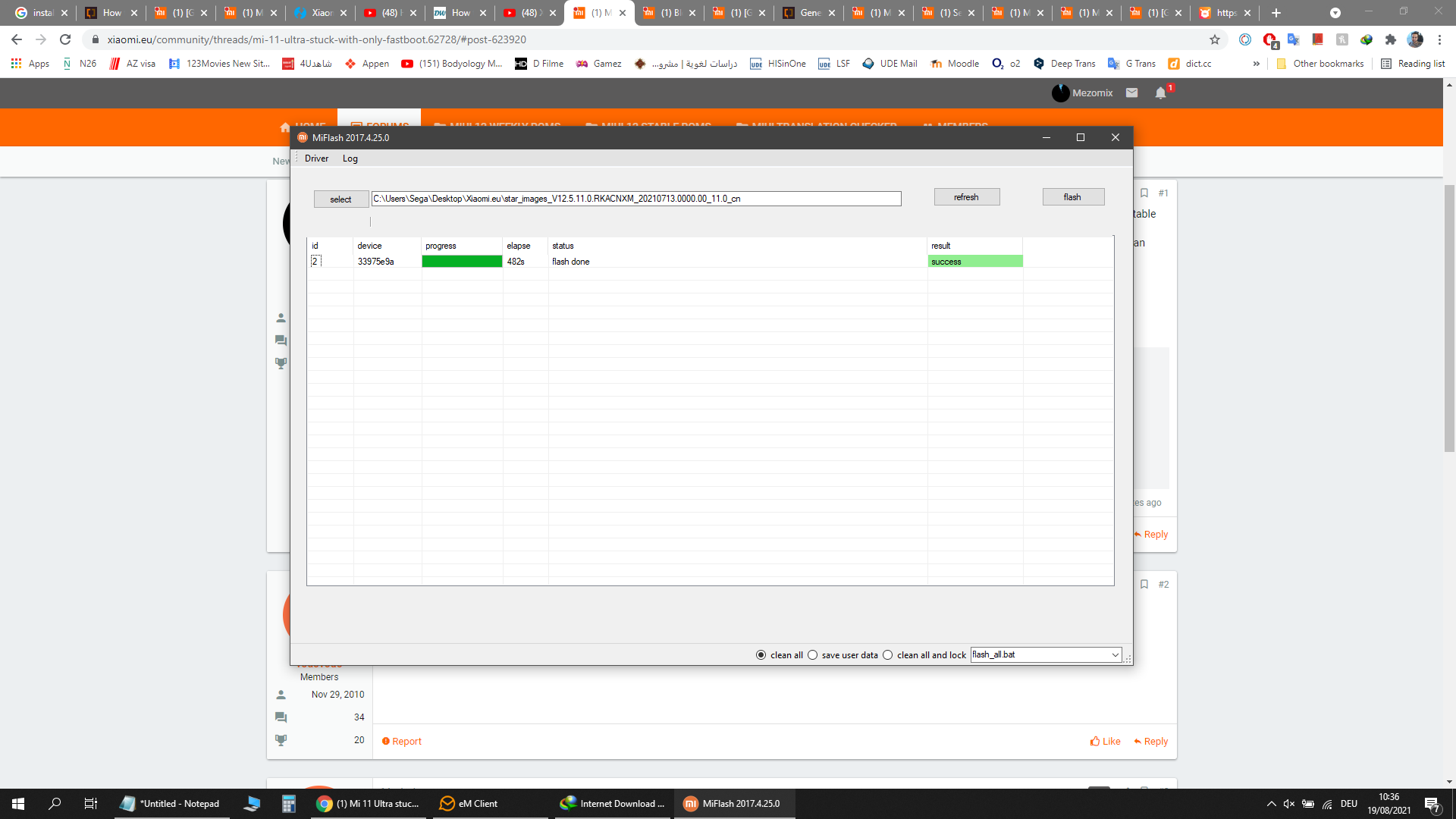

Hi good morning, I got the Mi 11 Ultra with Chinese ROM, I waited the 7 days and I unlocked the bootloader, I installed the TWRP and then tried to flash the Last stable Ver. of xiaomi.eu, afterward, I am stuck with only the fastboot menu.
I have tried to reinstall the TWRP but it does not work and gives me an error, I have tried to flash the original Chinese rom again by using MiFlash also it gives me an error at the end.
I have tried to unbrick it by using XiaoMiTool V2 with no success as well
I tried using xiaomi.eu fastboot rom, it does everything successfully but the devices reboot again in fastboot mode.
I have tried different cables, different ports, and two different laptops.
I made another try by using Mi flash, it gives me success in the end, but the phone is still stuck with Fastboot :(
Could you please help me, what else can I do?

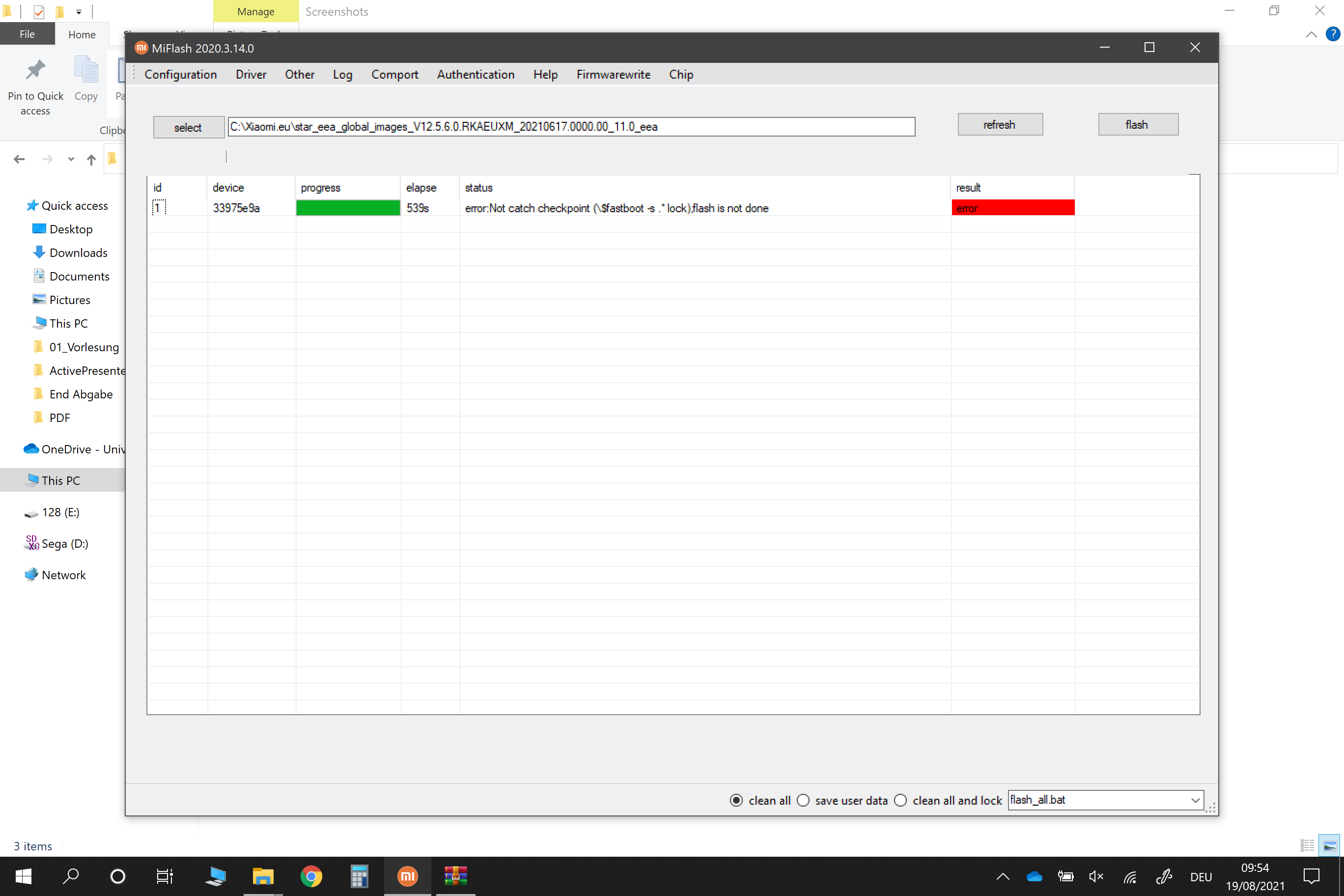

in miflash, go to configuration and remove the check point then press ok.
and i can see u r flashing global rom! flash the Chinese and make sure u tick clean all. not clean all and lock
let us know what happened
Reactions: Mezomix

I did not get any Configuration, the Chinese Rom says Success but the phone is still in Fastboot mode :(
and I ticked clean all

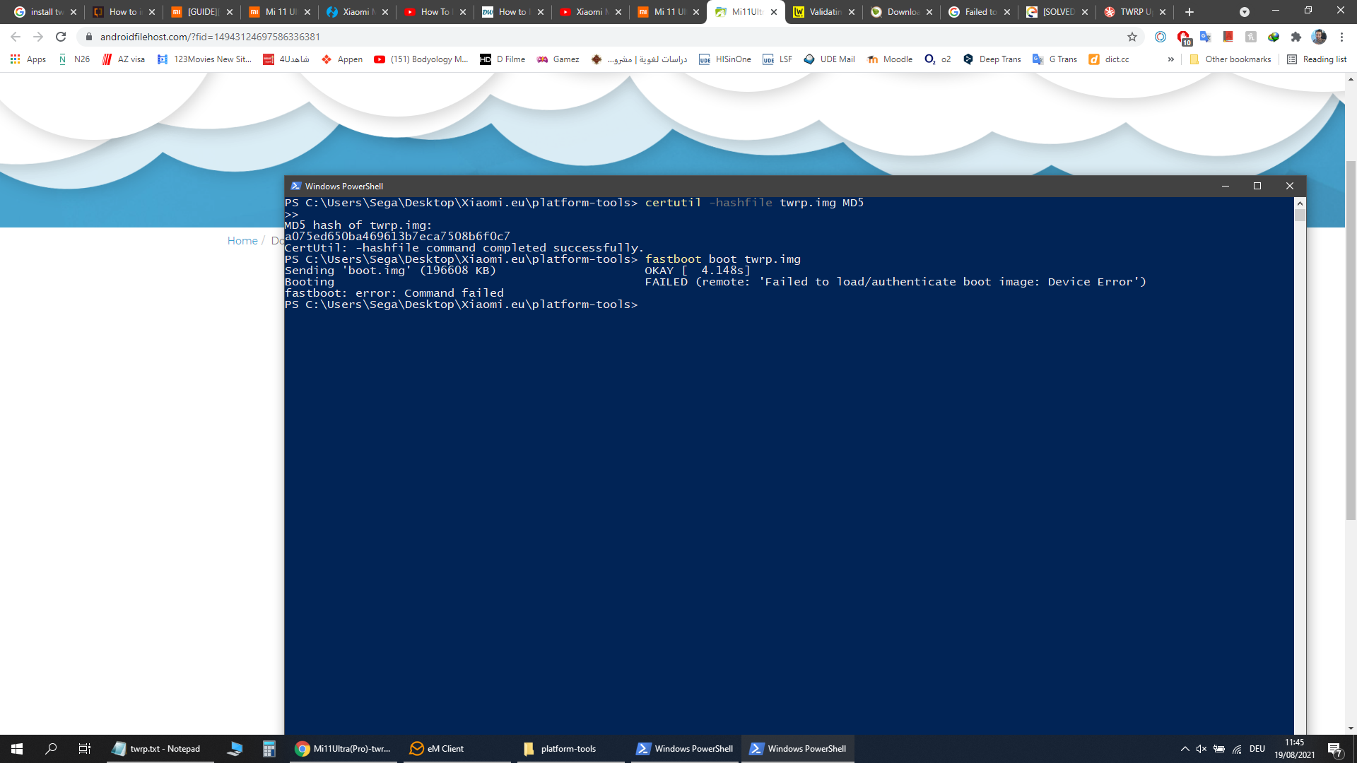

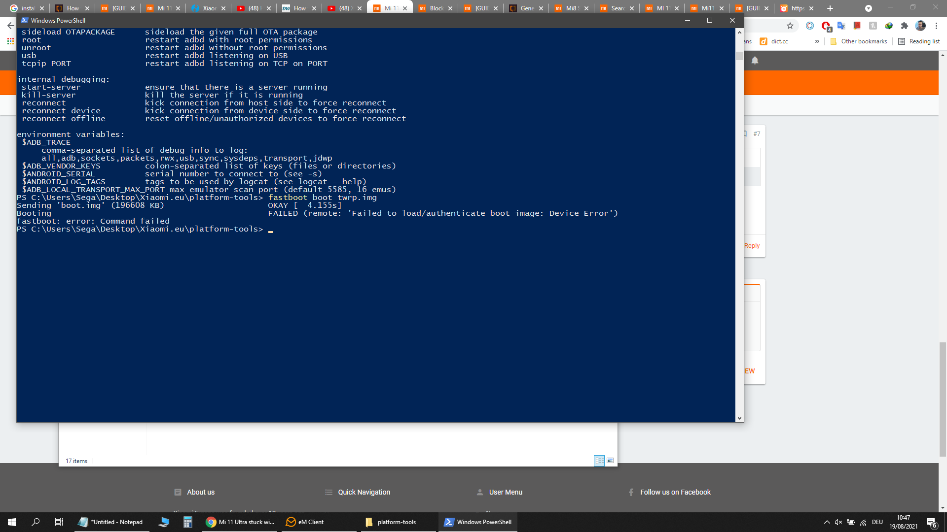

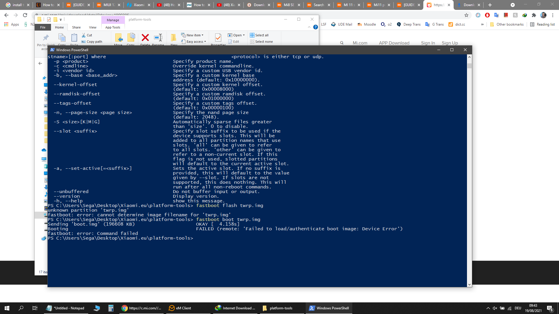

the problem is I am not able to flash TWRP
try to boot it in fastboot mode:
-fastboot boot "twrp".img.
"twrp" to be replaced by the file name...
then install your rom
it gives me an error as per attached screenshot

can you help with a trusted link for the TWRP, and what do you mean by MD5 ??
use the one mentioned here 1st post https://xiaomi.eu/community/threads...iaomi-eu-rom-for-xiaomi-mi11-pro-ultra.59486/
if you open the download link (https://androidfilehost.com/?fid=14943124697586336381), it'll show MD5 as
a075ed650ba469613b7eca7508b6f0c7.
you can check from your PC, what's the MD5 of your file, make sure it matches the one on the website. it's basically to make sure that you're downloading the correct file without any file corruption happening
one method to check https://www.lifewire.com/validate-md5-checksum-file-4037391
i personally install hashtab, so i can easily see md5 of any file from right click->properties
I did, it matches the MD5, and it gives me the same error

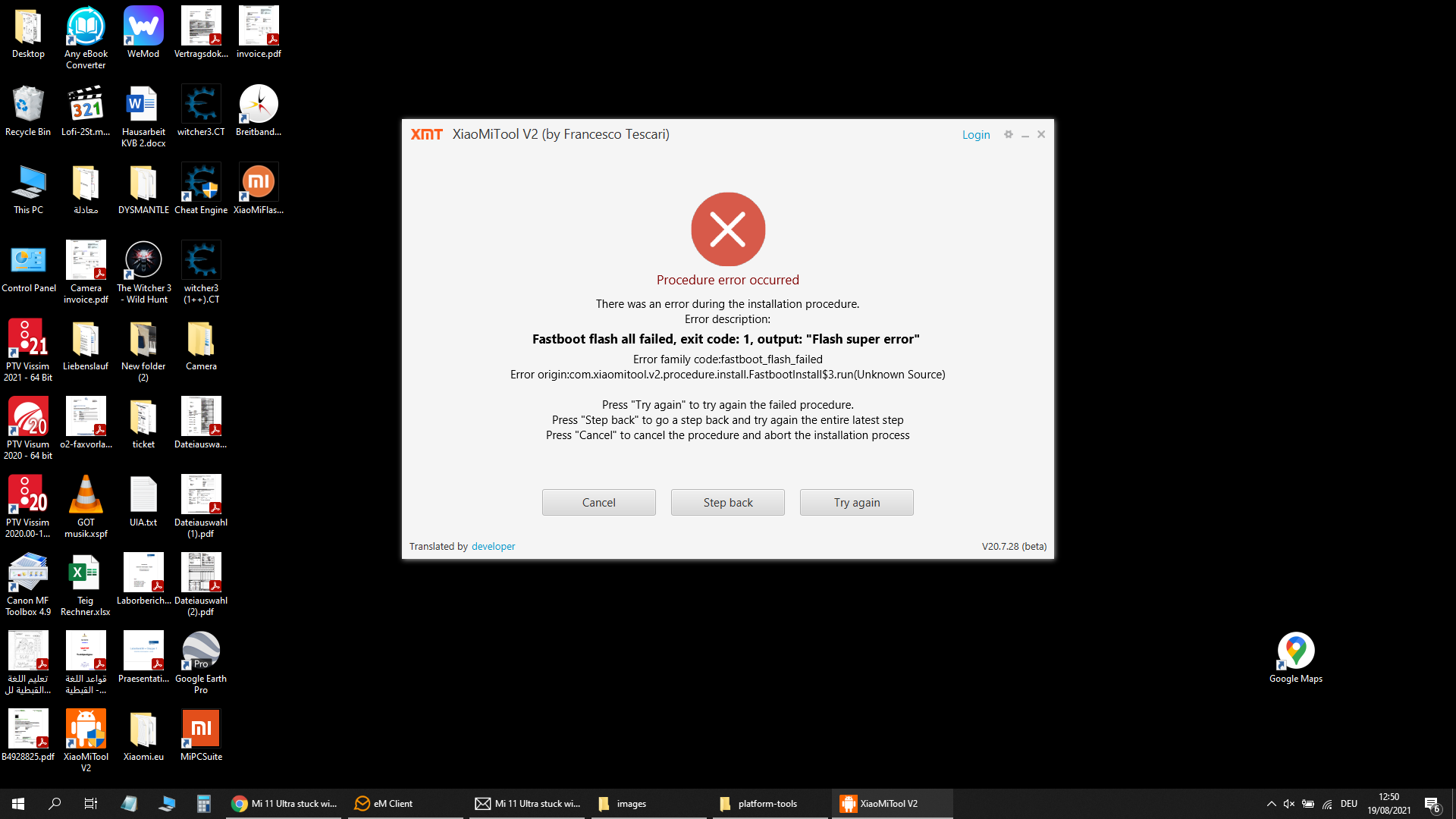

I tried one more time by using XiaoMiTool V2 and I got this message
Normal curing is fastboot official rom via MIFLASH.
That should be the first step for cleaning and starting from good foot.
