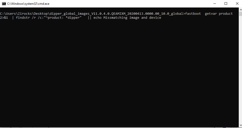

I don't exactly remember but I think I was using TWRP 3.3.0 or 3.3.1, I tried what you said and it gave me the message I attached.
If I understand the rom I used isn't for Mi8 ? Because , I tested "dipper_images_V11.0.7.0.QEACNXM" and "dipper_global_images_V11.0.4.0.QEAMIXM" and same message.
Edit : I tried to comment the 2 lines on flash_all.bat to avoid the error and now I have the "waiting for any device" line instead. I don't know if it's helpful :x

are you sure it is mi8 but not mi8 lite, mi8 pro, mi8 se, etc.?
from your image, you could try to run below command in command prompt
fastboot getvar product
it should tell you what is your phone model

Yes I have a Mi8 ( I verified the imei on xiaomi to be sure I didn't get a fake mi8 )
The command give me the message < waiting for any device > , the problem is that i'm stuck on EDL , I can't boot on fastboot :/
seems it is better send it back to customer service to flash the rom again in EDL (9008) mode then

As I mentioned on XDA:
You phone thinks that it is a different device, because you apparently flashed the wrong rom by accident. probably a mi8lite? Anyway, the good news is that after reading the flashall.bat file again, I tested removing a couple of lines that identifies the device before flashing and the script works without the getvar command. So follow the steps below and you should be back up and running soon.
In the batch file "flashall" script delete these lines below
fastboot $* getvar product 2>&1 | grep "^product: *dipper"
if [ $? -ne 0 ] ; then echo "Missmatching image and device"; exit 1; fi
After deleting those lines , save the file and then try the flashall process again.
This time it should work, and your phone will be restored.
