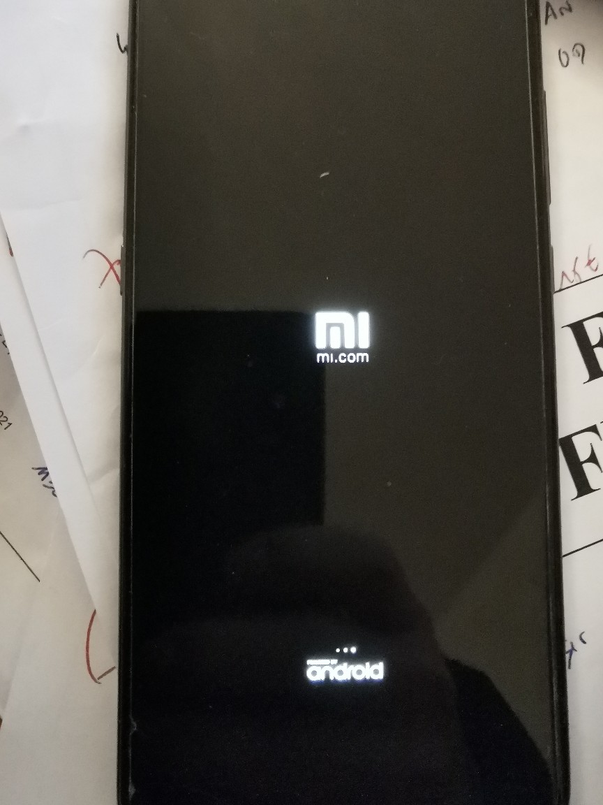

Hello i have problem with the mi9 of my friend
her phone seems to be block in boot process...we can see the Mi logo and the android power up with 3 points moving like if it is starting but nothing happens...
we let it starting for one complete night nothing has changed.
I can access to recovery mode pushing volume up + start button...i could do swap data but she doesn't want to loose some phone call records cause their is the voice of her last chat with her mum passed away some months ago...
for now what i know :
- her phone doesn't have the usb debugging options activated ;(
- when i connect the phone to my pc it doesn't recognized and appears on my pc
- i tried the miassitsant option in the recovery mode but mipcsuite doesn't see it too...
- not sure a mi account was created on her phone...she said she think we did one but the infos( id andpass was kept on a sms on her phone LOL)
so for now the only thing i see is that, in adb, when i typed .\adb devices i can see a number with "sideload" written beside it....does it help to find a way to modify the boot.img for an update or to transferts files from the phone to my pc?
question more : what is the path for phone calls recorded in a MI9? maybe i could use a push or pull option in adb?
i thought aboput contacting xiaomi for unlock the phone but as it seems to be blocked in boot mode i don't now if it would change something
i hope you understood well my poor english
please help ...

i tried to download files from devices but not sure of the path where the voice records are saved :
adb pull [-l] /internal share storage/MIUI/sound_recorder/call_rec/
adb pull [-l] /MIUI/sound_recorder/call_rec/
is the path correct?
