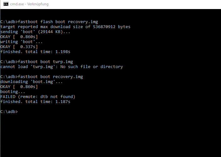

I am having problems flashing the new twrp (TWRP_leo7.0). I can flash it via fastboot flash recovery, but i can't enter recovery mode after that. If i use fastboot boot, i get an error (dtb not found). The old version works fine. Anyone having the same problem?
First of all install Mi Flash and after that try again to install via fastboot.
After that use the following in the same command prompt:. adb reboot recovery

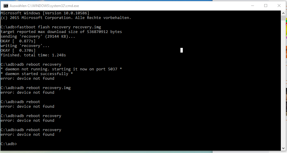

Hello together,
bought my mi note pro on gearbest and updated it to 7.0 dev from miui.
Thought there was the german language inside and chose that ROM.
Unfortunately there was no!!!!
I also unlocked my phone via the miui unlock site, after rebooting my system does not
have inet connection nor my papps are workin´, google can´t connect...
Also tried to fastboot flash recovery.img.... this is working.
When i try to reboot into recovery "daemon is not running"???
I really don´t know what to do any more to install the xiaomi.eu ROM.
Please help.

Got it, i was to fast in that procedure...
Didn´t get it read the post and then the
phone was in twrp screen...
Halleluja bit...!!!
