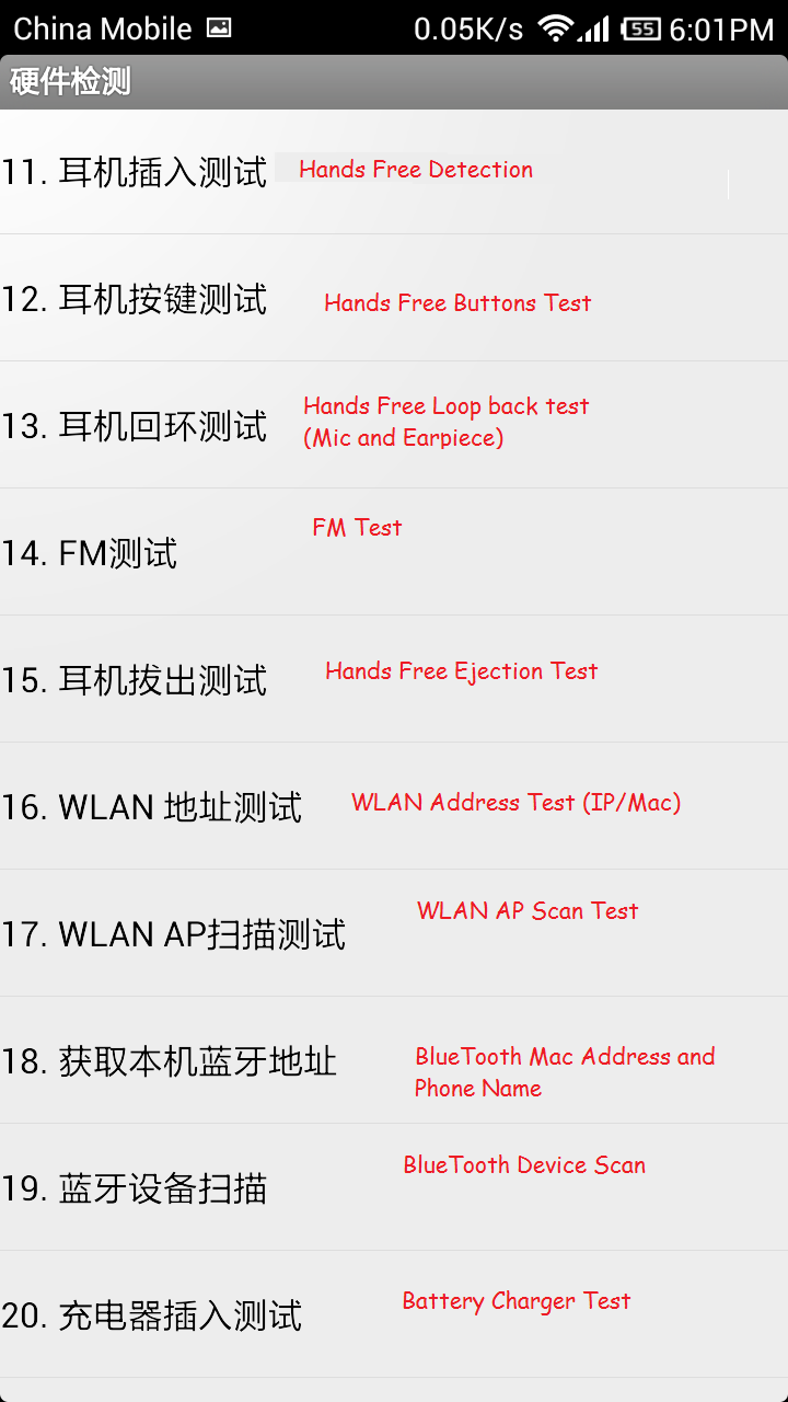

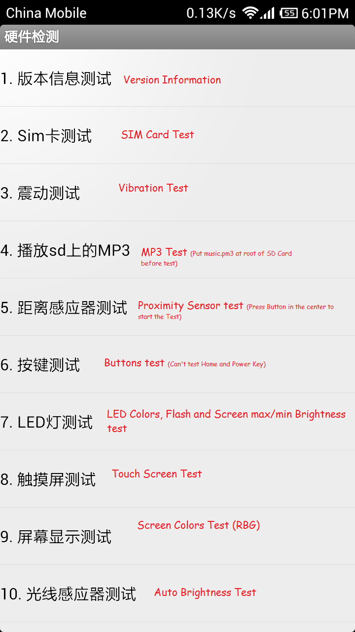

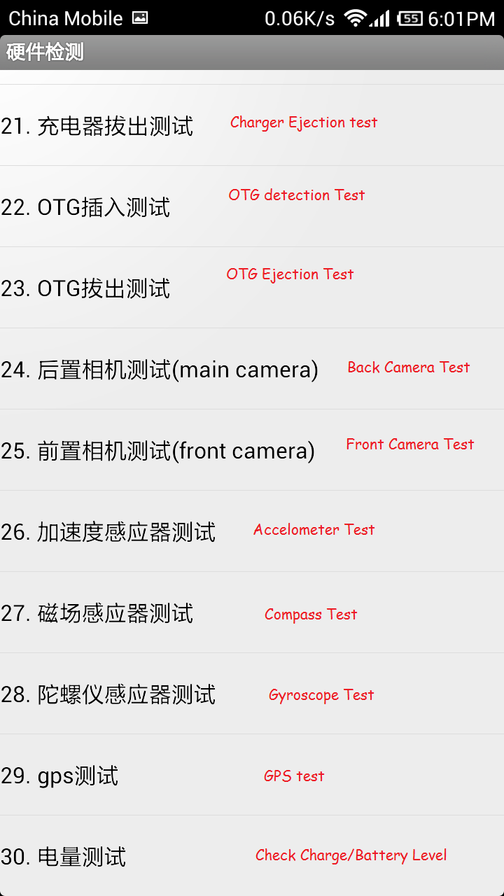

On Mi2 you can test all the hardware/sensors using the code *#*#6484#*#* dial this code and you will see a menu popup which have 30 different kind of hardware diagnostic test. These are in chinese (even with english selected as your phone language only Official chinese ROMs ) So to help you understand I attached the screenshots with English translations and a little description with some tests.
Screenshot_2013-02-03-18-01-04.pngScreenshot_2013-02-03-18-01-22.pngScreenshot_2013-02-03-18-01-49.png
