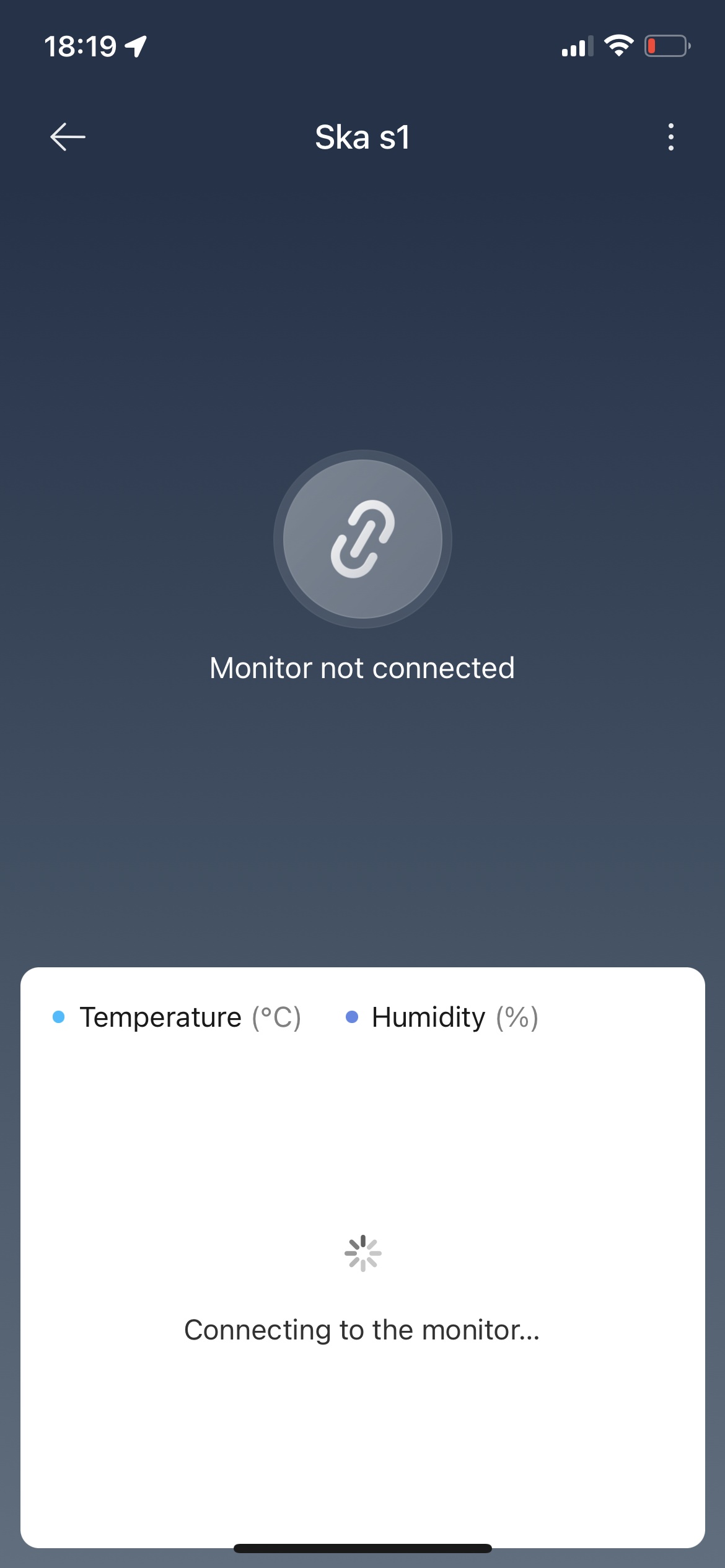

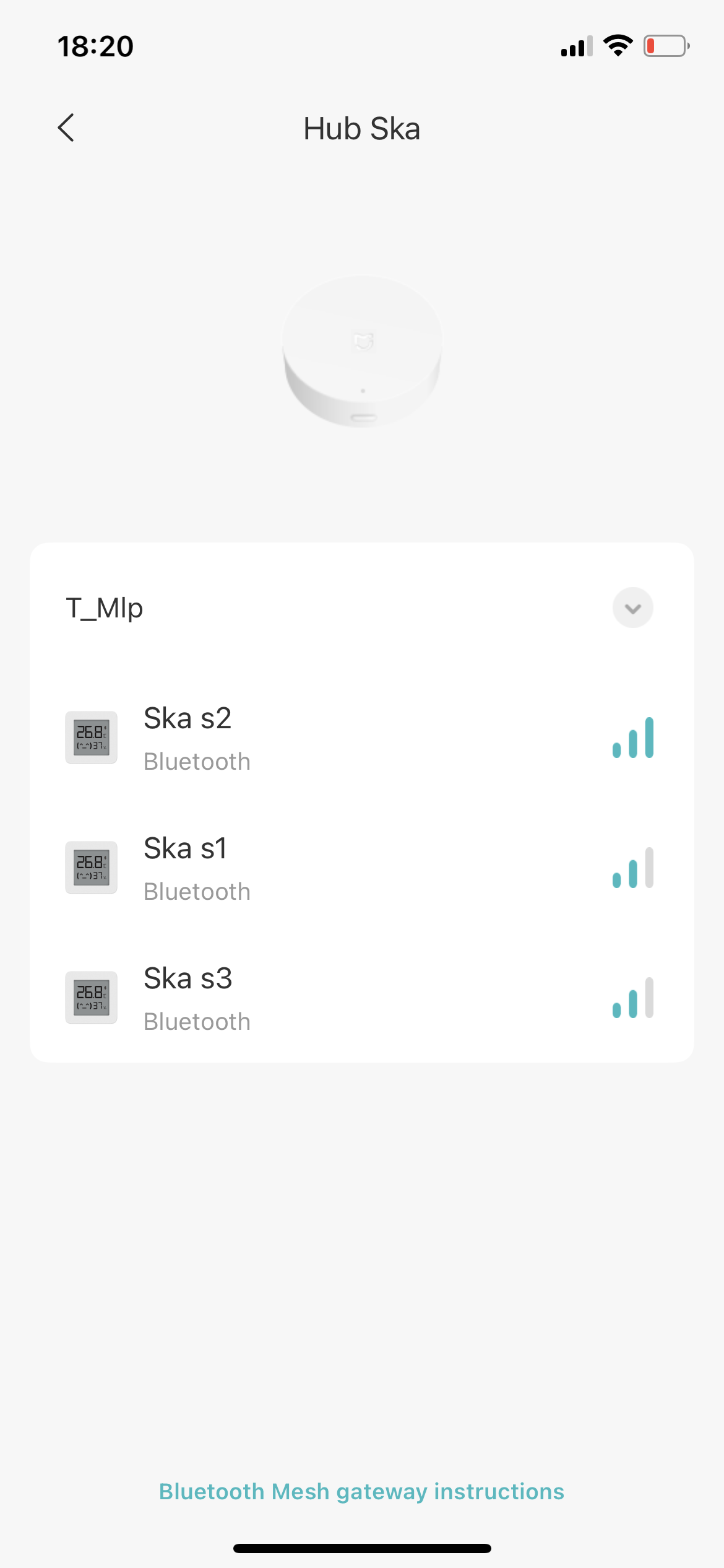

Hi Guys,
I have multiple Mi Smart Home Hubs with paired Mija Thermometer and Humidity sensors. For some time everything worked fine and I was able to monitor temperature remotely and had configured scenes.
Two days ago I lost access to all thermometers via internet. I am able to access them with bluetooth and they are seen by hub, but I cannot connect to them remotely (screenshots attached).
I tried many options and only repairing thermometers with my Xiaomii Home app solves the issue. But to do that I have to visit every location where the sensors are located.
Any ideas what caused that issue? And how to avoid it in the future?

Same problem here which also started few days ago.
When I am at the actual location where my thermometers are attached to the hub AND in their bluetooth range, they can connect and show their value to the app. If I try to check them remotely, they don't work.
The problem is that Xiaomi home app always (since last few days, that is) tries to connect with Temp&Hum2 sensors via phone's bluetooth, not via the internet to the hub to which the sensors are attached to, and that naturally doesn't work if you're checking them from another city away. I tried disabling the phone's bluetooth to try to force the app to use internet for connection, but that doesn't work.
This is all from IOS Xiaomi Home App. Whether they messed the last version of the app or some of their server programming, I don't know, but the problem is on their end.
my problem seems solved. I deleted all the sensors in the mi home app, also did a reset in each one, then added them all again. The sensors did not started to work in the moment, but after an hour, they seem fine.
