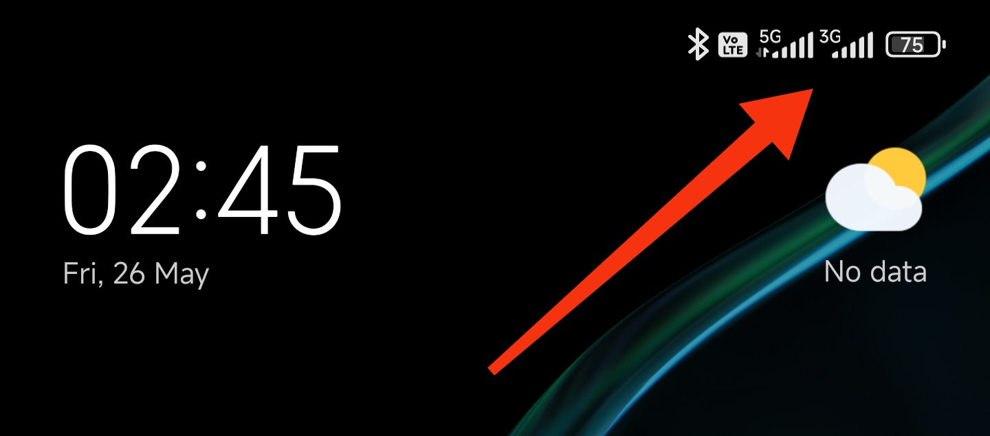

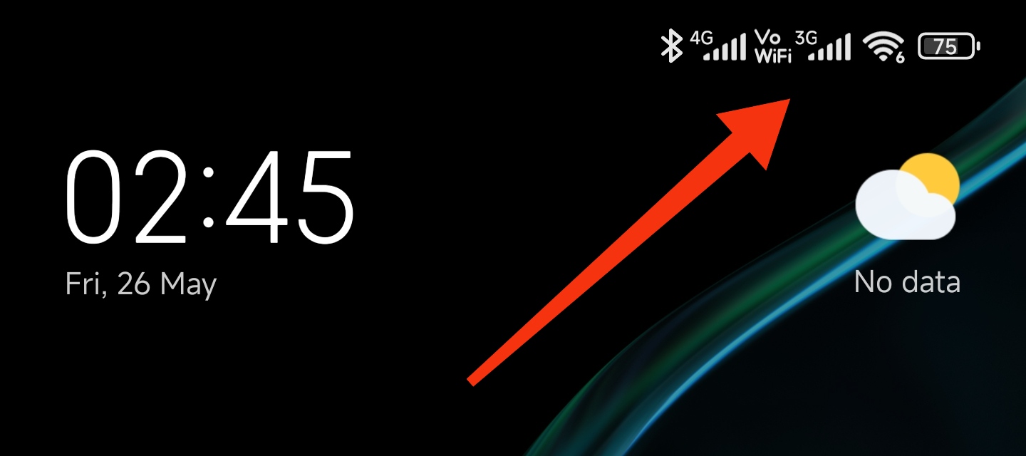

I confirm that Poco F5 Pro (mondrian) - Global can't make or receive calls when Xiaomi.EU .Dev or Stable latest builds installed.
Even if VoLTE, VoWiFi, VoNR, 5G SA manually been enabled as mentioned above #43, with APN settled, both slots (SIM 1 & 2) can't handle radio connection 2/3/4/5G. The signal's icons keep swapping frequencies every 5 seconds in the status bar and device stays hottest. The Rueban (MTB) app doesn't detect any Sub0/1 MBN configuration.

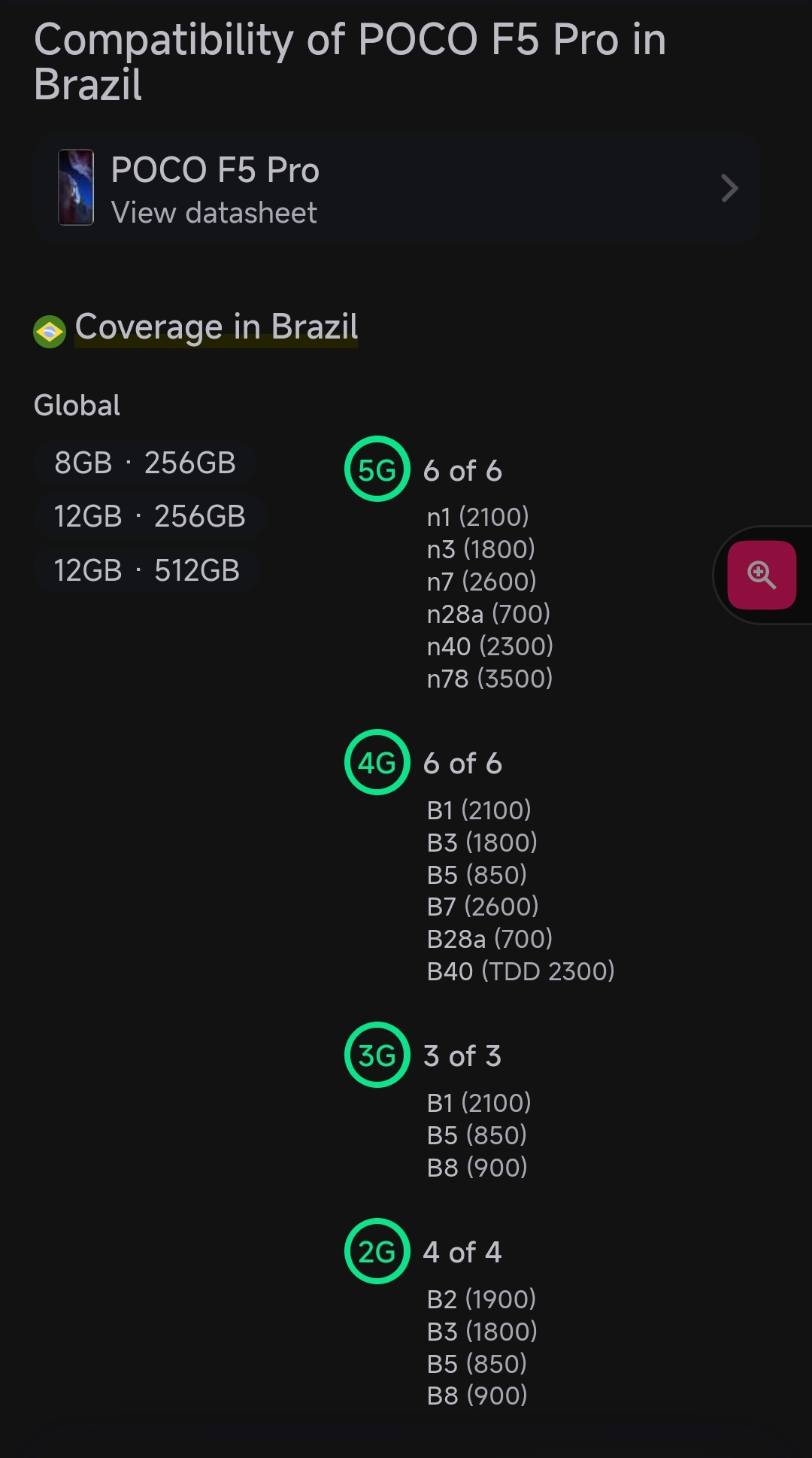

All Brazilian frequencies are already supported by default on mondrian. (annex)

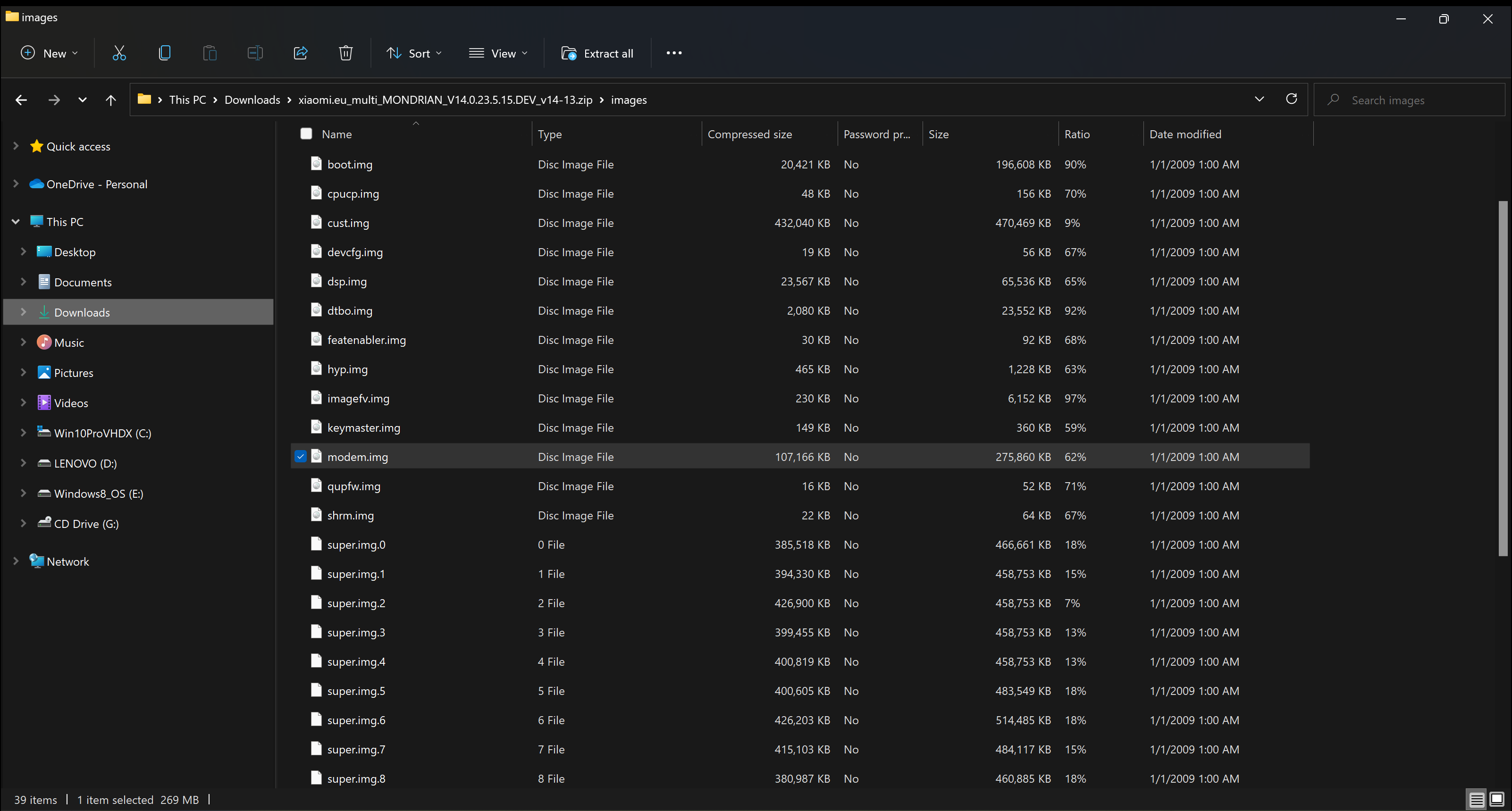

How can I get the image of these directly from the original Xiaomi ROM? Where to swap it on Xiaomi.EU hybrid ROM to TWRP and Fastboot update?
With a payload .bin dumper. You swap it in the "images" folder in our ROM's ZIP.
It will.

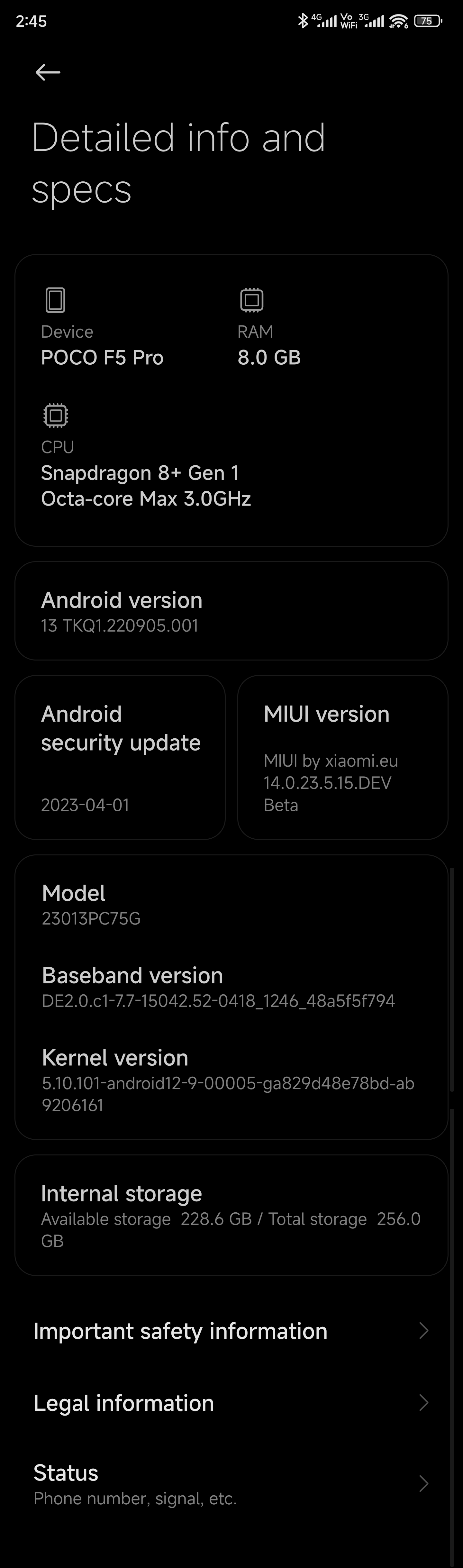

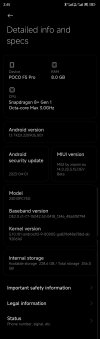

I CONFIRM that now my Poco F5 Pro - Global (mondrian) works flawless with modem.img (EEA) provided #55 above.
That's how I workaround the previous #51 Reported Bug:
1) Stock Stable Global by Xiaomi already installed
2) Swaped modem.img in the xiaomi.eu_multi_MONDRIAN_V14.0.23.5.15.DEV_v14-13.zip (annex)
3) Installed twrp => [BOOT]3.7.0_12-RedmiK60_v7.7_A13-mondrian-skk_1b73488a
4) Installed .Dev by Xiaomi (from step 2 above) through twrp
5) Reboot into Sytem and then Factory Reseted the device, Done
Note: The critical part is to get de the always updated modem image from Stock MIUI EEA. I would like to count with you to provide it to us as already suggested by @Jacometto
