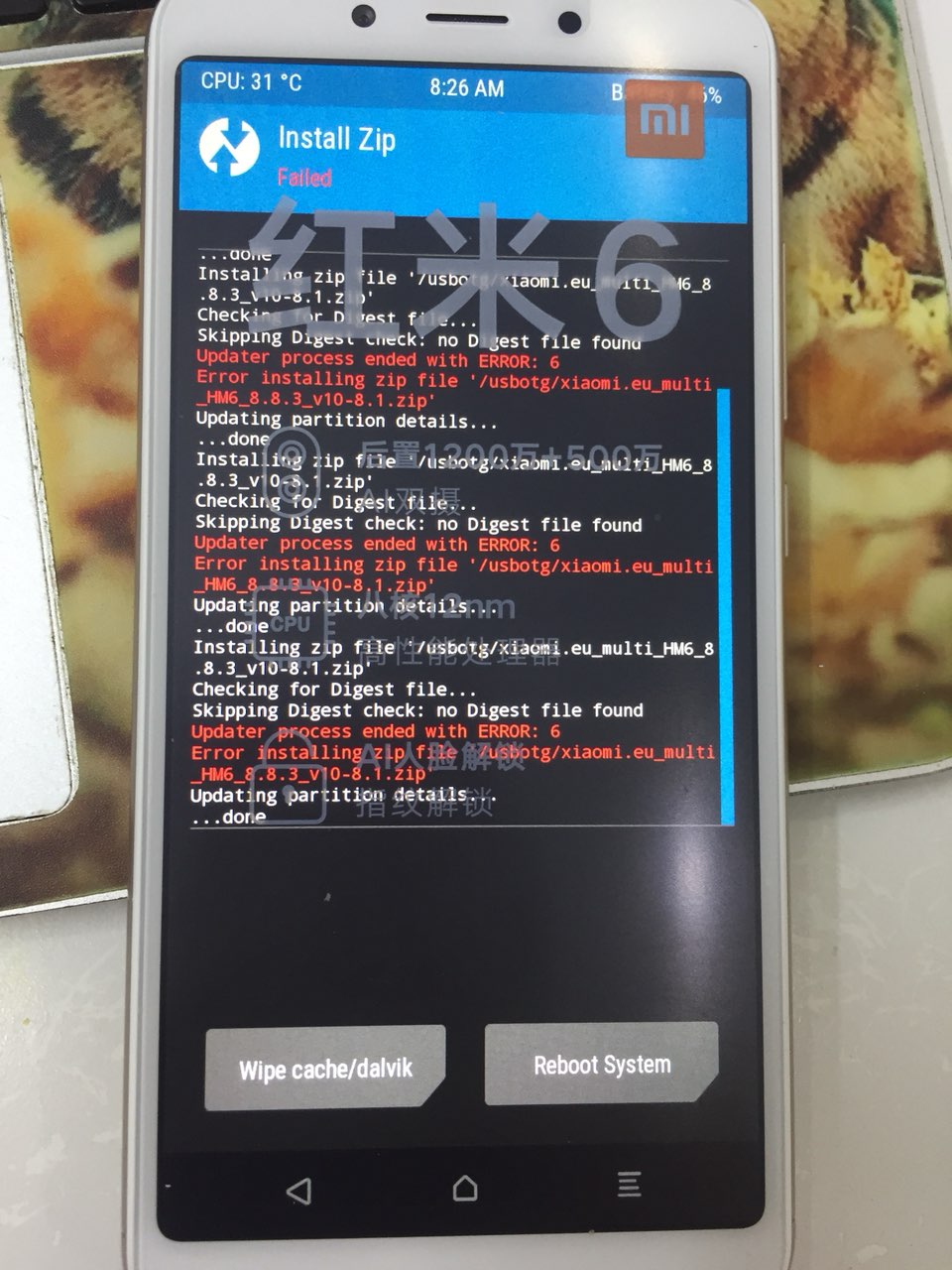

Redmi 6 and Redmi 6A error 6

M mauritsivs Members Jun 30, 2017 13 15 Aug 14, 2018 #5 there is an error in the updater script, you can easily manually edit it and remove the four wrong lines containing ");" and ")," see here, the guys from xiaomi.eu have not fixed this bug yet i guess...

Igor Eisberg Lead Developer Staff member Oct 6, 2016 9,512 322 Jan 5, 2019 #7 There is no more Xiaomi.eu support for Redmi 6/6A. You should not have bought a Mediatek device.
