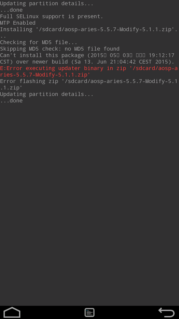

can anyone help me to flash 5.5.7.
I have non-merged (the old partition layout) and TWRP 2.8.5.0.
Wipe system, data, etc.
When i go to flash the ROM it returns an error.
I change the name of the file, i download again but nothing change.
Can help someone ???

Some recoverys give you error if you are downgrading to a rom who was made before
I don't know of that is your problem but if is true I think you have to change the boot.img and replace it with a modern version

Thanks for your answers,
I replaced the boot.img with one new from aosp-aries-5.11.24-6.0.0, but nothing change.
i have the same error with old or the new boot.img
That is the error

You have to do a wipe data. Backup your app and app data with apps such as Titanium Backup before

I have tried everything.
Is the problem of ROM?
I have tried all the AOSP of this thread without solution.
but aosp-aries-5.11.24-6.0.0 installed with no problem.
How can possible that ???

probably build date is easy to upgrade a rom but hard to downgrade

please note that 5.5.7 build linked in OP is the same as 5.5.3, but made for old partition layout [unmerged data - unmerged system].
5.5.3 build is for unmerged system - merged data.

I get the same error if I flash 5.5.3 over MK51.1-201512302020
My TWRP also says that I can't flash Android 5.1.0 over a a newer version (5.1.1). Formatting /system doesn't solve the issue.
I guess the only way is to install another ROM before which doesn't check for the current ROM version and it's older than Android 5.1.0
