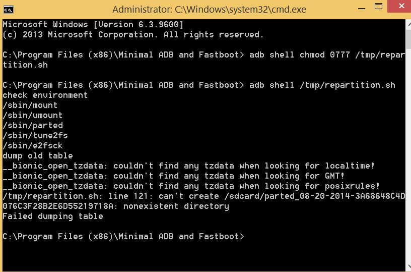

@ M1cha: I got an error while system partitioning my Mi2S.
Can you pls help me ?
This is the error !!!
Code:
C:\adb>adb devices
* daemon not running. starting it now on port 5037 *
* daemon started successfully *
List of devices attached
5981413 recovery
C:\adb>adb push repartition.sh /tmp
493 KB/s (3031 bytes in 0.006s)
C:\adb>adb shell chmod 0777 /tmp/repartition.sh
C:\adb>adb shell /tmp/repartition.sh
check environment
/sbin/mount
/sbin/umount
/sbin/parted
/sbin/tune2fs
/sbin/e2fsck
dump old table
__bionic_open_tzdata: couldn't find any tzdata when looking for localtime!
__bionic_open_tzdata: couldn't find any tzdata when looking for GMT!
__bionic_open_tzdata: couldn't find any tzdata when looking for posixrules!
/tmp/repartition.sh: line 115: can't create /sdcard/parted_08-01-2014-FE12FBA2BD
073BE5E1065C2D89F2280C: nonexistent directory
Failed dumping table
C:\adb>

Mount /sdcard
Mount /sdcard
Thanks, now it worked i guess....

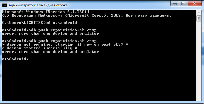

i got these errors trying to repartition my mi2s, any suggest?
