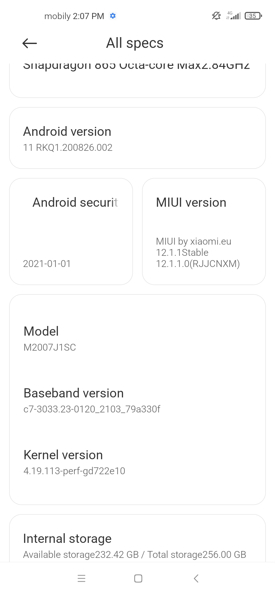

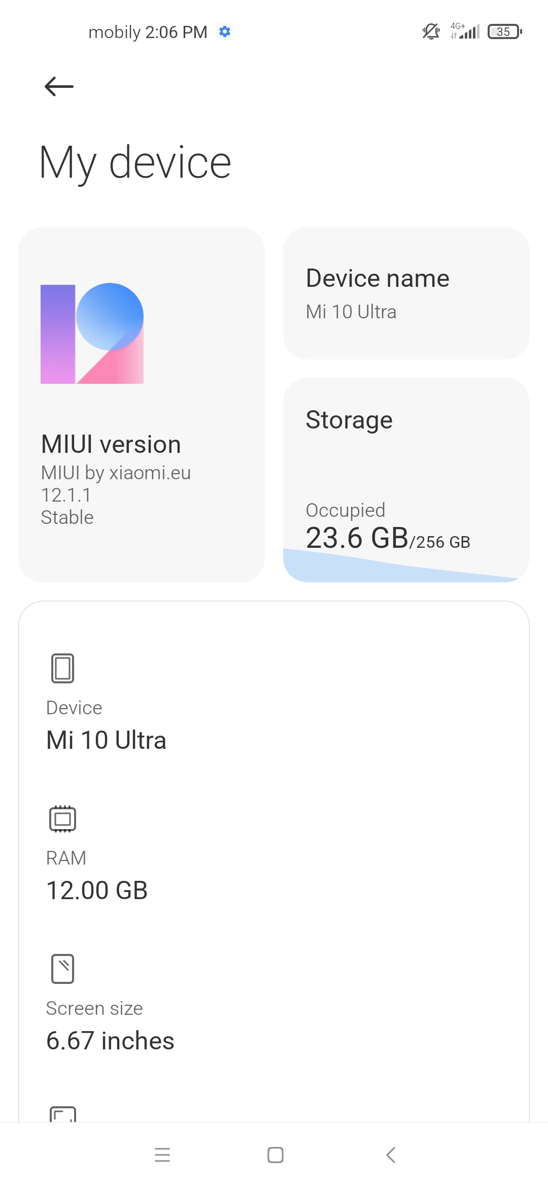

I've tried Original stock rom, and latest weekly builds. and then back to the stable eu rom. MIUI by xiaomi.eu 12.1.1 Stable (RJJCNXM) (Screenshot attached)

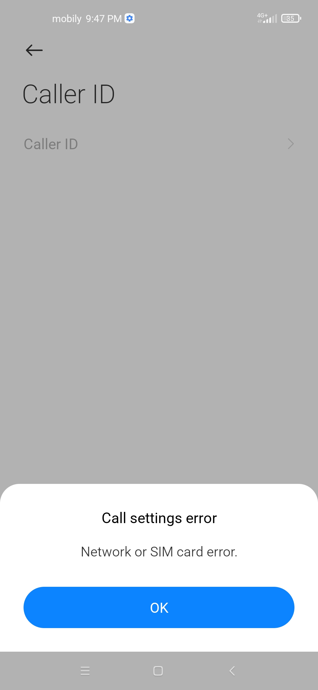

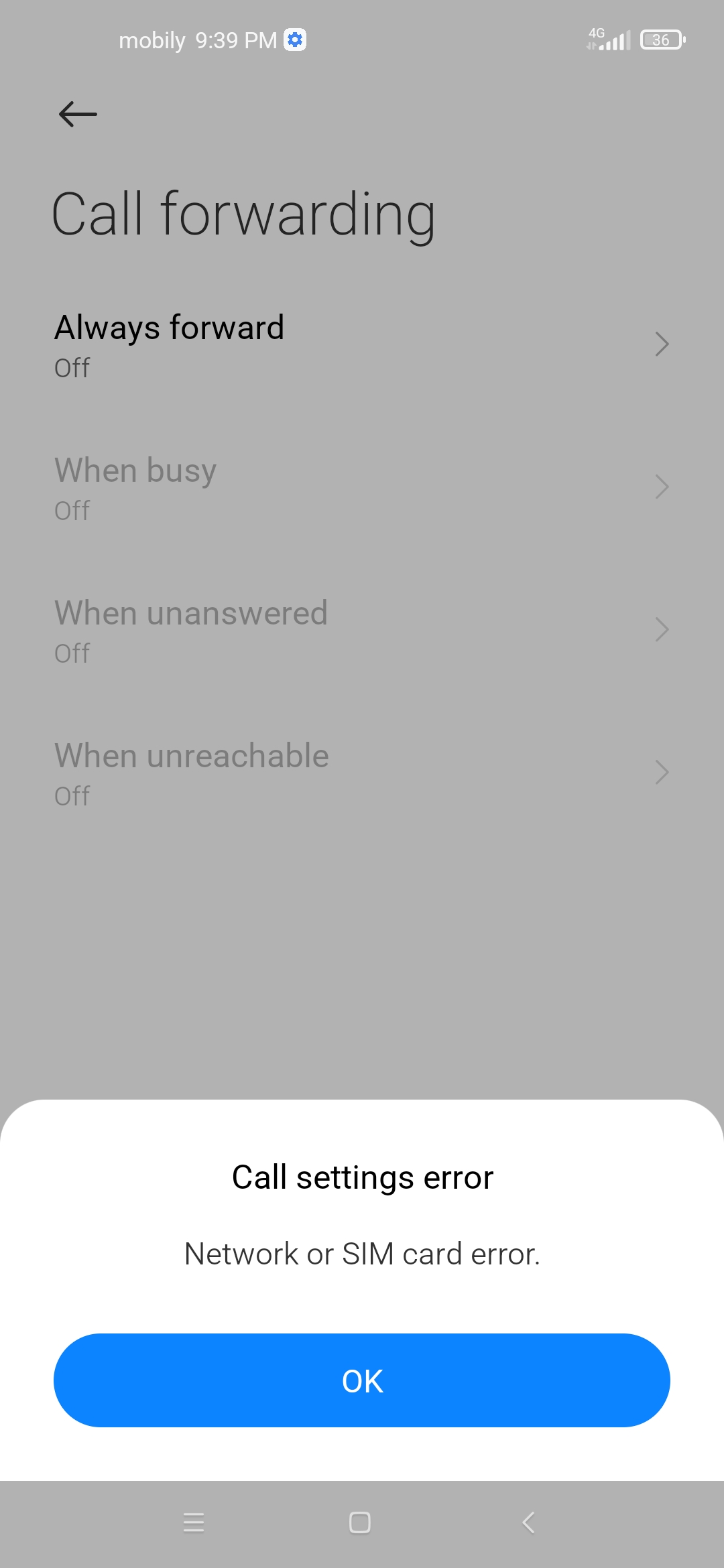

when i try to make calls, it takes a while, and then throws an error msg "Mobile Network not available" (Screenshot attached)
when checking waiting calls configuration or calls forwarding settings it shows error msg "Network or SIM card error" (Screenshot attached)

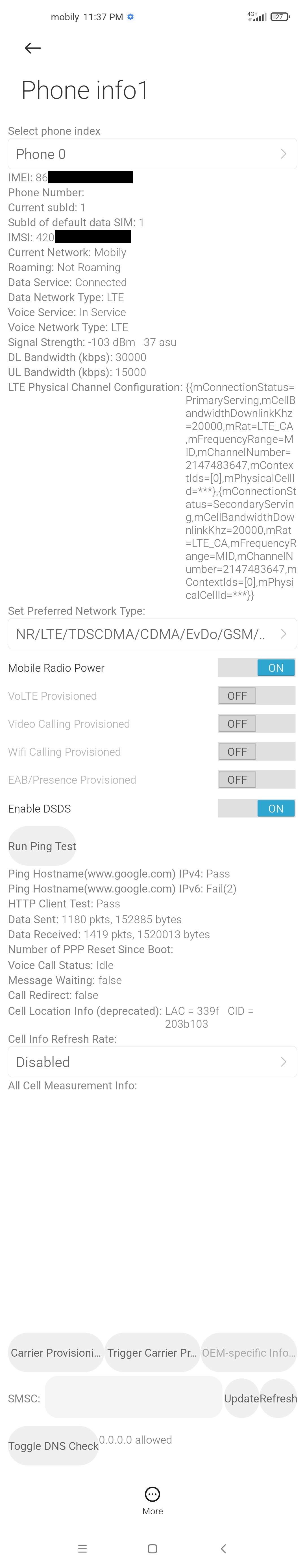

*#*#4636#*#* Phone Info (Screenshot attached)

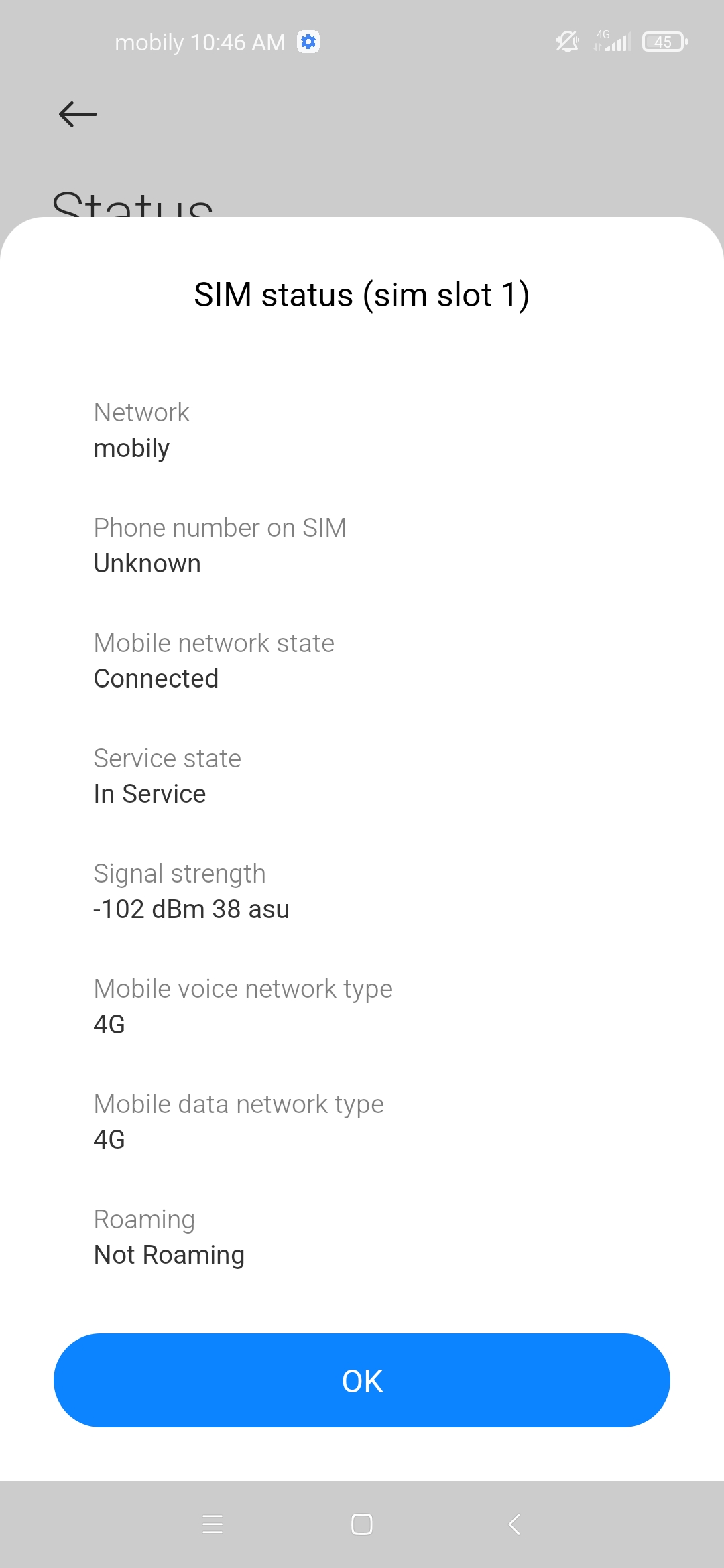

SIM Status (Screenshot attached)

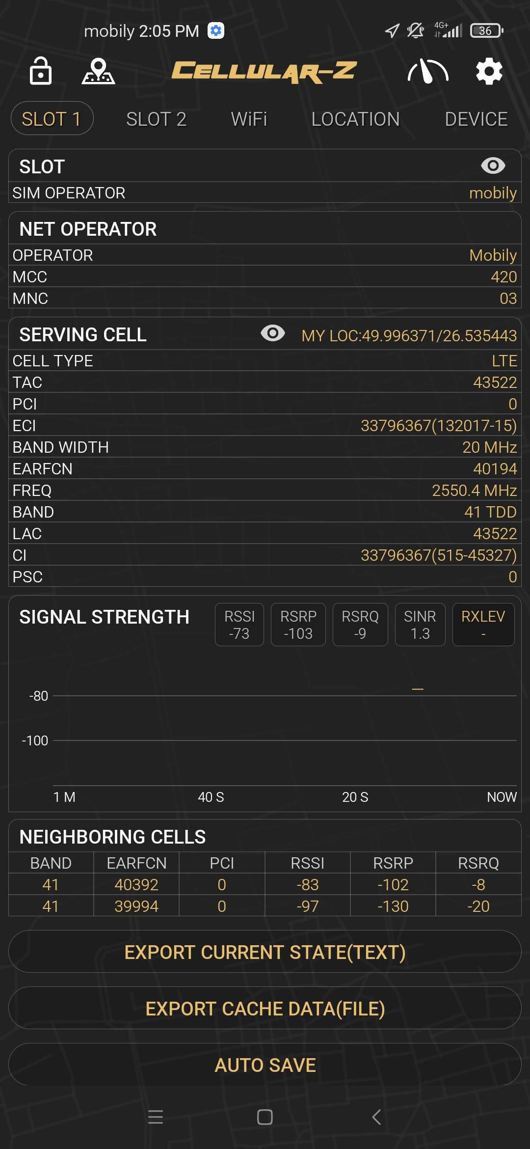

I've run Cellular Z and noticed one thing different from other phones. (Screenshot attached)
in other Phones it shows ICCID (where it is SIM Number), but on this phone it dosen't show it.
So, my suspection is either the antenna, or reading the sim and obtaining the ISSID.

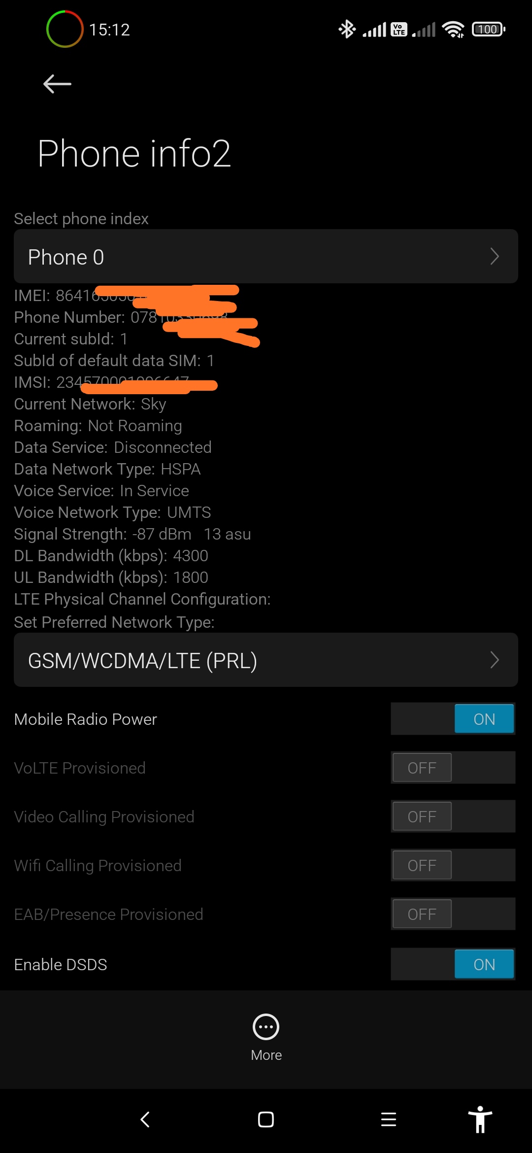

Check inside the phone info page again, and select the network type. I'm not sure where you bought the phone from or where your SIM is from but I think you should not be using cdma, I'm sure that is for China and the tdscdma same. Look at both my Sims for here in the UK in the 2 screenshots. Might be a simple change here to the right settings may get you sorted.
I've tried all of them before. with no luck.
I've set the preferred network to the one you have mentioned. signal is fine, DATA/SMS are fine.
but calls still not working. =

is it possible because of Modem or Baseband Firmware version ? is there something region specific?
Nothing region specific as these were only released in China, hence why some network bands are missing O2 4G in UK, band 20, so I can only use 3G on one sim but EE 4G in other SIM works fine on 4G. This can't be your problem as you have 4G 8n your screenshot and you have tried a different network providers SIM.
As far as I know, no one has managed to change anything in the modem on this phone yet, I follow the conversation on telegram. Any that have tried hard have only made thing worse than they were.
