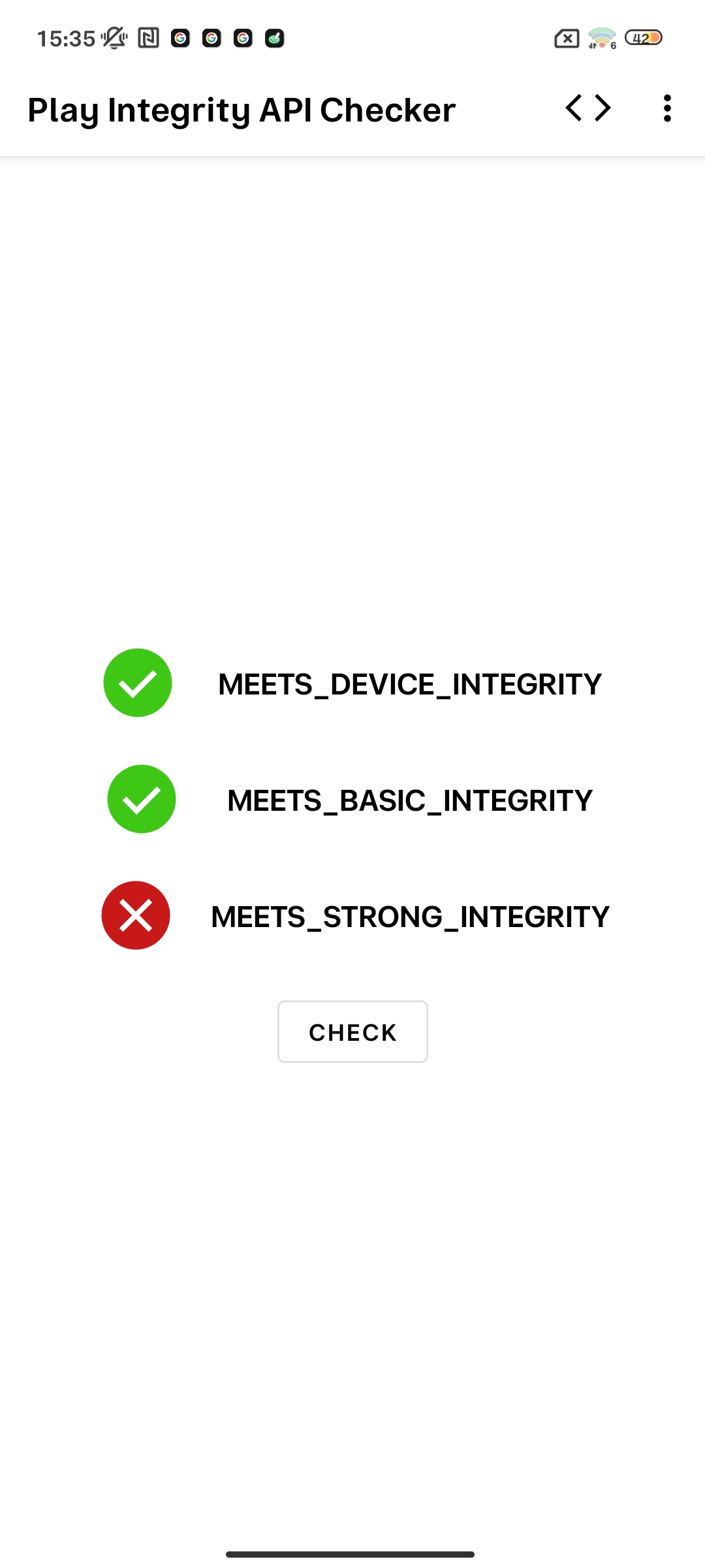

I'm using the stable build but failing this,how can this be fixed?
My bank, starling won't work because of it, my phone passes saftey net but fails this, now I've meet an app that needs it what next?

There's nothing wrong with the results you're showing. You pass "MEETS_DEVICE_INTEGRITY".
You won't pass "MEETS_STRONG_INTEGRITY" with an unlocked bootloader.

How can I switch back and lock the bootloader sorry? I've tried but I get "the system has been destroyed" error
You are supposed to use MiFlash, double check if you are using the correct ROM for your phone region, and don't lock the the first time to see if everything is going alright.
If you reflashed and locked using the wrong ROM (say a Global ROM on a China device), it may brick the device (I never flashed back the original ROM to confirm the exact behaviour).
(Obviously, your app probably won't work until you lock the BL, it is more an intermediate step to give you a chance to understand why you had an issue the first time)
