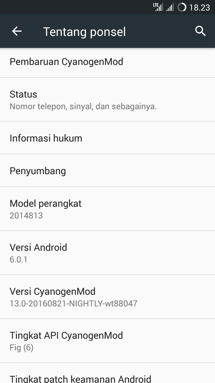

MyPhone is REDMI 2 PRIME, HM2014813 (wt86047), Now in CM13, I dont know the answer of your question but if you want to install CM13, its no problem.

This is the screenshoot from my device,
