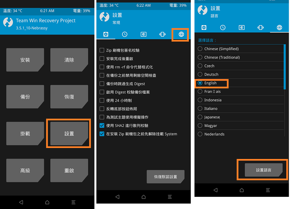

I successfully flashed the TWRP for the Mi 11 Ultra. The first time I booted into TWRP via Fastboot mode, I was asked for my screen unlock PIN. I entered this and confirmed with the "blue tick". After that, the internal storage was successfully decrypted. I switched the language from Chinese to my language. Via "Install" I flashed the TWRP.img from the internal memory to Recovery Ramdisk. After that I'm using the arrow keys back to the main screen. There I chose "Restart" to "Recovery" to start TWRP again. MTP worked immediately and I was able to access my internal storage via Windows Explorer. i am very happy I still have to test backups, otherwise it works wonderfully. :emoji_thumbsup:
Thanks @gogocar62 for your answers and your instruction how to install: https://xiaomi.eu/community/threads/22-6-15.66132/page-5#post-661698
And thanks for your Screenshot how to change the language (attached)
