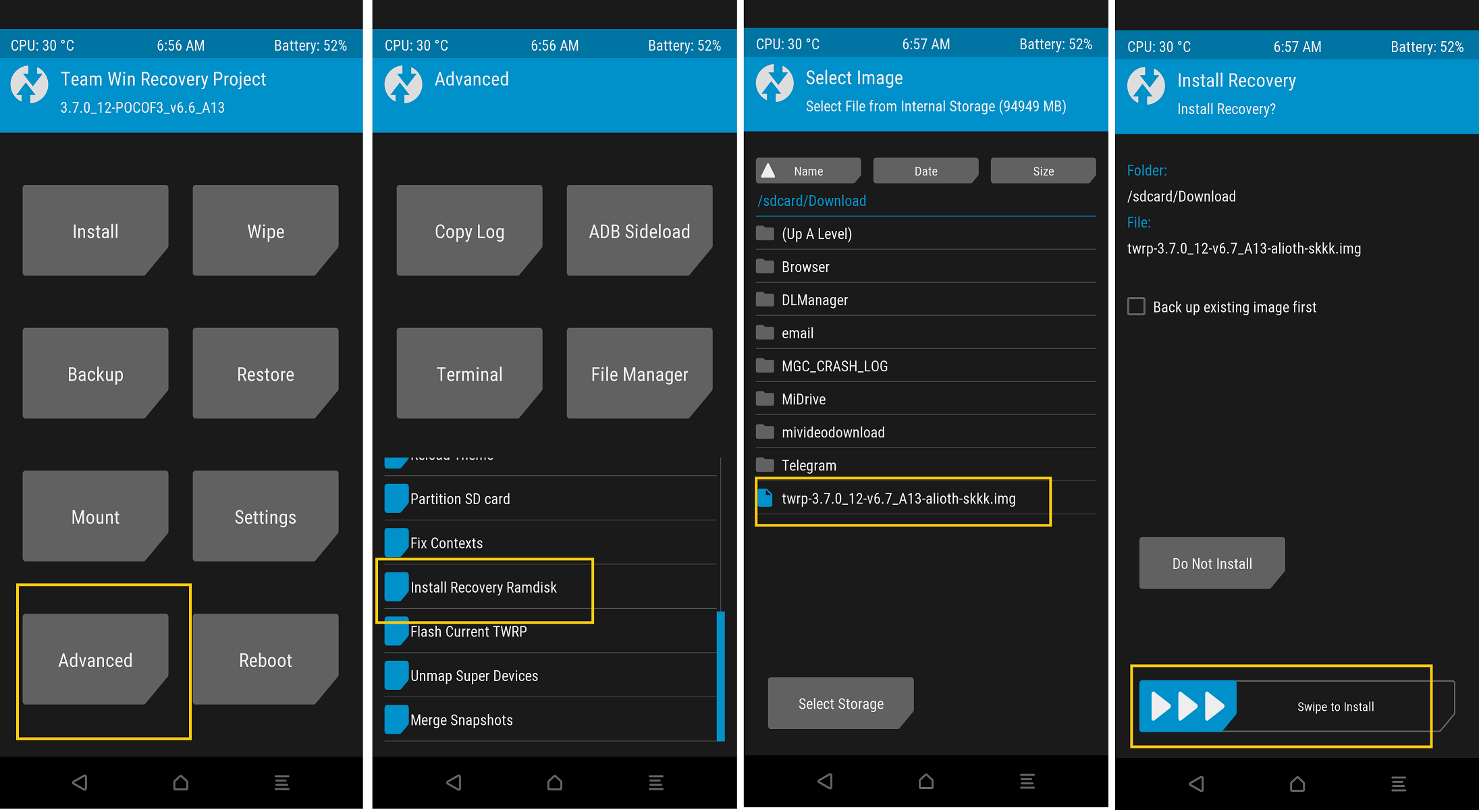

If your device is Poco X4 Pro you used the wrong command.
Proceed as follows.
Code:
fastboot boot (filename).img
In the recovery interface: Advanced -> Install Recovery Ramdisk
You have a picture below.
