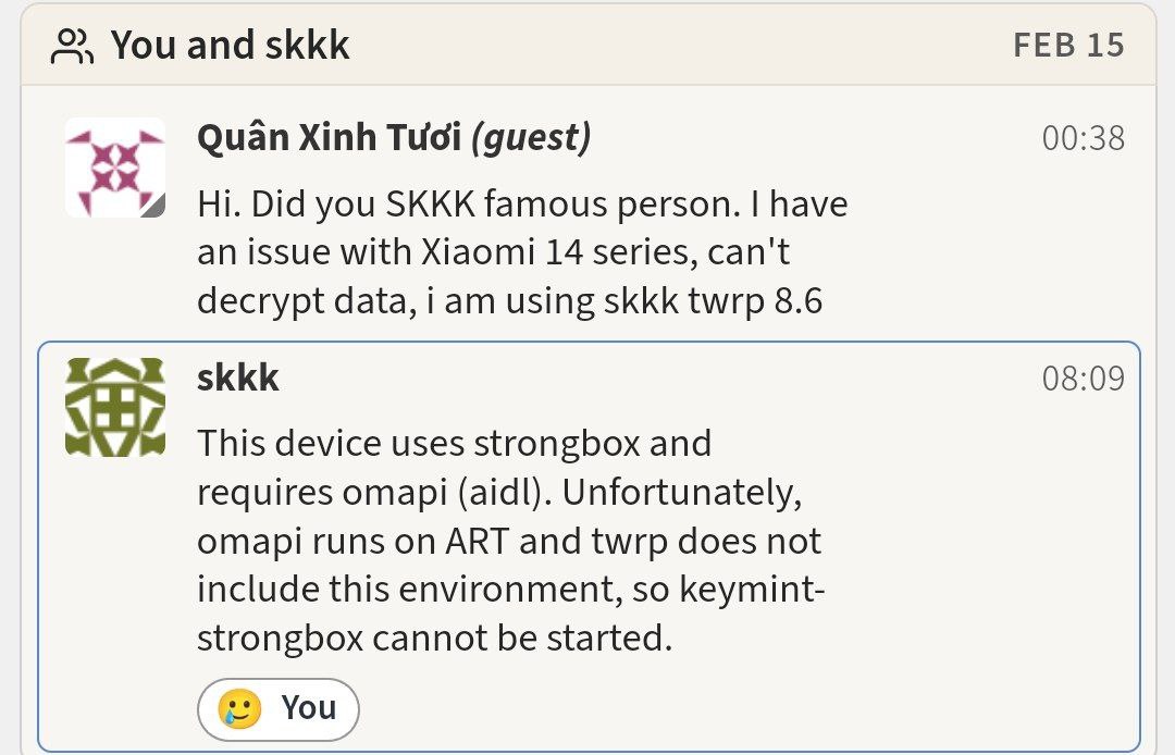

Nothing went wrong, TWRP can't decrypt data on Xiaomi 14 series for now.
TWRP decrypt will never work with 14 series (and above)

Does data decryption work for you? When I enter my password in TWRP, it says password failed, please try again.
I'm on Xiaomi 14
Same for me, actually no data decryption.
