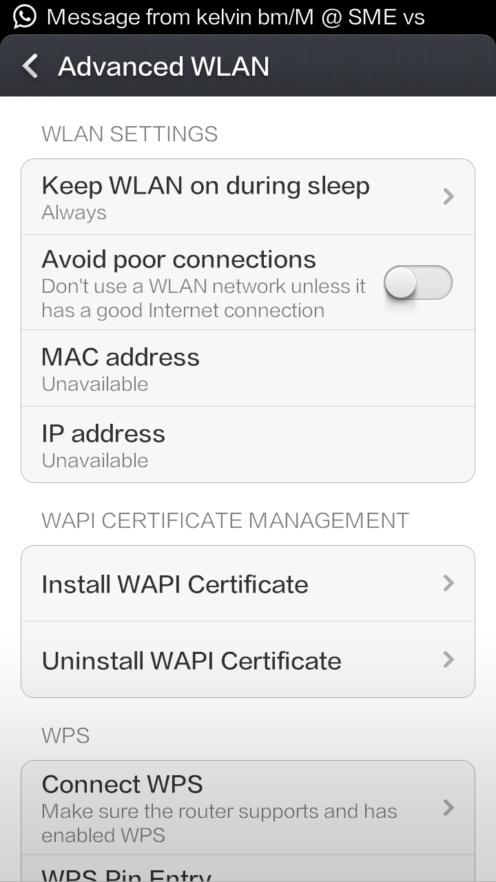

Unavailable IP address & MAC address...wifi module/chip on the Mi2S is dead?
Tenchi Loh
Aug 10, 2013
22
23

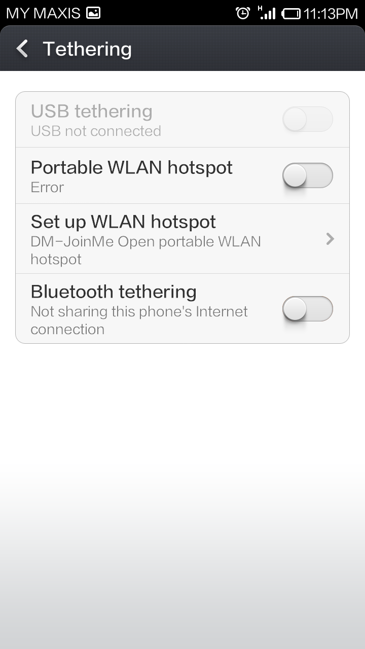

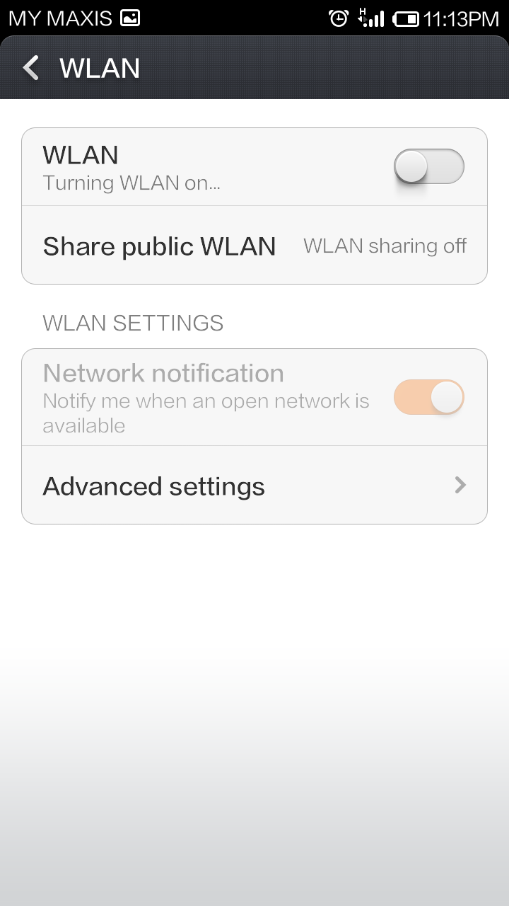

The wifi toggle also grey in colur and cant be activated. Connected to 3G also cant tether the 3G out as hotspot.
So does this mean the wifi module/chip on the Mi2S is dead?

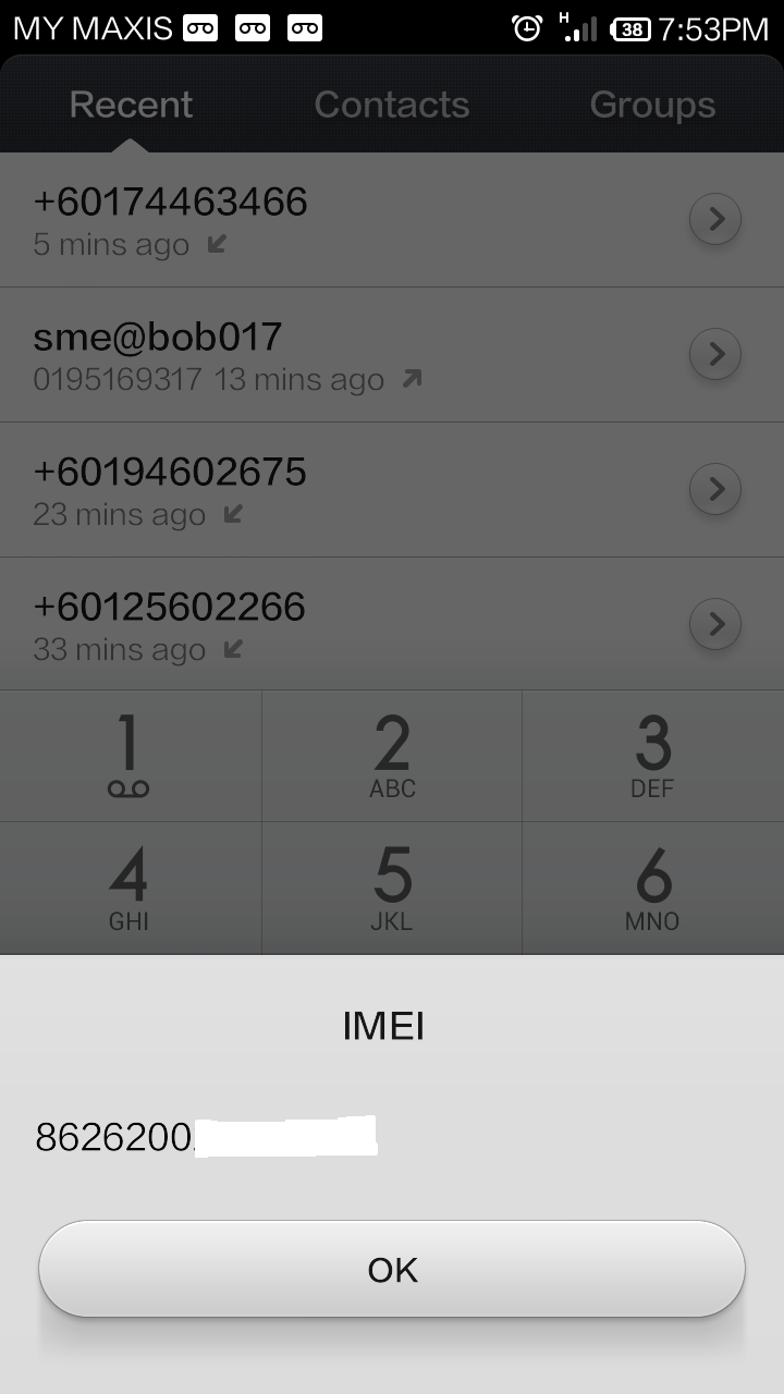

If efs broken then nothing can do already? But he can make call n received calls, if imei gone, that is impossible right?
