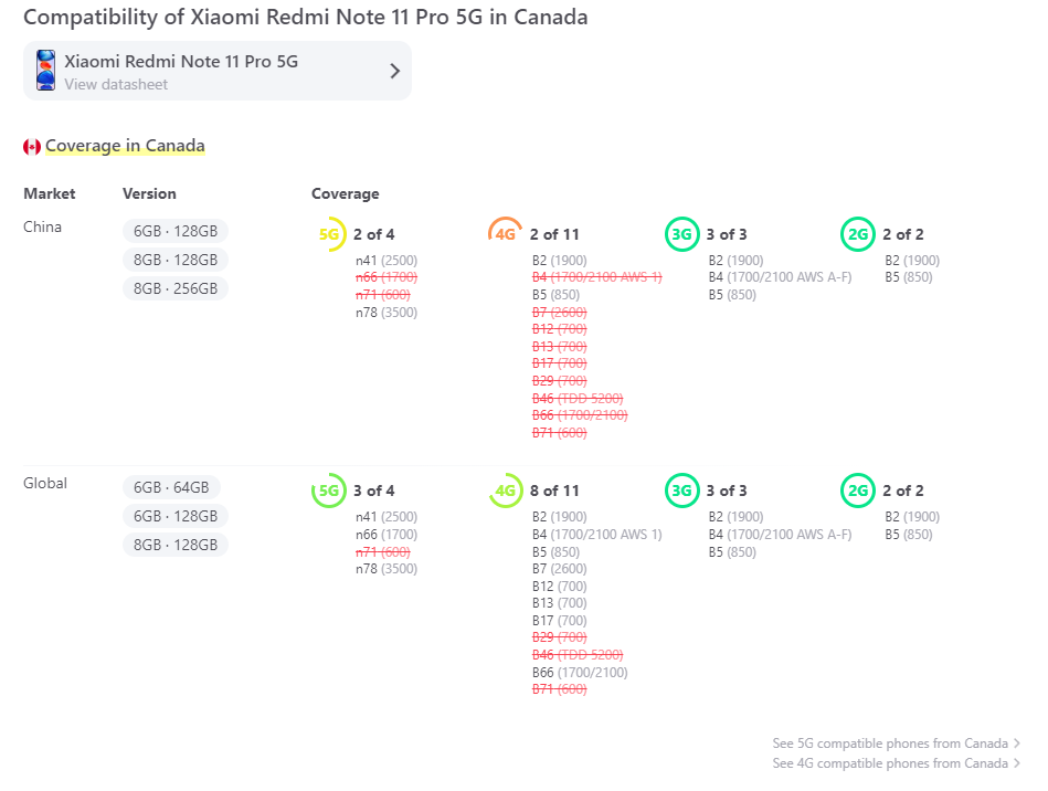

I installed Xiaomi.Eu ROM on my REDMI note 11E 5G (VEUX) and it works very well, but my phone carrier uses B4 band for 4G-Data thus my phone is not able to connect to 4G (only H+), what I'm trying to understand is why the Global version (REDMI note 11 5G) is capable to use B4 band see attached image and not mine (same hardware), I compared the checksum of both modem.img and they are exactly the same. My question how to enable the missing band if there is any type of configuration.
Any help is very welcome!

Global version (VEUXG) and your version (VEUX) are completely different software. Yours is CN - based on Chinese root.
I understand that you have a Xiaomi Redmi 11E Pro phone right?
Yes, you are right (Redmi 11E Pro), I understand your point, but my question is regarding the modem.img for both it is exatly the same (checksum verified), the hardware are the same, with my limited knowledge I expect that maybe there is somewhere a configuration based on location and this is what I am asking for.
thx
thx
You can't look at the file "modem.img". You have to look at the construction of the phone and the electronic components. 11E Pro is a model released for China. There are other standards out there. Even NFC is completely different than in Europe.
Where did you buy Redmi 11E Pro?. This is a model for sale in China ONLY.
