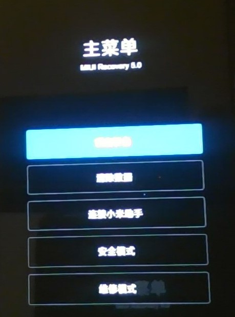

Hello I download the new update MIUI 13.0.13.0 on my phone and I have to update with recovery mode but I don't what it means so I can't make this update, someone can translate step by step pls ? Or an other way :) ?
Info : my phone is : Mi 11 Ultra
Thanks for your help and have a nice day ! :)

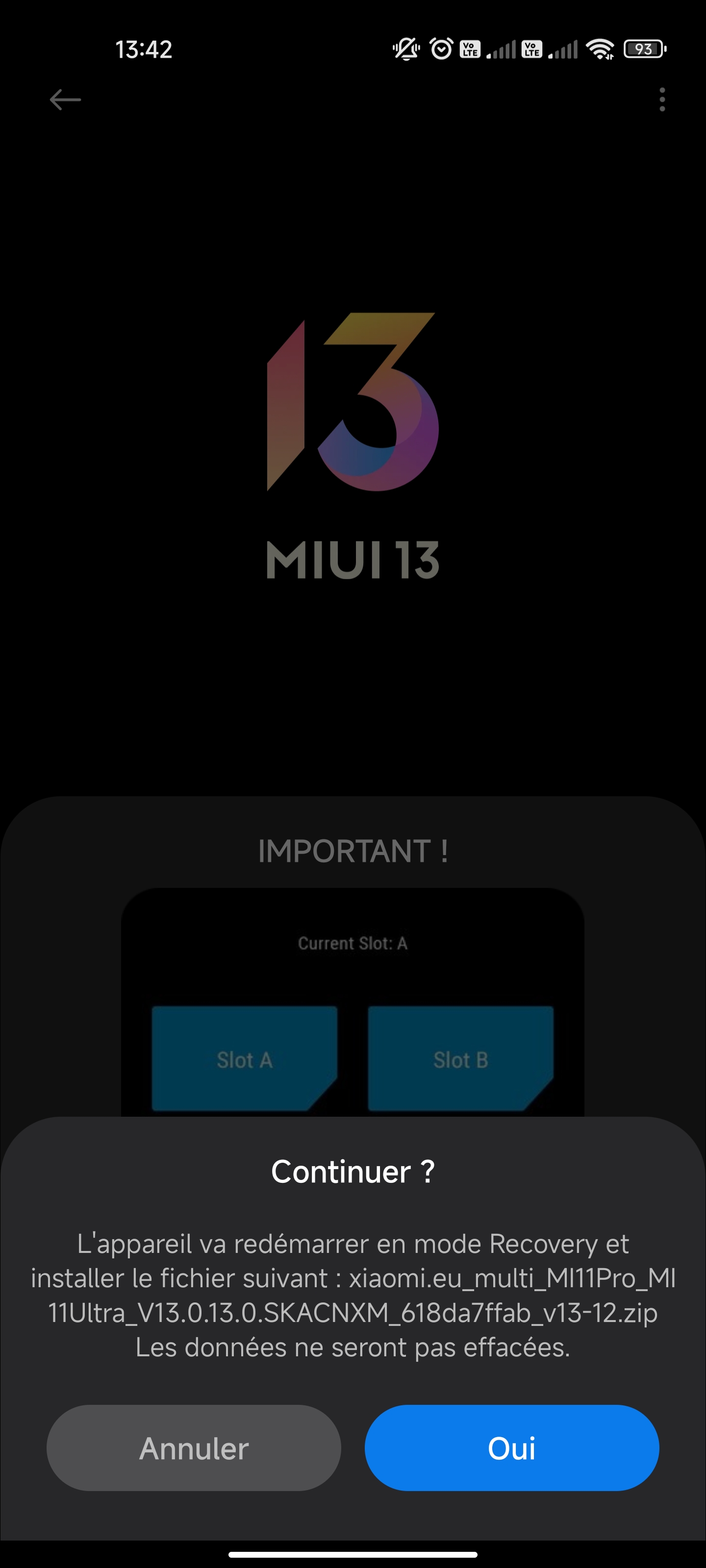

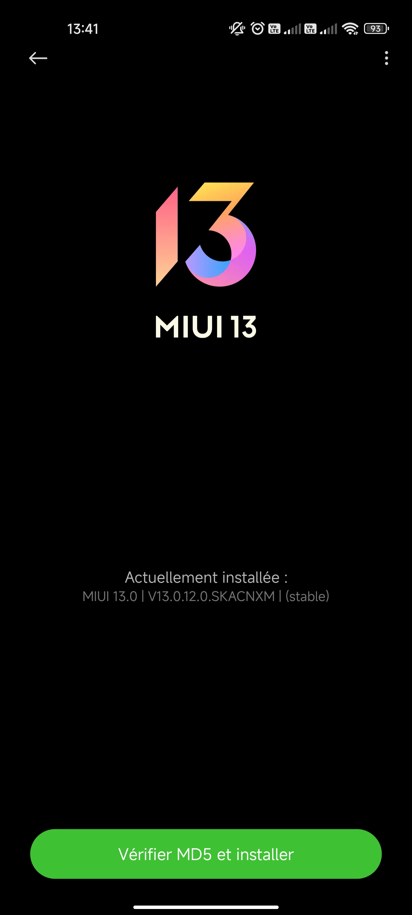

1st pics - in english : The phone will reboot in recovery mode and install the following file : xiaomi.eu_multi_11Pro....
2nd pics - in the green part - in english : Check MD5 and install
