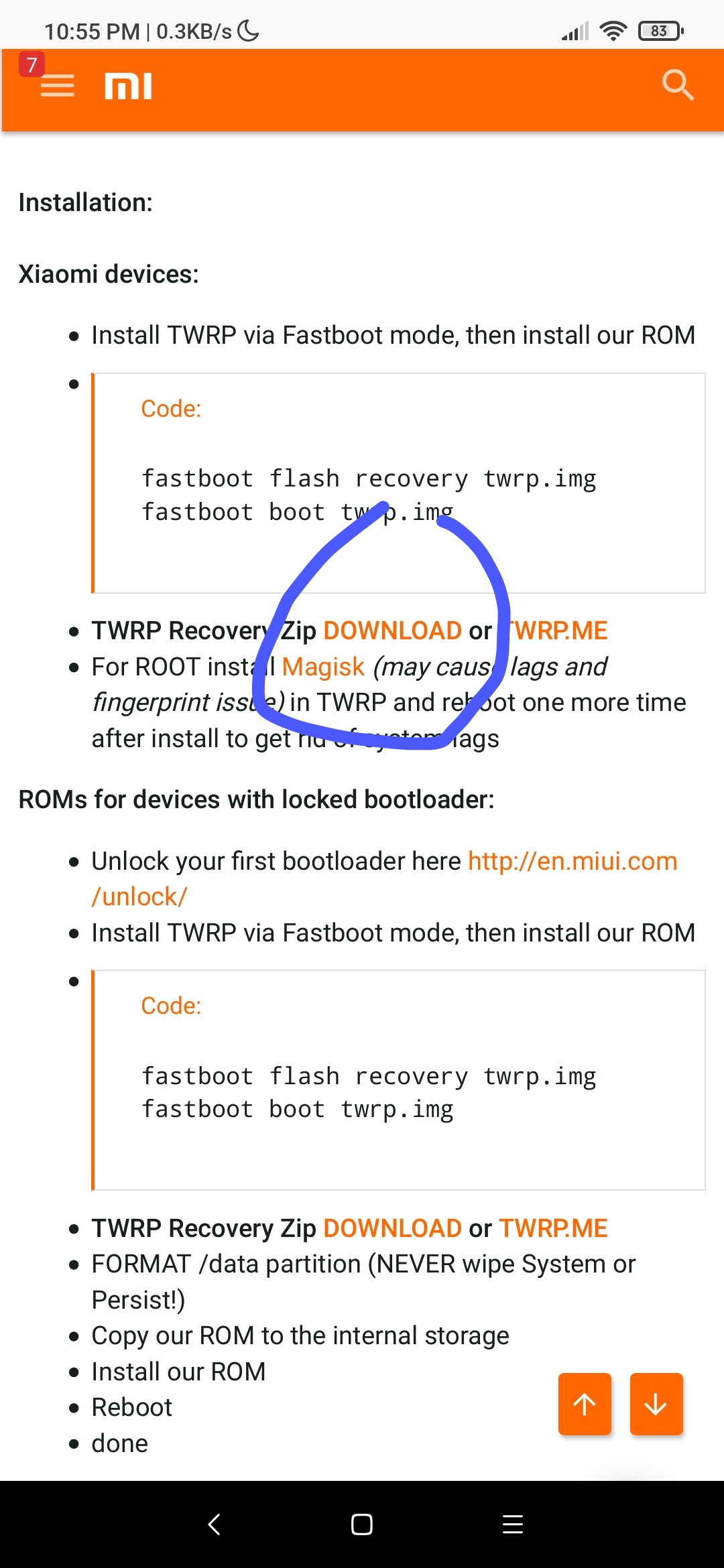

I was using the original L.R. Team twrp, flashing the android 10 EU rom updated the twrp automatically. Works fine for me. The latest twrp is also on the first post for the latest weekly rom. Just look for the tucana twrp
