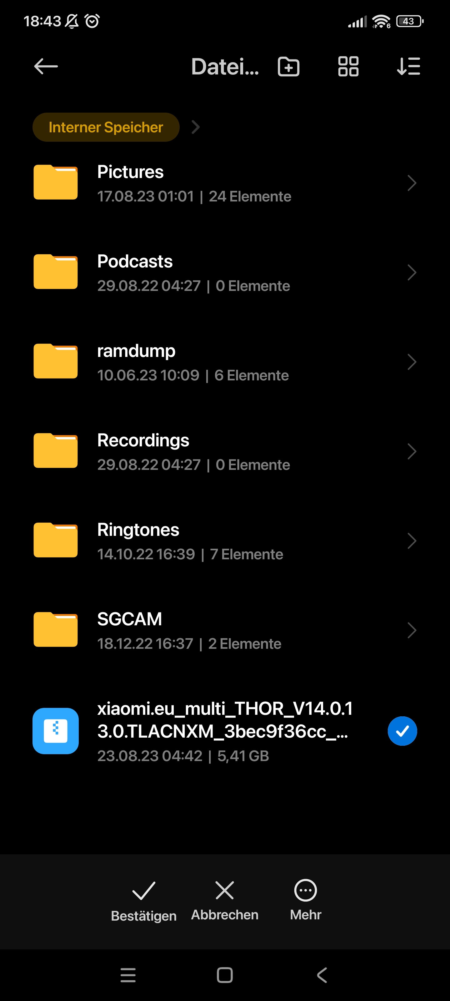

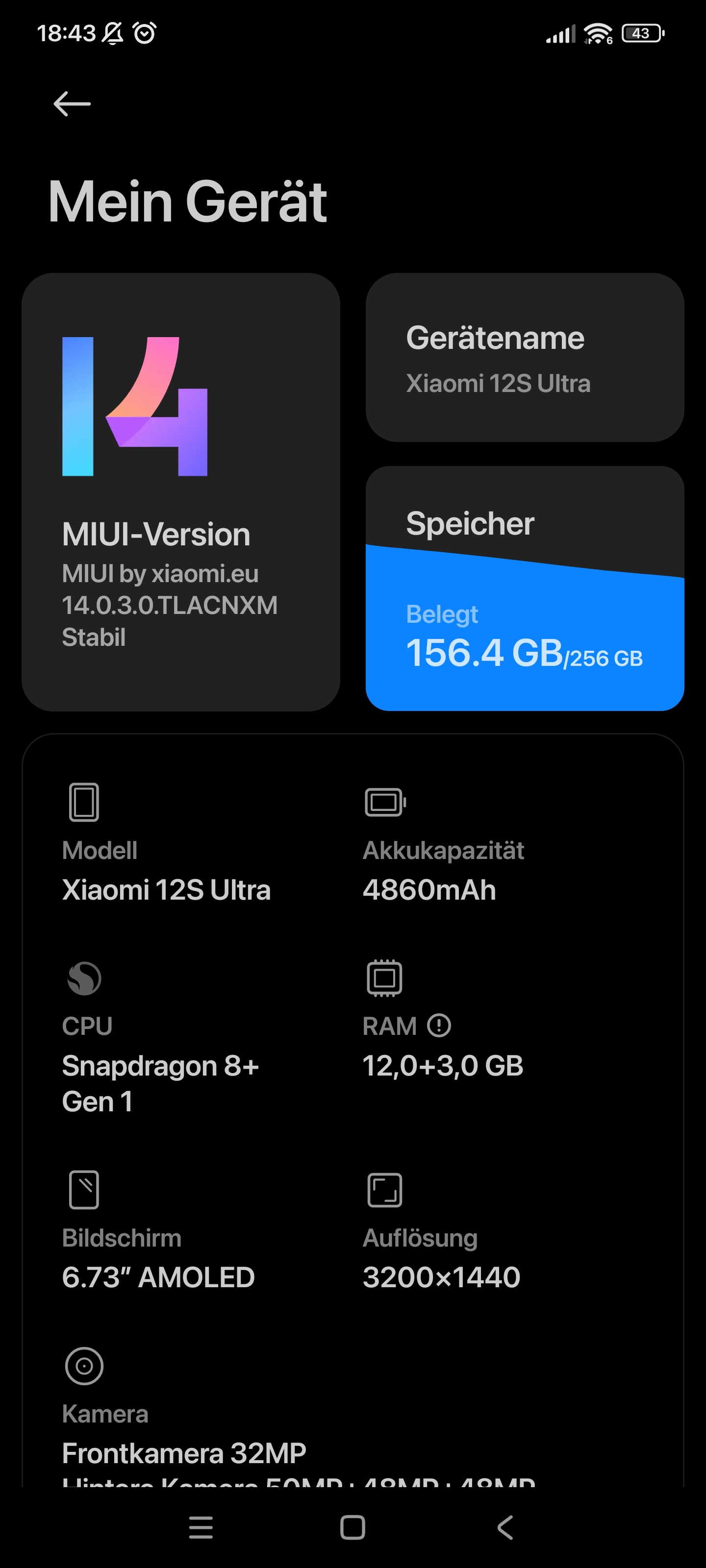

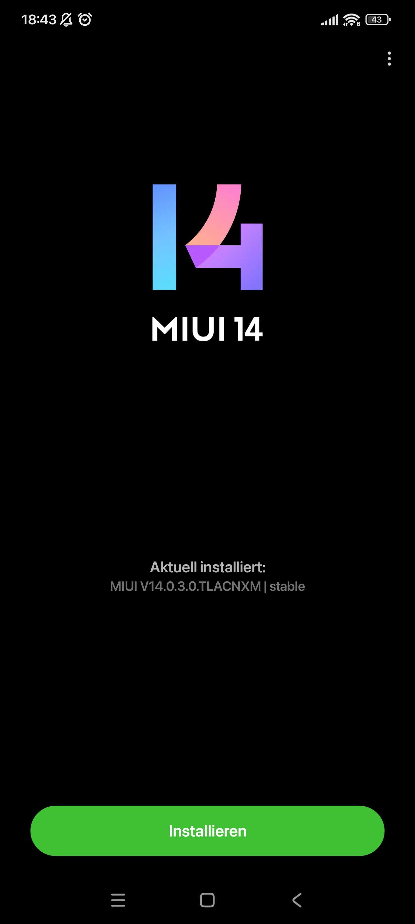

Hey!
A while ago, I installed TWRP and at that point the last THOR Build. (V13.0.9.0.SLACNXM) + (twrp-3.6.2_12)
I then did an Update to MIUI14? Through the “Updater” App. (14.0.3.0 TLACNXM)

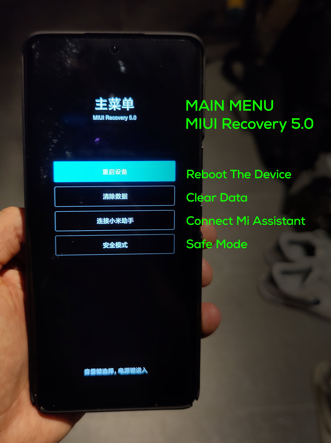

Since that, I can't seem to install any new update. The Phone restarts, stays a minute in the miui recovery, starts normally but still stuck at 14.0.3.0.
I tried to download some new builds manually but still no luck.
If I read correctly, the TWRP install didn't work correctly.
What step do I need to do know?
Didn't find a fitting thread or video that had similar builds/problems, so I'm a bit scarred to do a “solution” that was posted several months ago.
Thanks for any help!
Update to latest EU ROM using fastboot. Same EU ROM does both fastboot and twrp. Then look at installing twrp. At least you will know you can have a working phone.
First time on EU ROM on this phone, you must format data due to possible partition differences.
