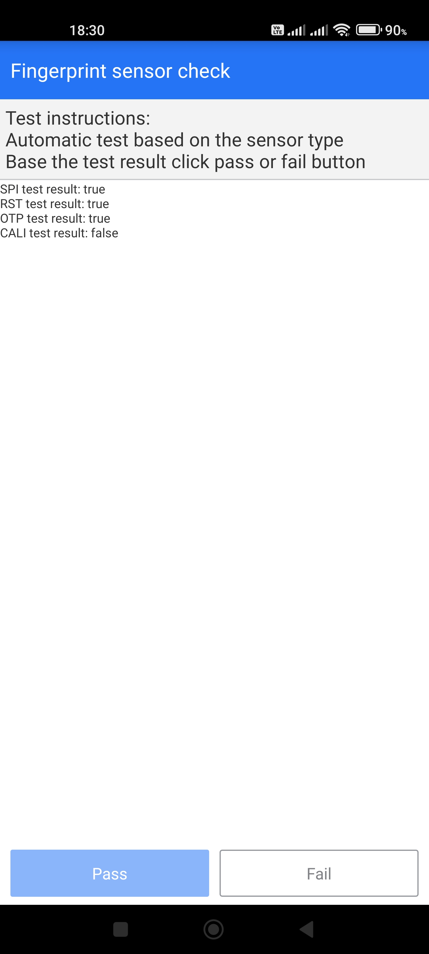

Hello everyone and Happy New Year to all! I've searched around in hope to find threads that have this problem already resolved, but with no luck. So i bought this phone a couple of monts ago and i can't add my fingerprint. The option works just it does not detect my finger. I've tried numerous fixes but so far no good. Tried the calibration menu but on the third test the calibration fails due to error 1505 i think it was. I don't know from the previous owner if the phone had screen replacement before me. Today i ordered a calibration tool from Ali Express as a last resort measure but i doubt that will help. Can you sugest some stable Roms that have this issue fixed somehow? The phone is Xiaomi Mi 11 Ultra 12/256GB Ceramic White EU specs with the lastest update of MIUI 14.0.7.0. TKAEUXM, Andorid 13 TKQ1.220829.002. Also after the latest update the battery drain is extremely fast when phone is charged to 100%. It goes to 90% in the matter of couple of minutes. Also the charging process is now faster in the range of 90 to 100%. Thanks to anyone. I hope to find some solutions to these problems soon, cause i love this phone so much. It's the best Xiaomi that i have owned.

I've tried numerous times with or without screen protector. It's the same thing. I'm starting to think that there is some sort of hardware issue.
