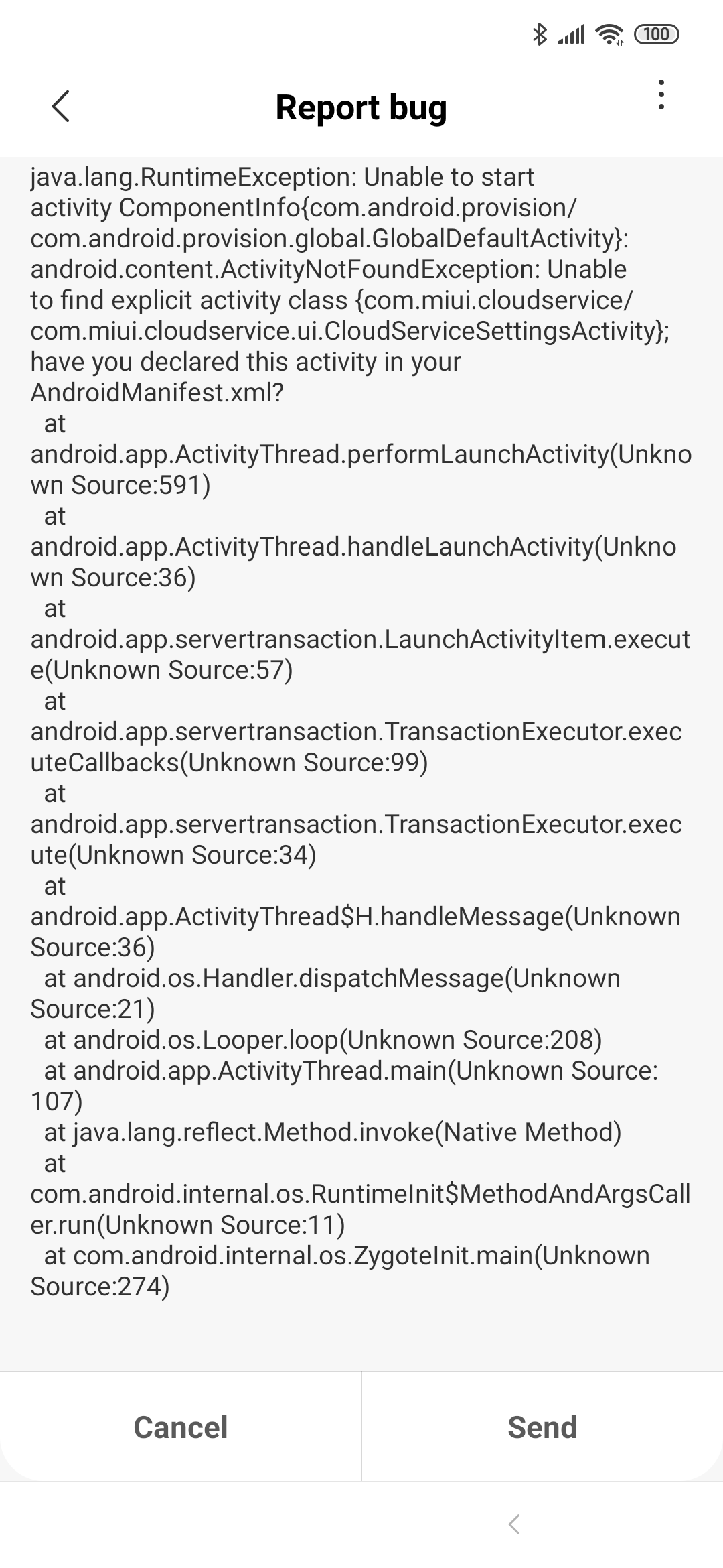

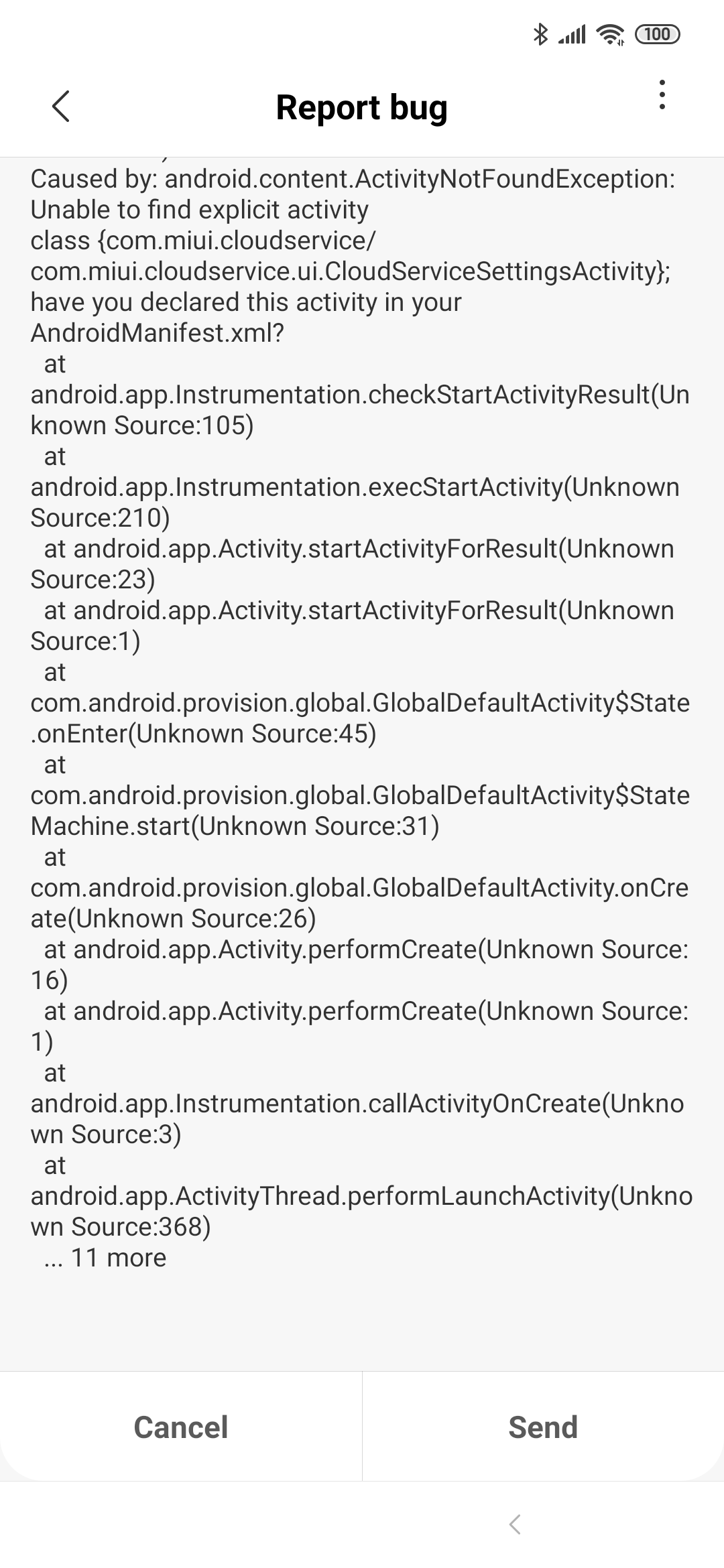

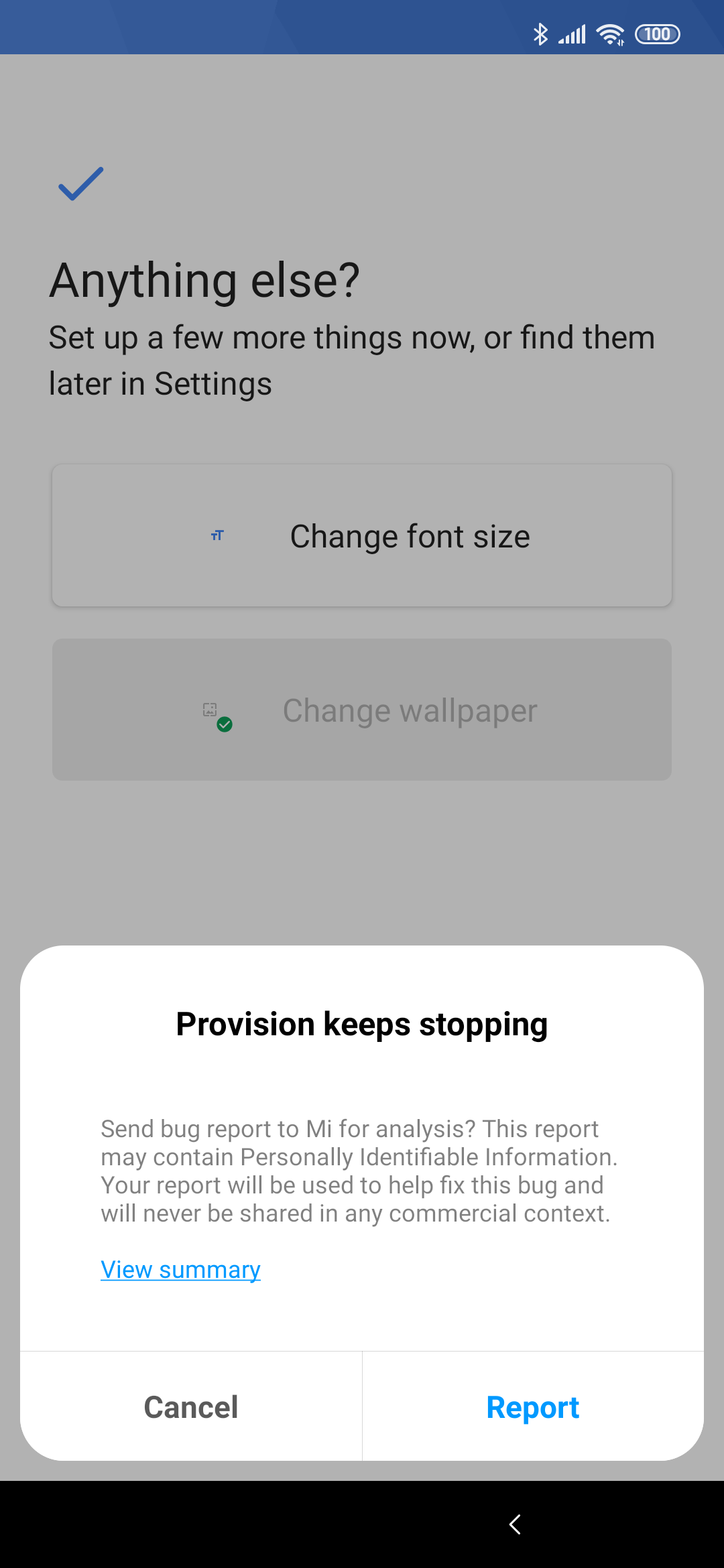

I've just flashed it but I have the following at the end of Google account's configuration : "Provision keeps stopping". Any idea ?
Here are screen shots

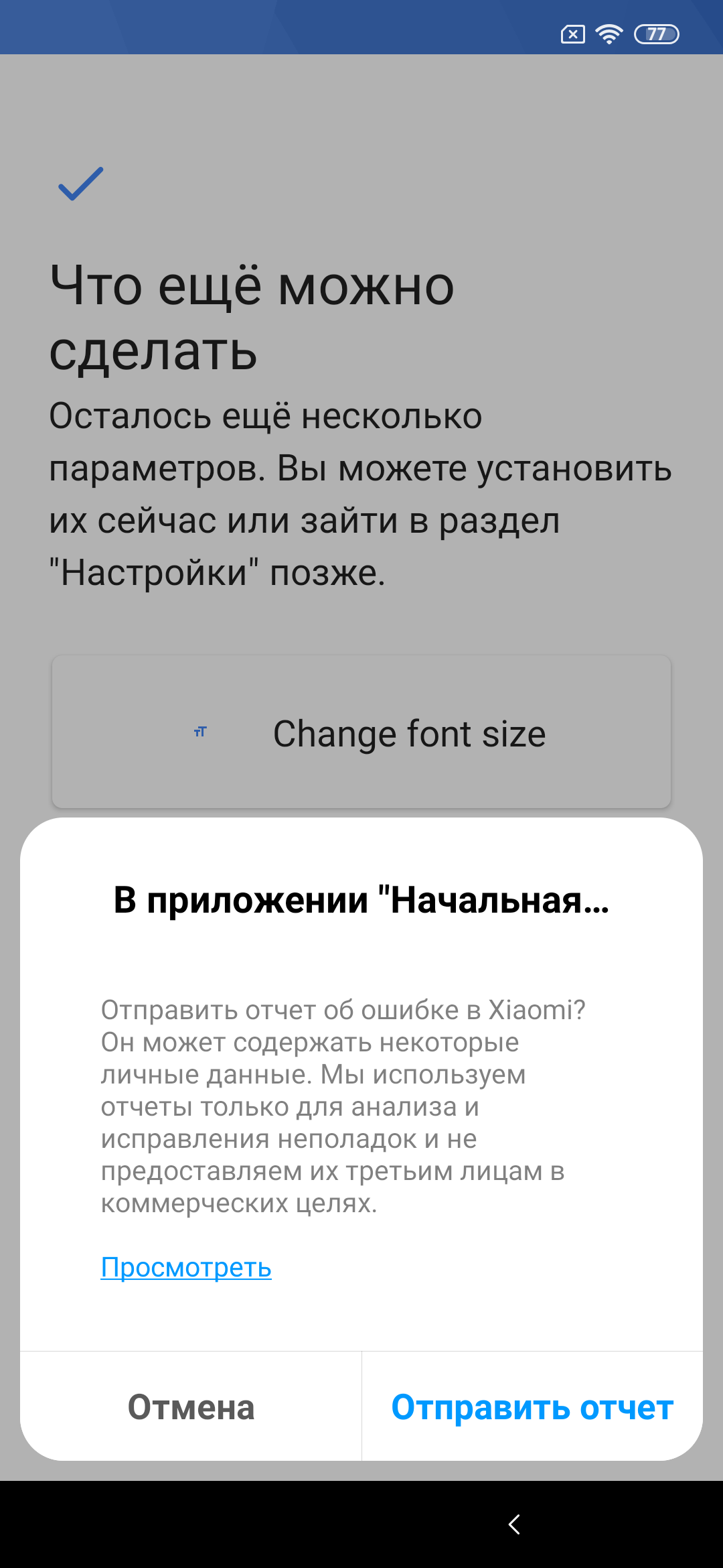

Also suffered)

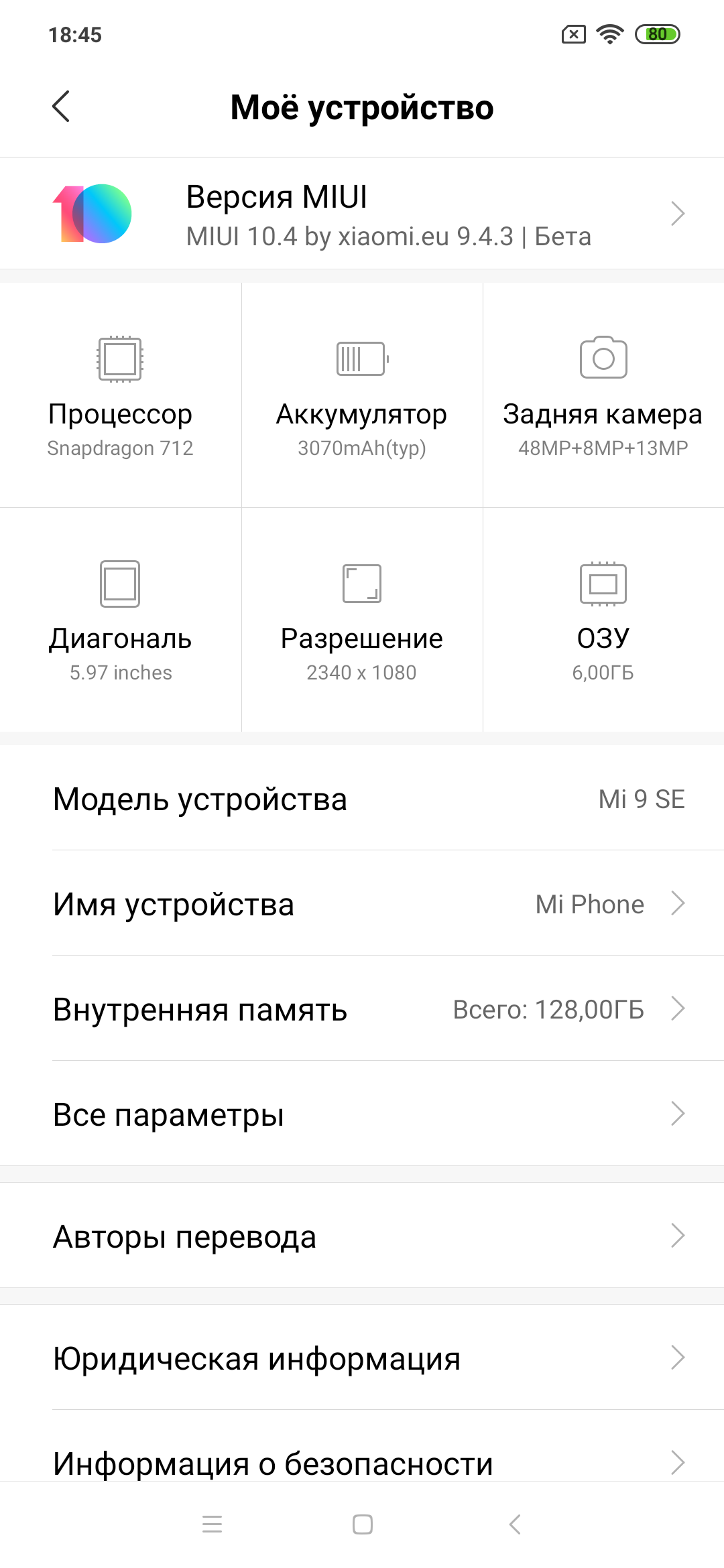

Flash MiFlash Chinese firmware (fastboot version), re-install TWRP, make format data, and flash .EU
In the process of initial configuration, do not tie accounts
