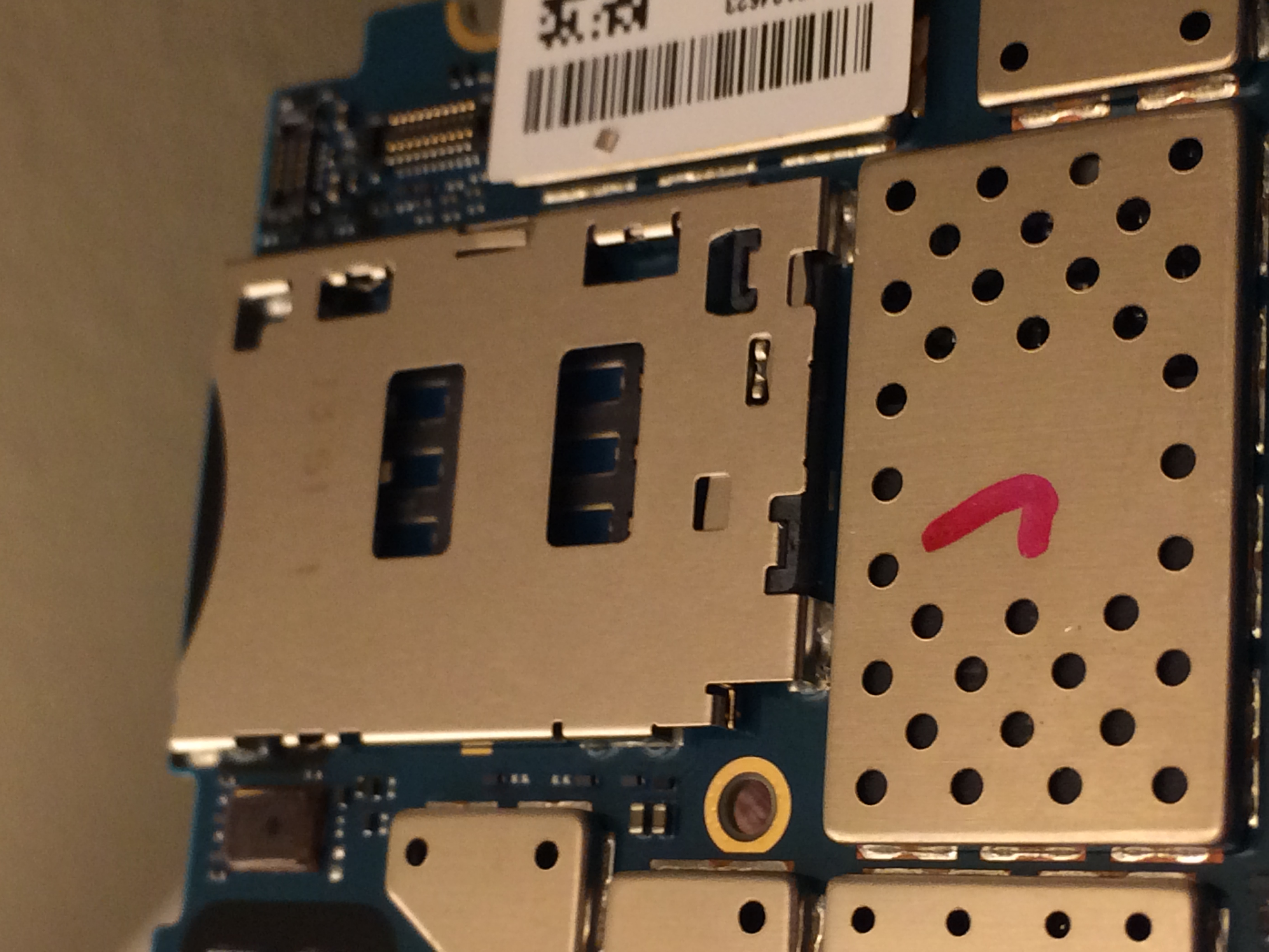

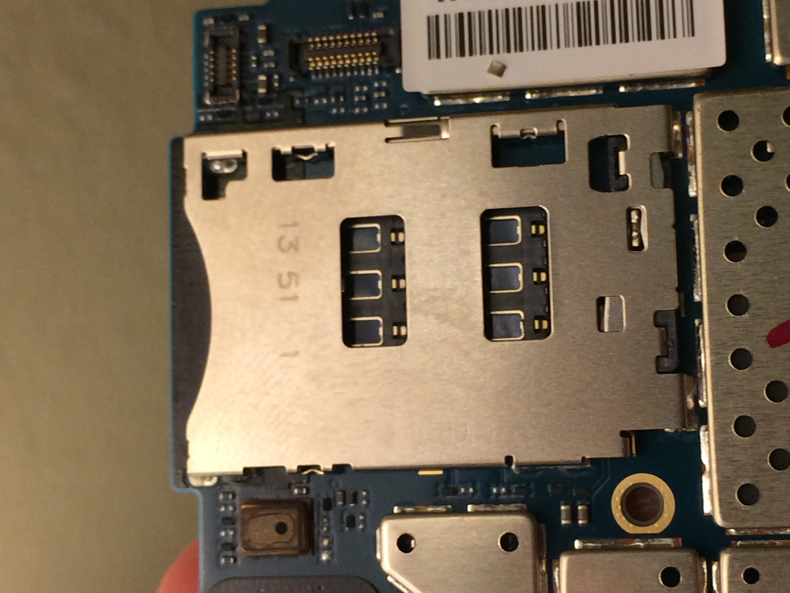

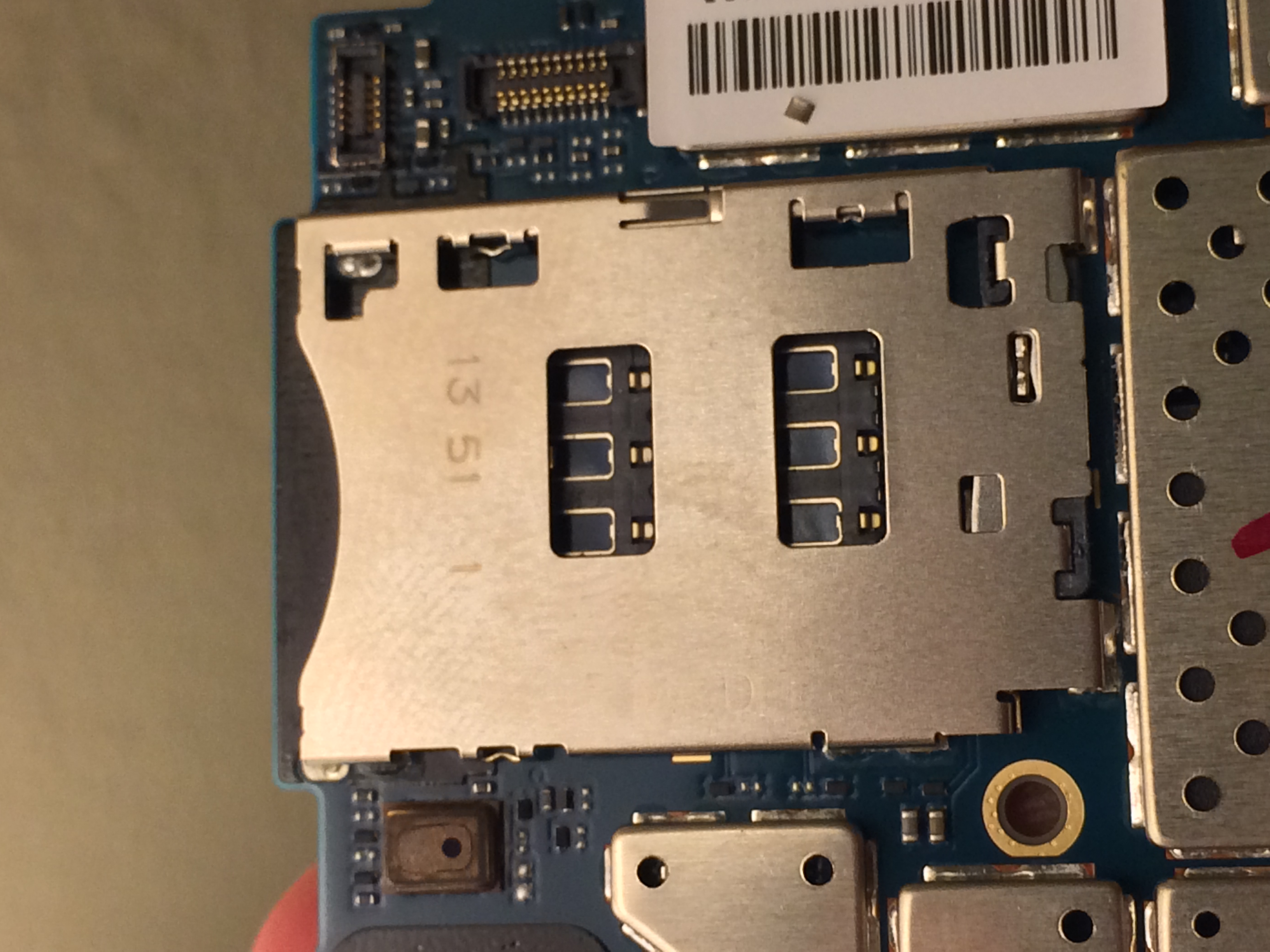

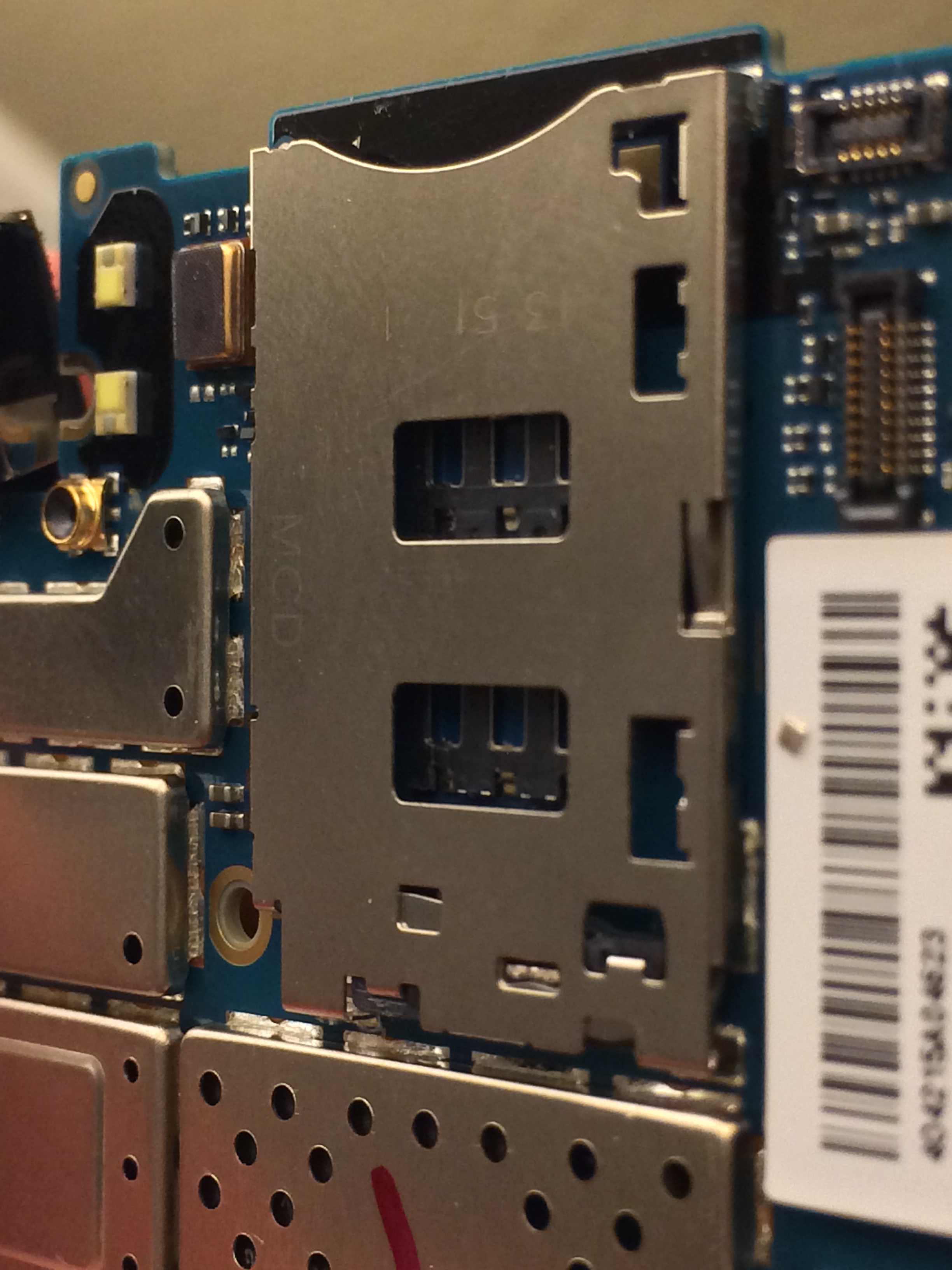

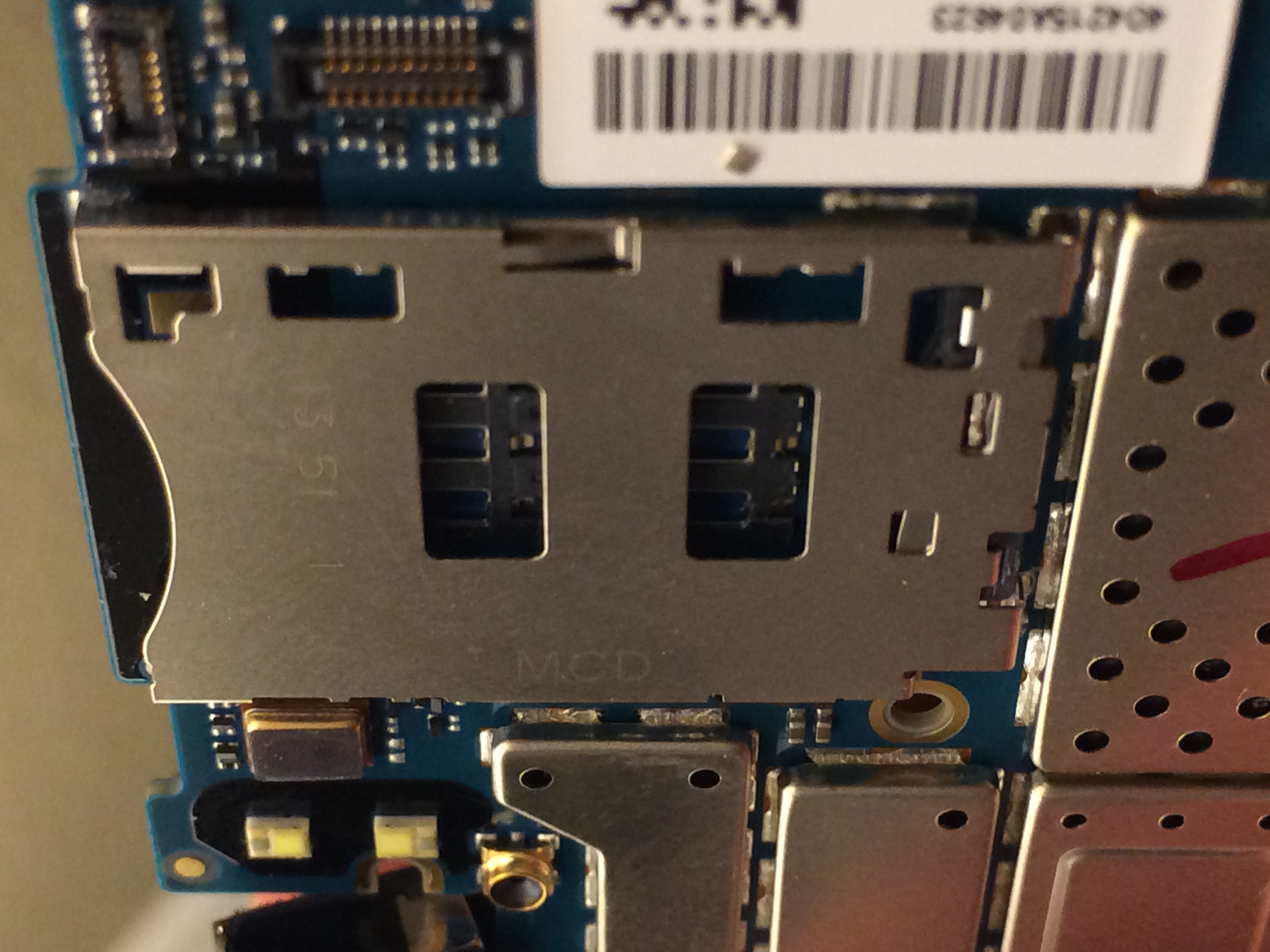

I ran into the same issue.... stupid me. Didn't realize what I just did when I threw in the empty sim converter until I tried to pull it out and got stuck. Did the whole taking apart my phone thing and it looks like I'm missing all 6 pins :(
Here are the pictures of my SIM slot with no pins :(
View attachment 7699View attachment 7701 View attachment 7702 View attachment 7703
