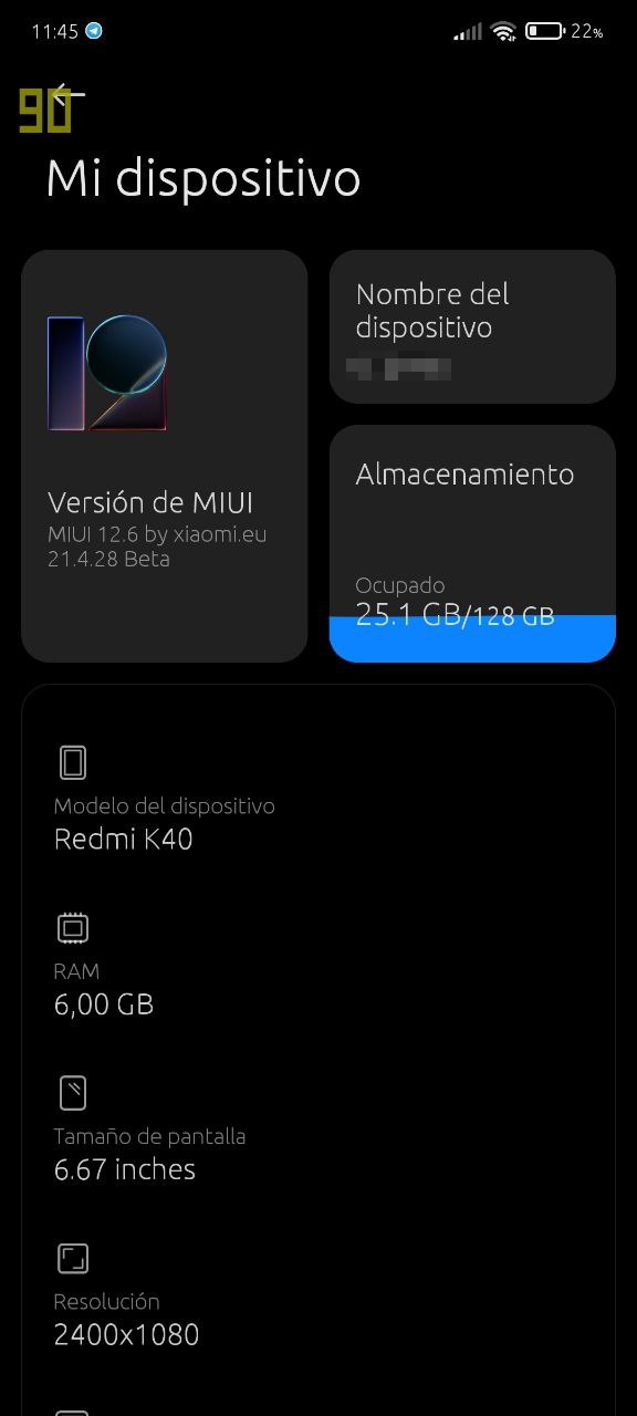

About the first point, it isn't just the text draw on the activity, it is also the value stored in the settings table...This is the method that I'm currently using and checking the "user_refresh_rate" it changes to 90 instead 60 as it did before the change, I have checked it with setedit...
About the OOB, just enlarge the array one position:
new-array v3, v1, [Ljava/lang/String;.
Or just find where the array is at and change it, the array is barebones and in plain sight on vendor partition, not hard to find :D
In any case, just curious, set 90 FPS and then go to Developer options and toggle on "Show refresh rate", what do you see on the screen?
It is 90 , but by doing the mod, it's not dynamic between 60 and 120 as it does by selecting 120hz on the display menu. I'm trying to find out if there is some value to set the max and min in dynamic mode.
Ok, I will look for the FpsList if it is defined in some XML or plain config, but I suspect that this value is inside some lib (so) or inside the boot.img.
I will continue working in the small code to provide a tested recompiled version of the misettings with that change into the possible values of FPS.The first modification that I have indicated is the one that I'm using right now, it sets on the 60hz selector the 90hz value. And as you see it works.
