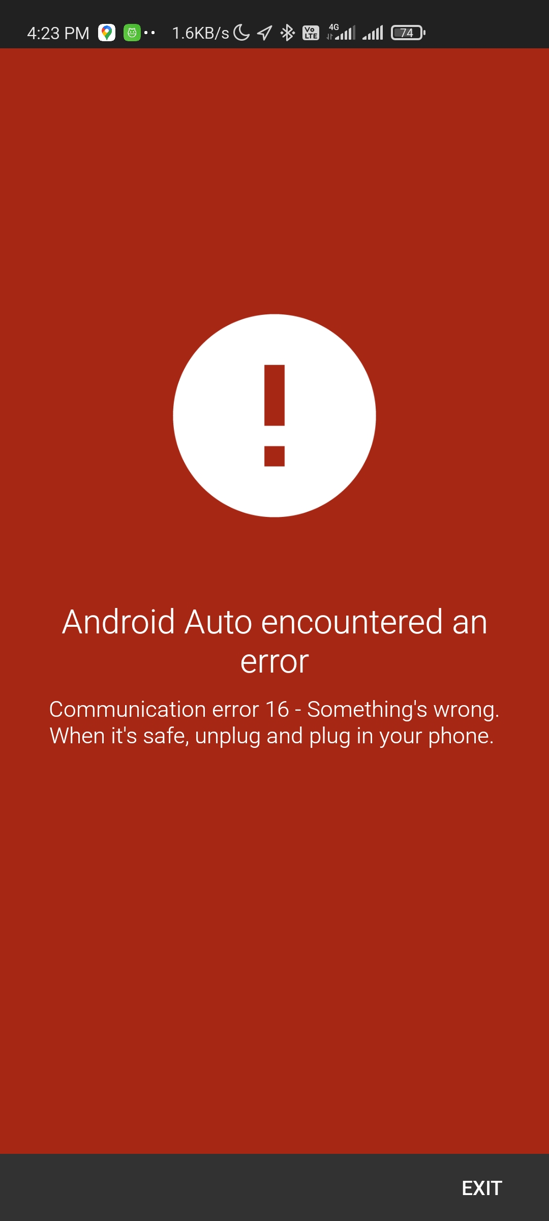

Hi, I have followed the link and downloaded the version recommended but still having the same problem. I'm on K30 5G. Thanks.
