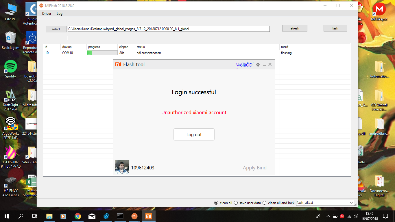

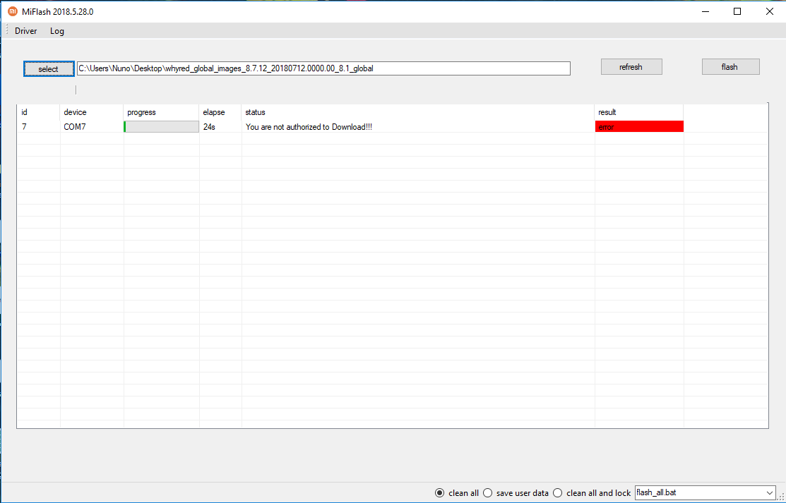

I'm waiting for them to verify my MI ID and give permission to flash it in edl mode in xiaomi flash tool. At this moment I dont have authorization to flash it back to life :(
Don't know. The phone is totally dead, no fastboot, no led, no recovery, no nothing. All happens is the phone gets recognized as a qualcom device 9008 and I need to flash it with xiaomi flash tool but This windows appears adn I ont have authorization.In russian forum they have a way to unbrick the phones. lets hope they can help. I Have sent some emails to xiaomi costumer centers but they are soo ignorante...

Since xiaomi mi flash is asking me for an authentication to flash global dev rom again, I can try to flash china dev or stable. I have seen some videos in youtube people flashing china rom without any authorization.
But I don't know where can I download the rom because phone isn't in fastboot so i cant connect it to xiaomi tolls and get the rom...
