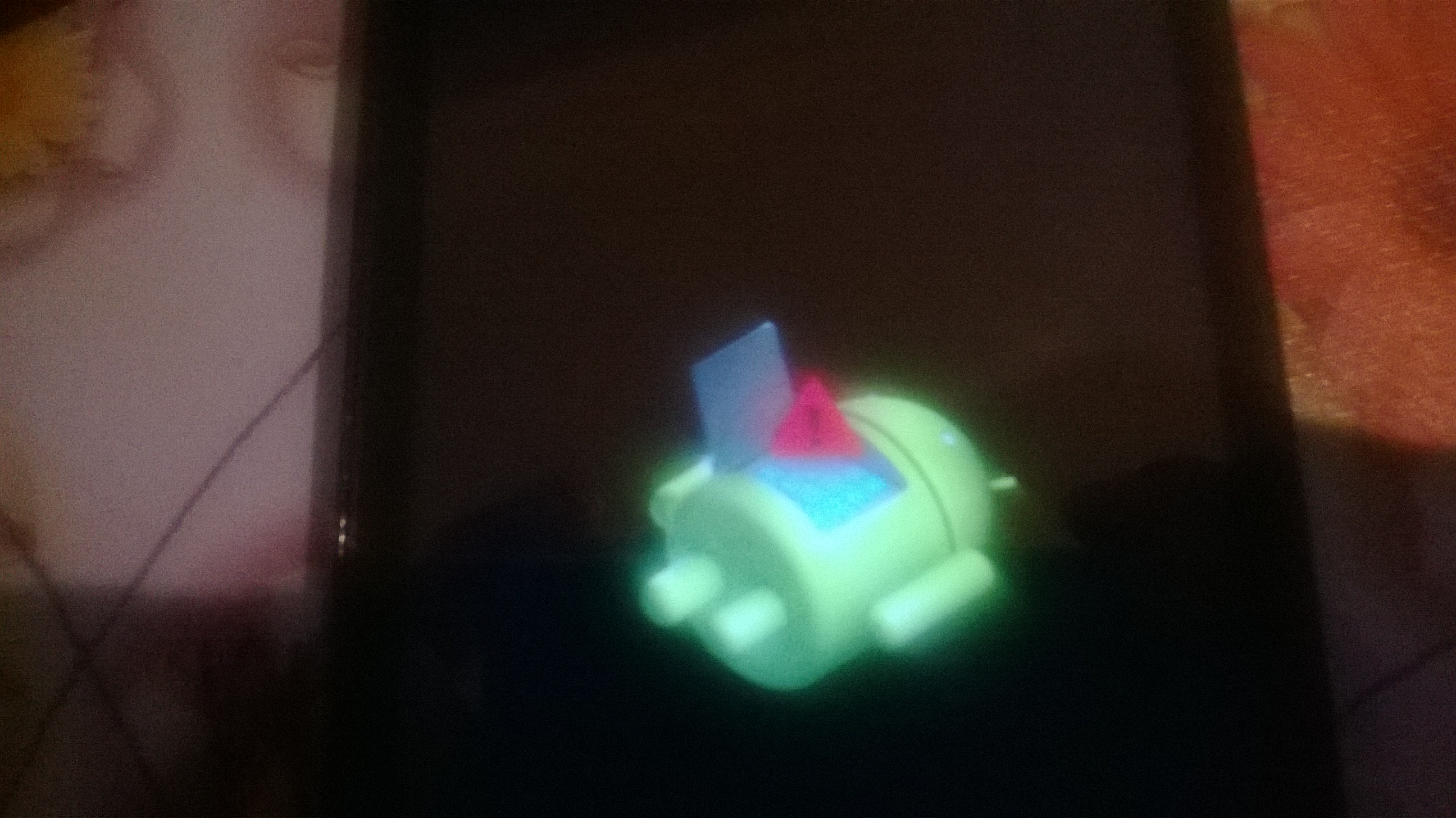

I managed to root but when i try to use "recovery update" the phone reboots and i all i see is what i have attached below.
I tried to to go Settings -> About Phone -> System Update -> Select installation pack / Download latest full ROM and flash without much luck. Has anybody experience this before and would appreciate any advise.
How did you manage to root?
I assume you use MobileUncle tools to update recovery, which is the new recovery which you want to apply?
And are you sure your HongMi is no fake? What is e.g. the screen resolution?
Yes, i used MobileUncle tool to update recovery and after reboot, i do see a error (previously attached).
Also attached the Hardware Info.
CHECKED my verification code on http://chaxun.xiaomi.com and got below message. Sounds, i got a FAKE xiaomi mobile.
Your security code is produced millet phone code official
Security code your query has been queries over 7897 times
Is there any other i can flash ROM or upgrade? Any help is most appreciated.
