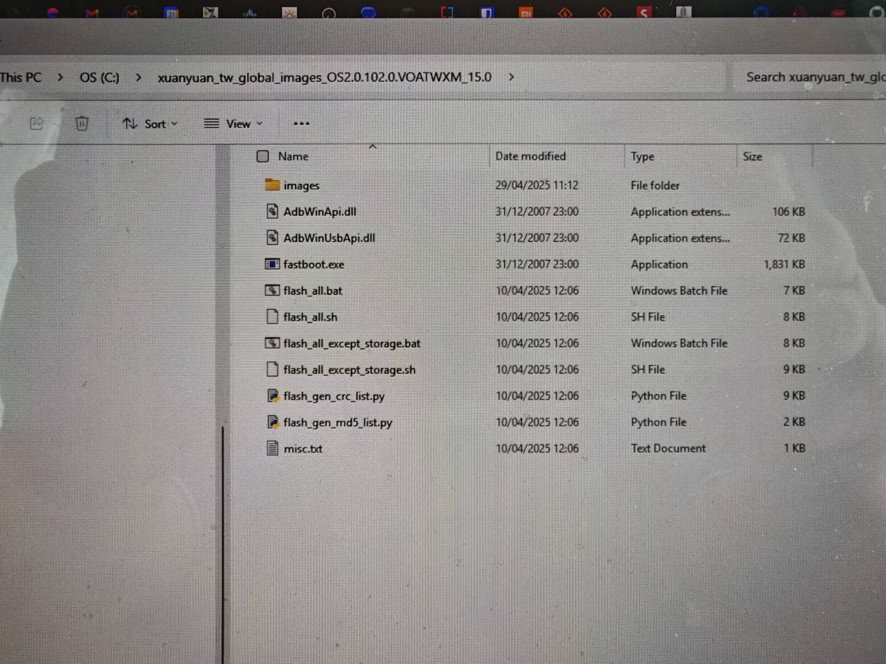

Last time I got in to this position, I downloaded original (your area )global. Extracted down the files to a folder in the C:\ folder on pc and copy the 3 adb files needed ( AdbWinApi.dll,AdbWinUsbApi.dll,Fastboot.exe, you can get them from an old EU ROM folder) in to it and the images folder, then run the CMD command in the extracted folder while in fastboot, Flash_all.bat or except_storage.bat

No, I didn't, but I can try it later today. Though there is no error in MiFlash logs and also xiaomi.eu is doing it like you mentioned, flashed them like this several time. Only original rom is flashed by MiFlash

Did you try fastboot flash using the bat file and adding those three files from the EU ROMs bin folder to the images and root folder of the ROM like I posted?
Yes I also did it as you suggested, it's flashing all successfully, doesn't finish really quick, its taking time as you would normally copy files of that size to the phone, Its flashing all that is in flash_all.bat. But hangs at mi logo, does not restart or anything, it stays like this until battery is empty... This seems like bricked to me, I also did flashed EDL successfully and this didn't fix it so I don't know what to do anymore.
