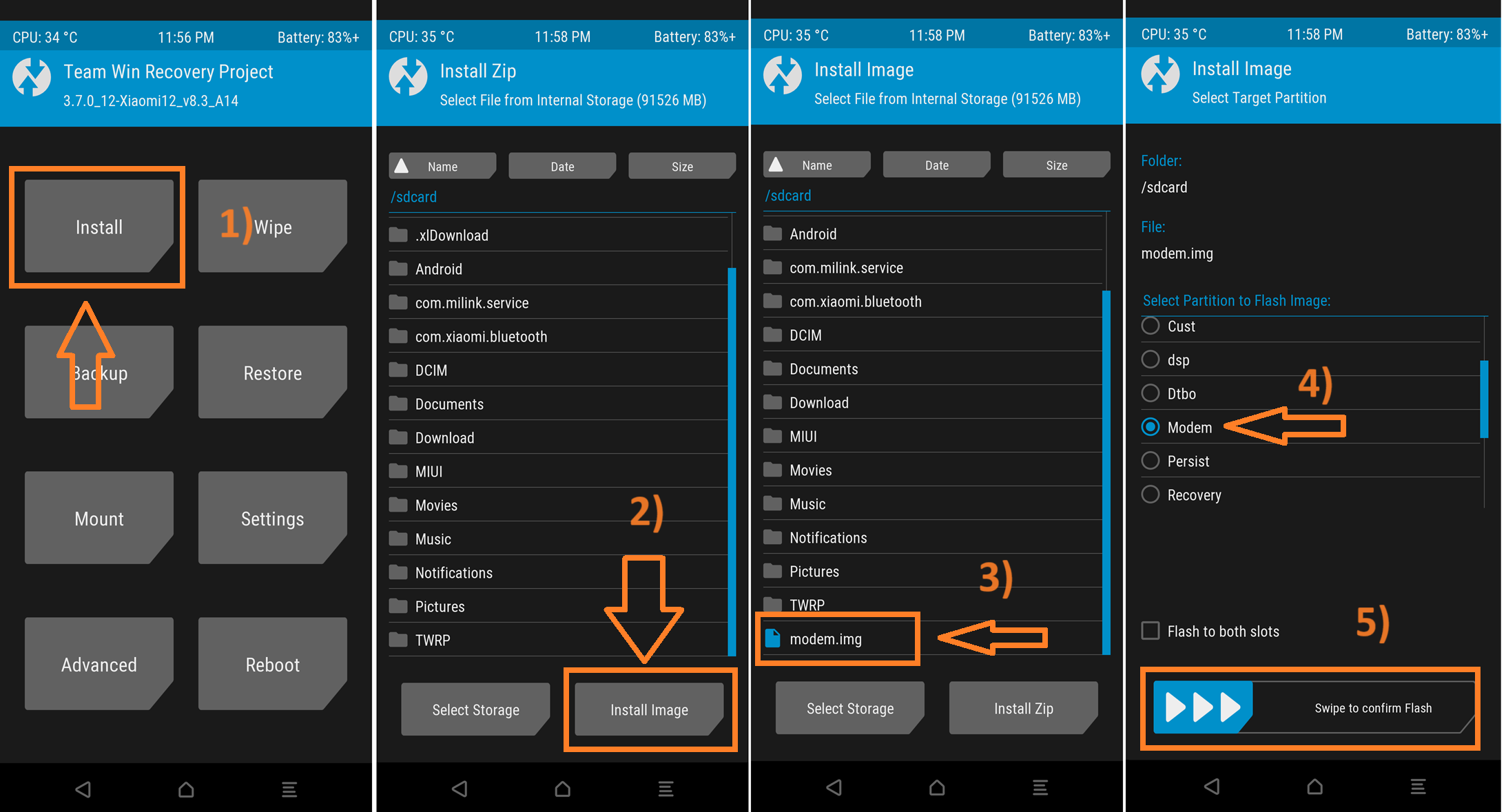

I don't have access to a computer in a few days, is there anyway to do it just with the phone? I'm Rooted in case this helps.
Thank you
If you use USB-OTG you can install the modem.img file in TWRP.
This should fix your camera.
In the future, do not use the modem to repair the network, but only "modemfirmware.img..
