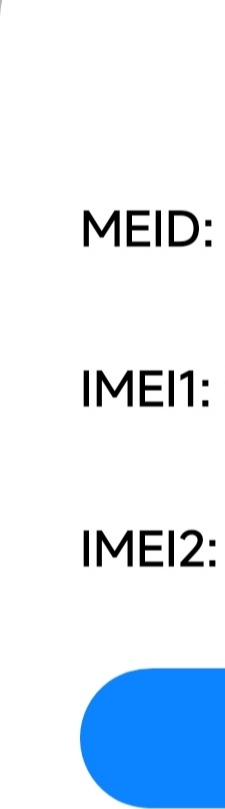

Redmi K50 Ultra users, open the Phone app and type *#06#. Write here which types of identifiers you see in the dialog that pops up (don't write the numbers here, just the types, i.e. MEID, IMEI1, IMEI2, EID, etc.).
MEID, IMEI1, IMEI2

MEID, IMEI1, IMEI2
Then yes, definitely looks like Redmi K50 Ultra lacks the required hardware for eSIM support.

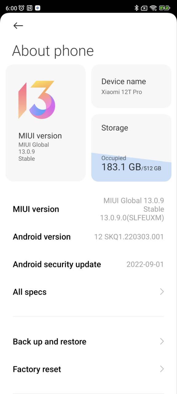

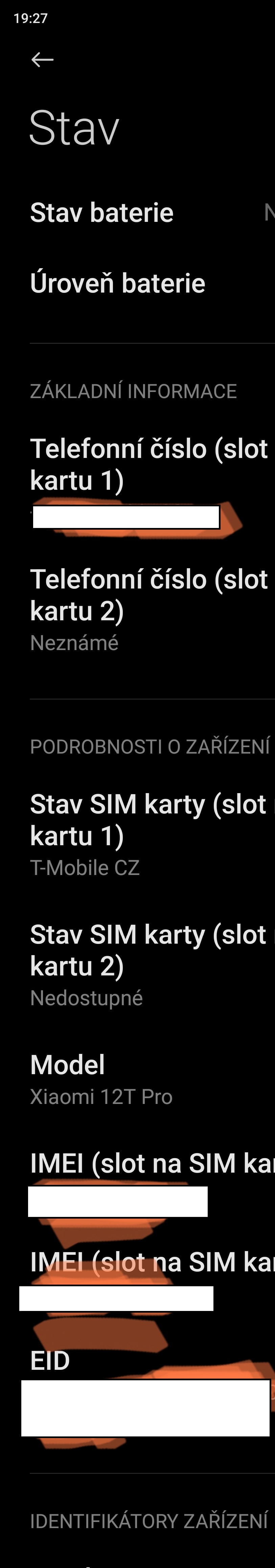

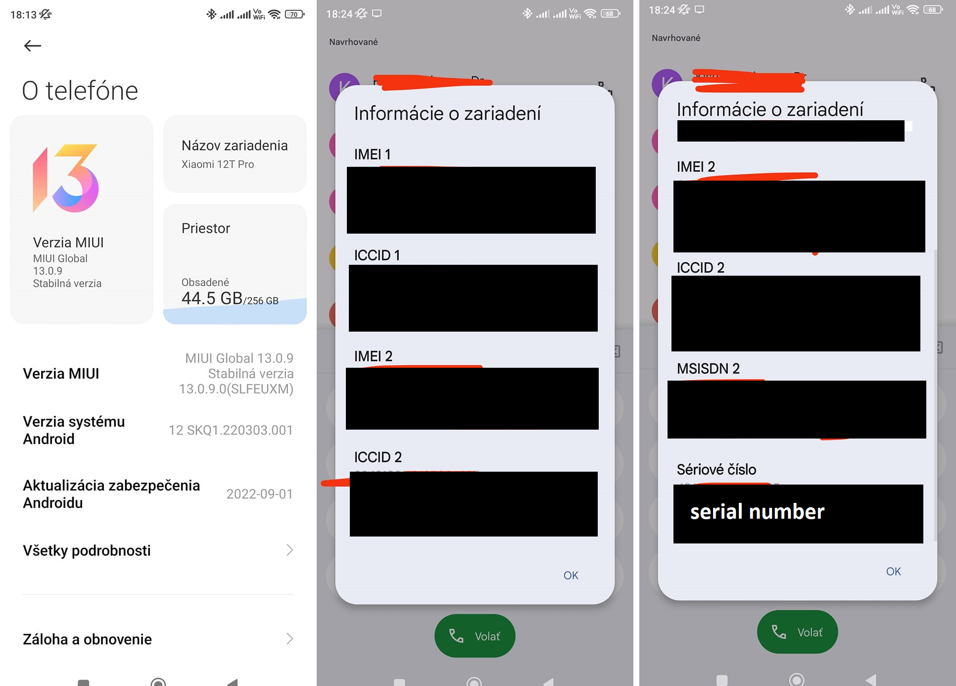

Can a Xiaomi 12T Pro user do the same procedure to verify that "EID" is available on their device?

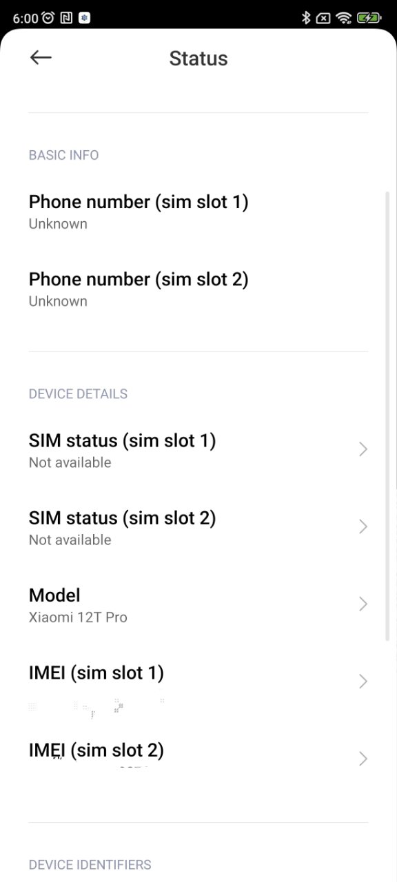

How about Settings -> My device/About phone -> All specs -> Status?
If there are only "SIM status (sim slot 1/2)" and "IMEI (sim slot 1/2)", would be interesting to see the titles under each of their detail dialogs (accessed by tapping them).
It is in the EID settings.
Excellent. "EID" being there confirms the eSIM hardware.

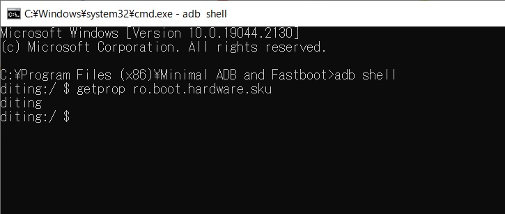

Can you run this command with ADB shell or a terminal emulator?
Code:
getprop ro.boot.hardware.sku

Can you check Settings -> My device/About phone -> All specs -> Status as well?
Redmi K50 Ultra 12/512 ROM Global

Those screenshots confirm that Redmi K50 Ultra does not have an EID, and thus no eSIM capability. If we make a China ROM-based shared ROM for both Global and China models, we'll have to separate the eSIM feature to be exposed on the Global model only.
Value "diting" for ro.boot.hardware.sku on Redmi K50 Ultra is expected and known, what interests us is the value for Xiaomi 12T Pro (it can be either "diting" or "ditingp"), so we're only waiting for @gogocar62 or any other Xiaomi 12T Pro user to check "getprop ro.boot.hardware.sku" on their device, then we'll know how we should continue.
in all rom files Global or EAA codenamed flash commit and ''diting''
That was not the question. It is already obvious that the device name is "diting" for both, the question is about the SKU of the hardware, which can be read from the ro.boot.hardware.sku prop. That prop is set by the bootloader according to actual hardware, it's hardcoded into the device and is not part of any ROM.
