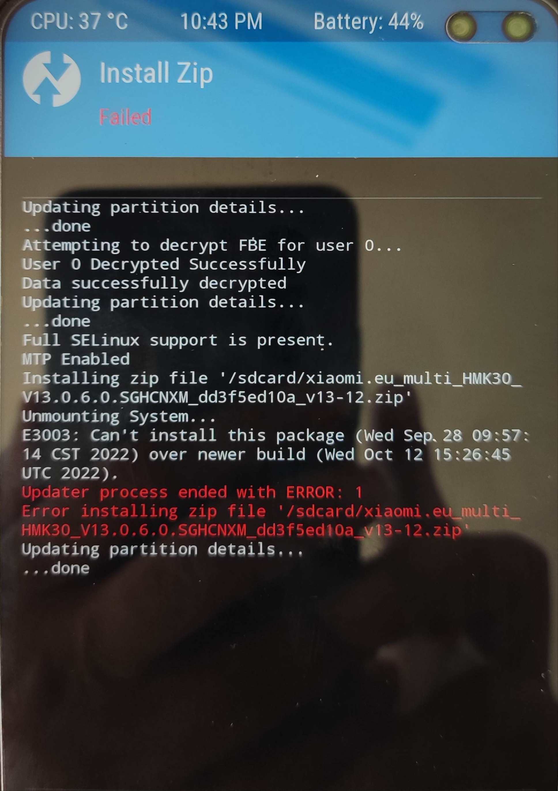

My phone is redmi K304g and Recovery is twrp-3.7.0_12-1-phoenix.img. There was an error when I flashed the xiaomi.eu_multi_HMK30_V13.0.6.0.SGHCNXM_v13-12.zip of this community, and it could not be completed.

The mobile phone installation system is now xiaomi.eu_multi_HMK30_V13.0.3.0.SGHCNXM_v13-12-fastboot.zip.

I have carefully read the article you provided and feel that there is nothing wrong with my operation.
I have tried several times to reboot from twrp to twrp and flash the ROM, but the error is still displayed.
Now I think maybe my twrp version doesn't match, but I didn't find k40(4g) twrp in the article you provided, only found k40pro and k40s versions, I don't know if they are suitable for my device, so I didn't dare refresh.

there is a workaround.. nothing to do with reboot. if you dont want to read… please dont spam. I only want to help you.,.

According to your instructions, I found the same problem as me in the lower part of the article, I deleted a line of characters in the script in the ROM, and now the problem is solved.
