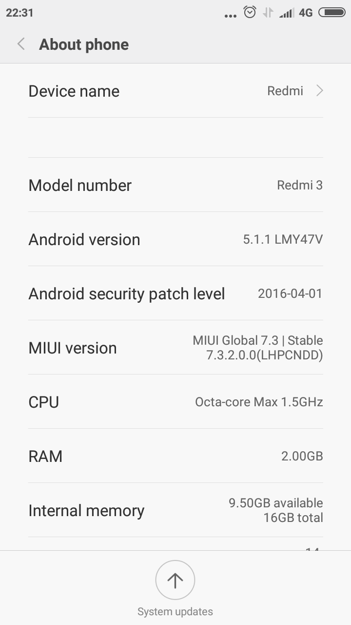

Hi, I have a Redmi 3 with a fake 7.3.2 global stable rom. I cannot unlock bootloader and I also cannot flash any roms even in download mode.
When I try to flash china developer rom miflash just hangs at the start and the status bar says device busy. Nothing happens and when I unplug the phone it just boots back to old rom.
Please help. I have tried every tip I could find, but nothing works.
