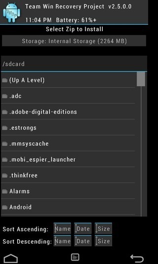

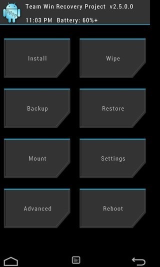

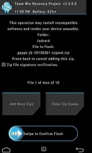

Boot on Twrp Recovery, tap on install, choose downloaded zip file, swipe to confirm flash
