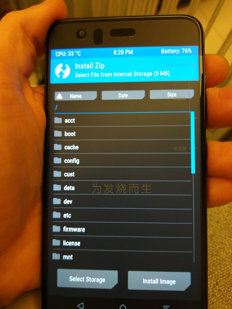

I have install TWRP 3.2.1.0 and when trying to install from TWRP, I cannot see the data folder, but just some system folder...
Therefore cannot choose my zip file to install ;(

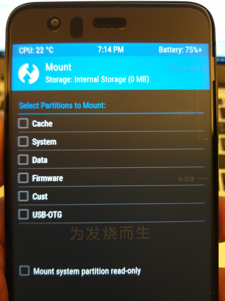

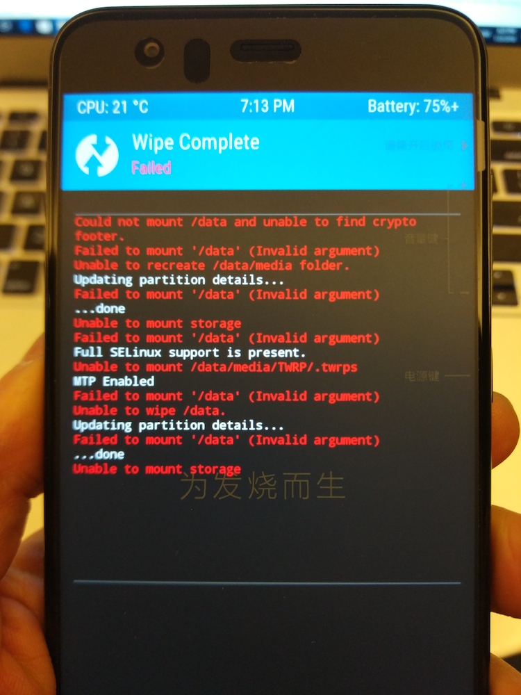

So I tried to follow your instructions but wasnt able to do the DATA format.
The reason is that the DATA partition is not mounted (for some reason).
I tried to mount it in TWRP, but the system wouldnt allow me to do that :(
Here as the screenshot of what I am talking about:
Wipe fail:

Mount data not enabled:

I have finally solved the issue; The problem was indeed the encrypted part that seems to come with the new MI ROM 8.0 preventing TWRP to mount the DATA partition.
You will need to remove that encryption and here is how to do that:
- Go into fastboot and enter following command: fastboot format userdata (be careful, you loose all your data)
