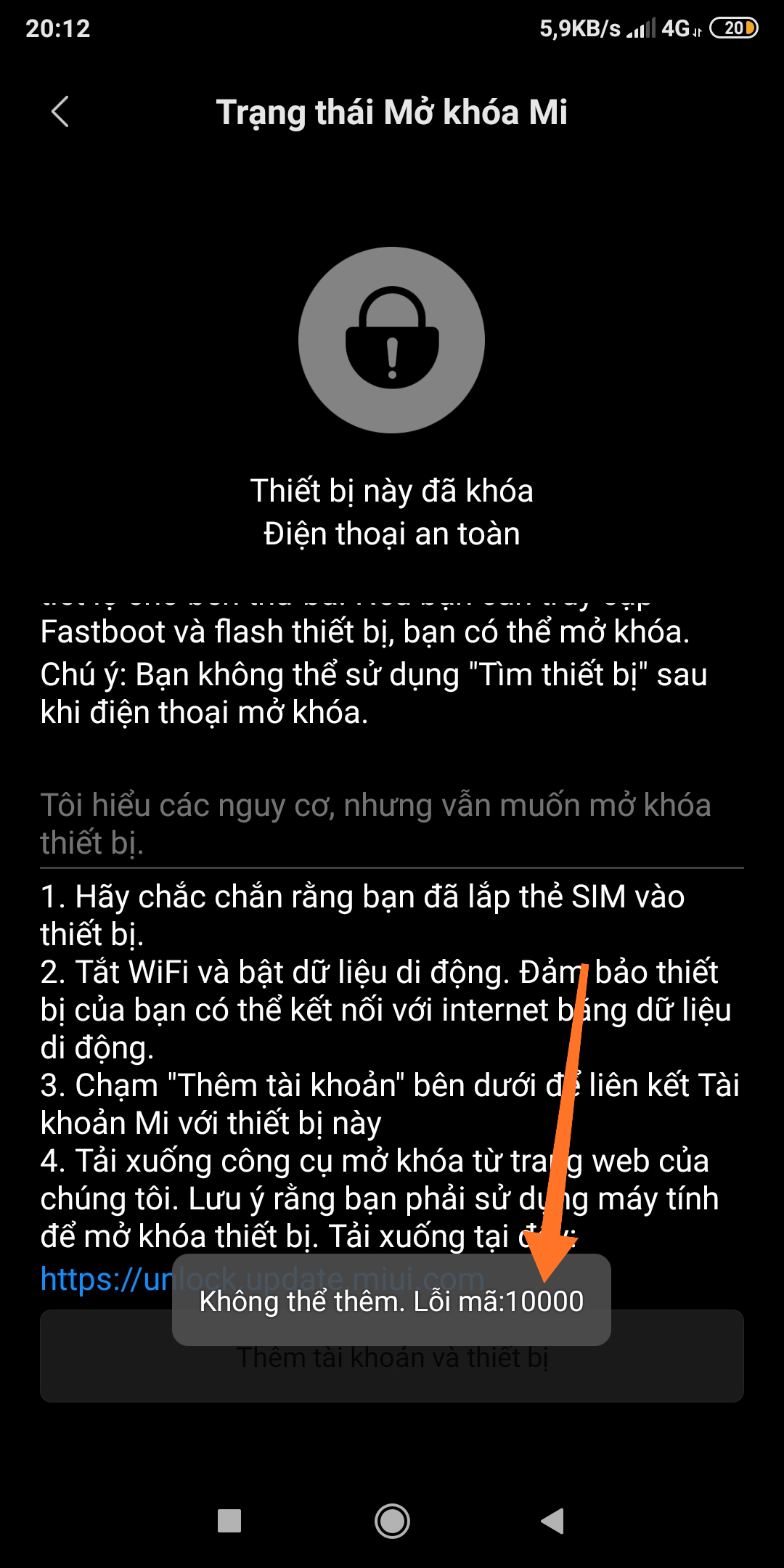

Tôi gặp vấn đề tương tự ở mix 2 global và mix 2s global của mình
the problem is presented to all of us T-holders dissociate the miaccount from the phone then go into the developer options and from there the miacocunt associates it to the phone. you will see that after a couple of attempts it will work and at that point you go to unlock me
