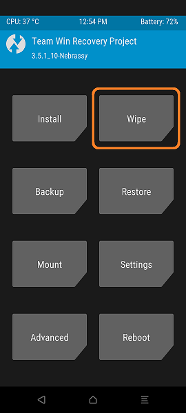

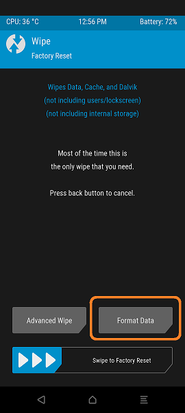

No wipe
1. instal ROM
2. Format Data - yes
3. reboot system

No wipe
1. instal ROM
3. reboot system

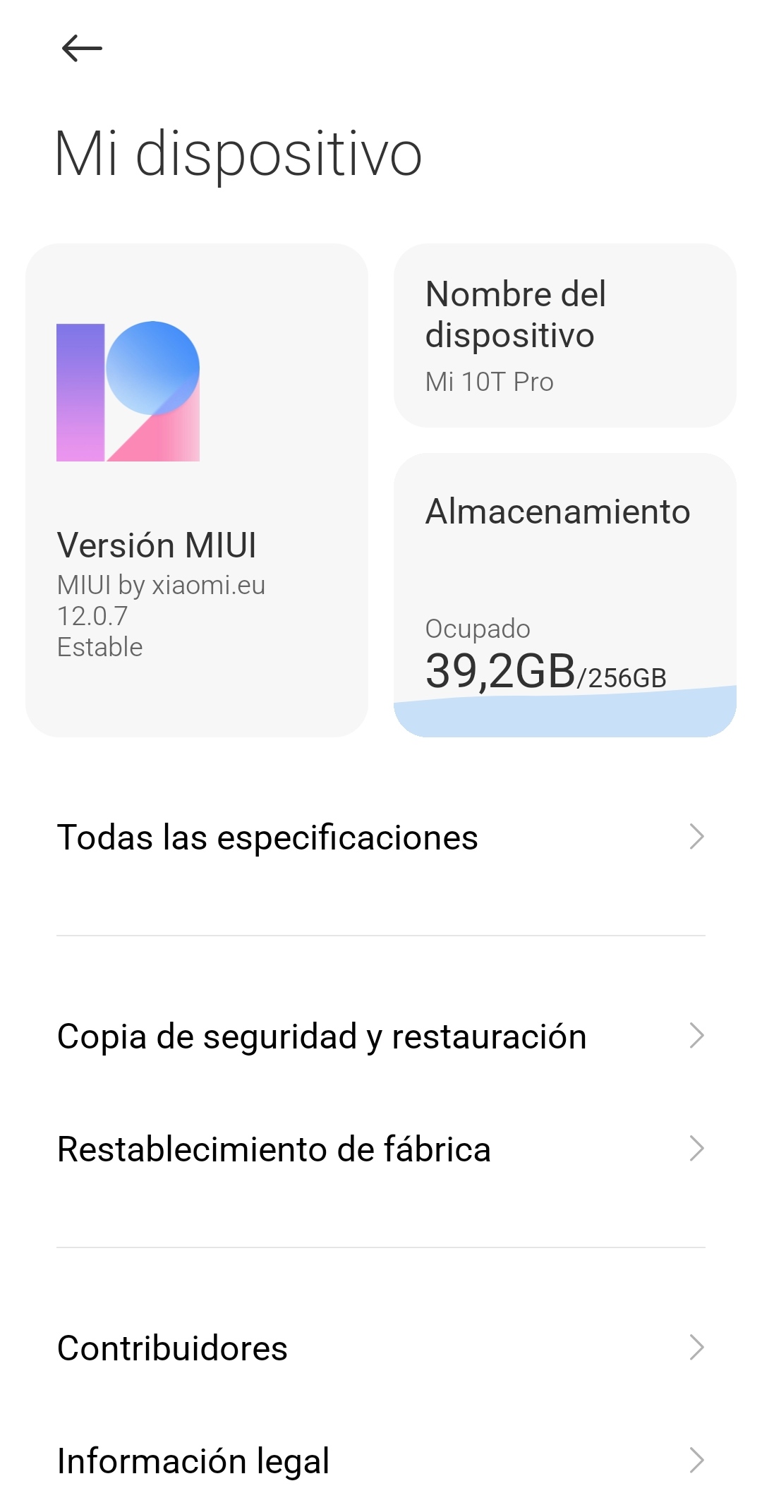

Thanks for the help but it does not work, I have tried and it does not boot the phone, it returns to the TWRP screen
" Android Rescue Party trigger! Possible solutions? Either:
1. Wipe caches, and/or
2. Format data, and or
3. Clean-flash your ROM.

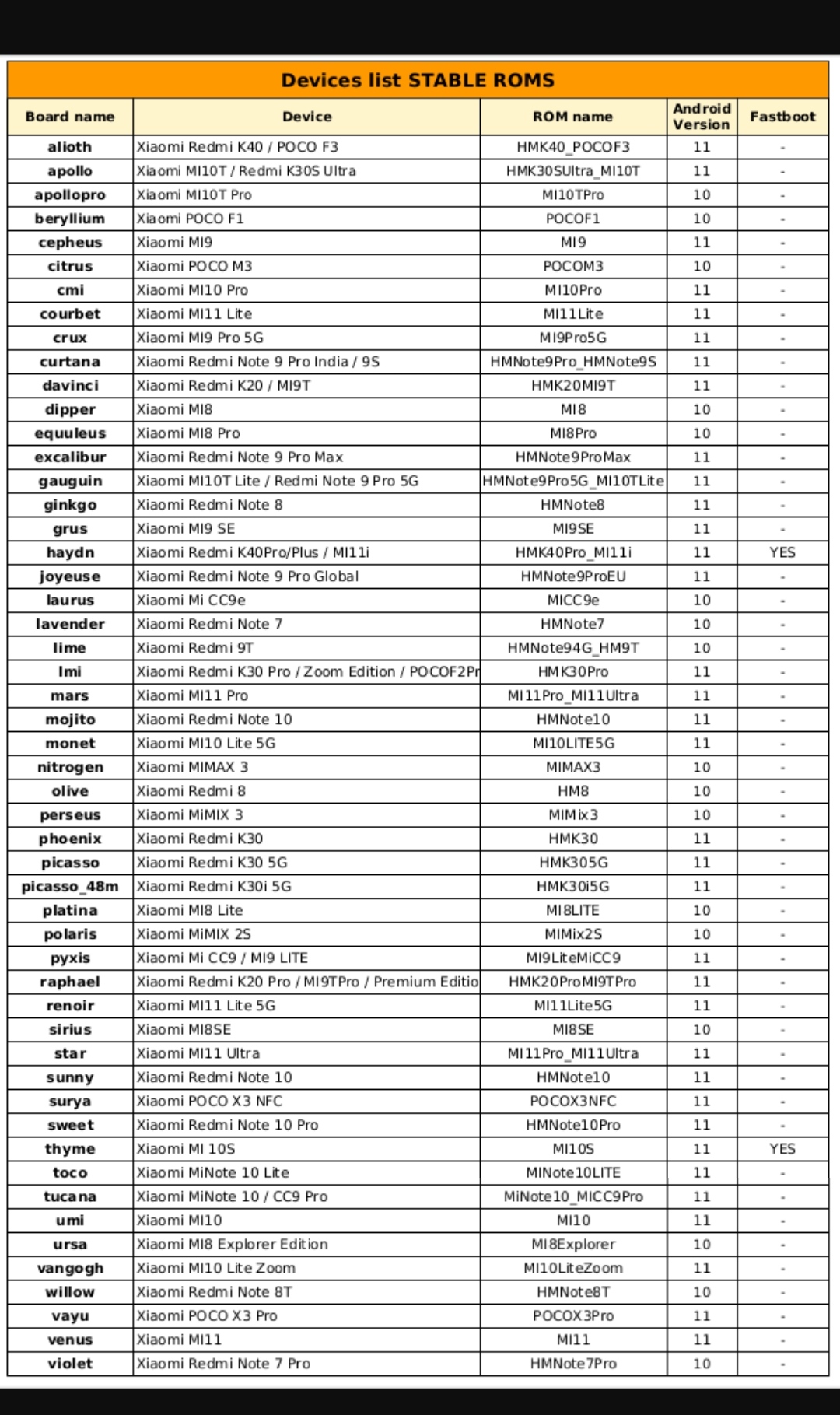

Not any but all recent ROMs (< 6 months) for Mi 10T are working on Mi 10T Pro. ;)
I just tried to install it but it does not enter the recovery that I installed yesterday, the recovery image jumps but it does not enter and boots the phone with the current ROM :oops::(:(:mad::mad::mad:
